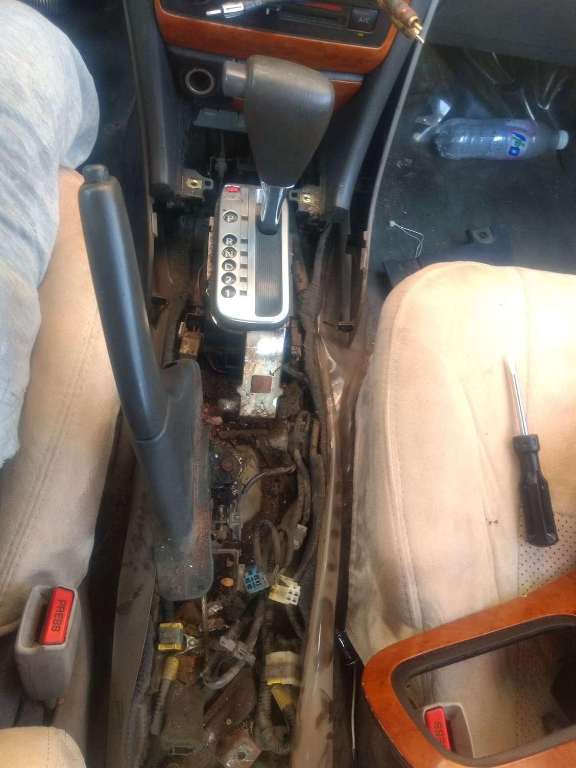

Took off the handrest and everything it's pretty dirty

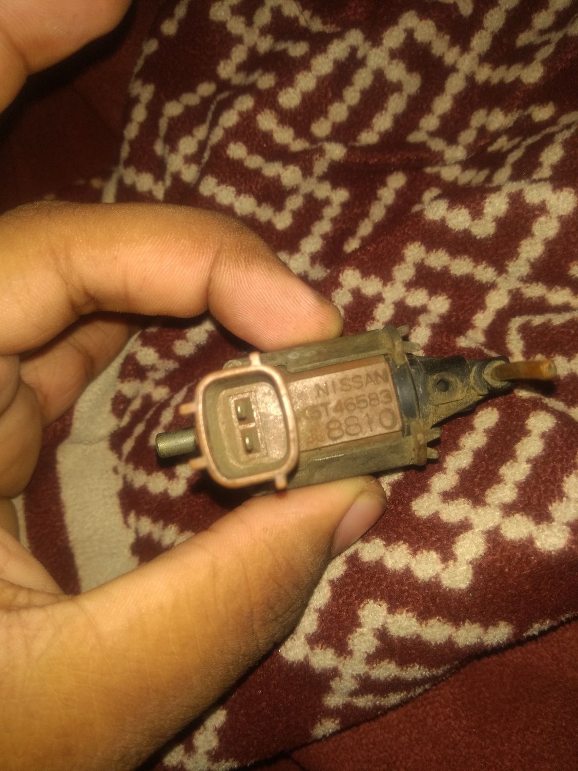

I saw these weren't connected anyone know what these are?

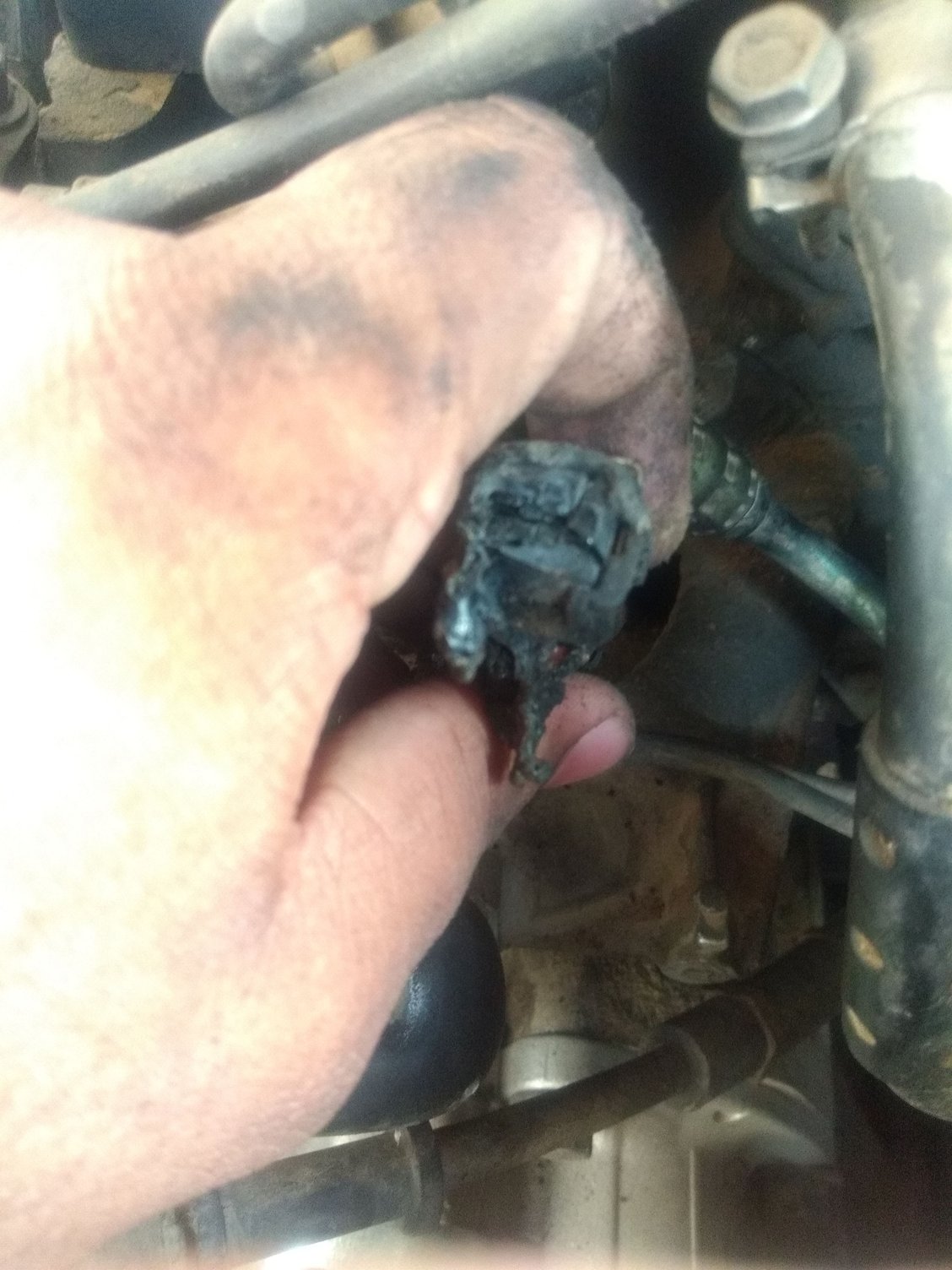

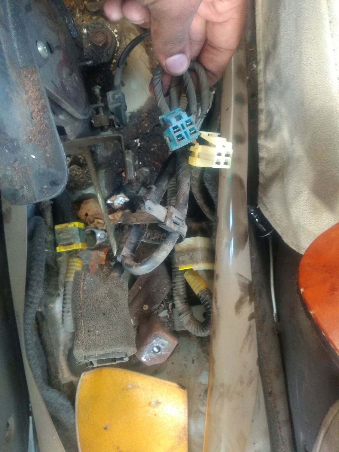

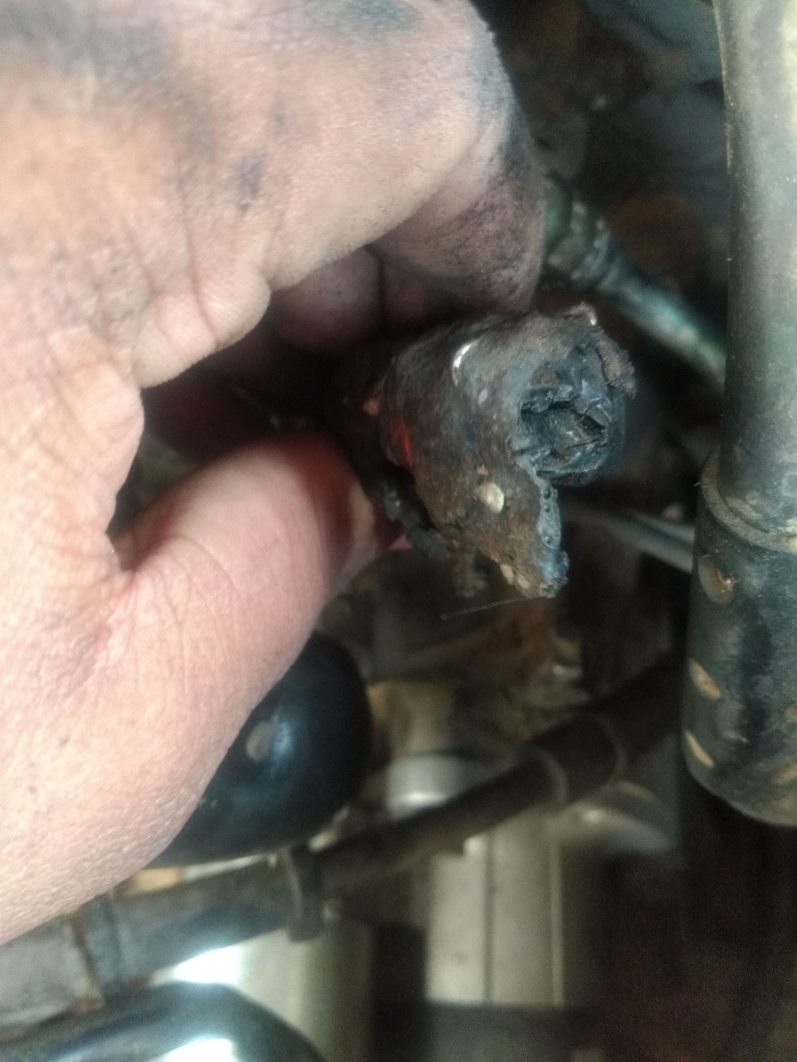

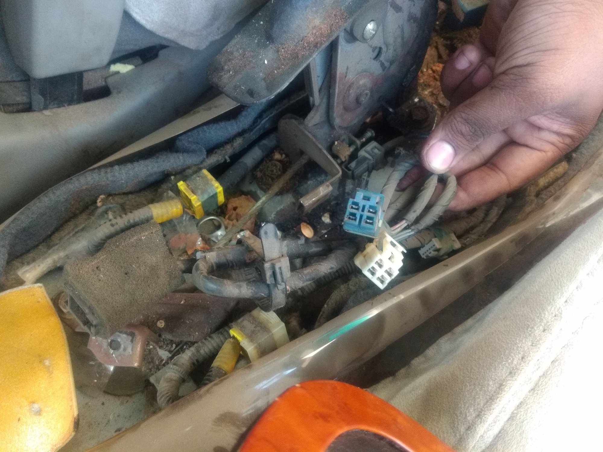

I was taking stuff apart to take a look at the PNP and the knock sensor. Here's what I've found so far.
This I found under the airbox don't know whether it's a ground or positive. The wire seems to be red. There's a big fuse there. Please let me know what it is
This was disconnected dk how I never noticed can't seem to find a plug that connects to it. I took it off to show you guys what it looks like.
I tried searching up the part no. to no avail.
That's the connector to the knock sensor.
God knows how or what happened to it but holy ****, I have no idea what it could mean.

All I see is a big mess. That red wire with the inline fuse means some morons were in there hacking up the electrical for an aftermarket stereo. All bets are off now. Hope you get it sorted.

i'm sorry but pictures can't really gives an idea of what is supposed to be working or not, we need voltage data and verifying checking power and grounds. You can also check continuity between 2 points. Get a DVOM , even a mid priced one will work .
You can get them from Lowes or Home Depot for cheap ( a decent one will be around $20-$40 ) , and you won't just use it once, you will use it multiple times .
Also DL the FSM from NICOCLUB so you can check power & ground at the DLC, the PCM and the wiring harness.
Verifying if your problem is in the wiring harness, the component itself or the ground side will tell you what needs to be replaced .

Hey guys so I opened up the tcm the 880 chip had one broken connection. So I just went to the junkyard and found myself another TCM same model and everything. Now my gear is shifting so I guess my hunch was right. Thanks for all your help though.
Old Sep 14, 2020 | 09:09 PM
Child_uv_KoRn's Avatar
Bad *** Newb
Posts: 4,975
Wonder if alternator blew it up.
