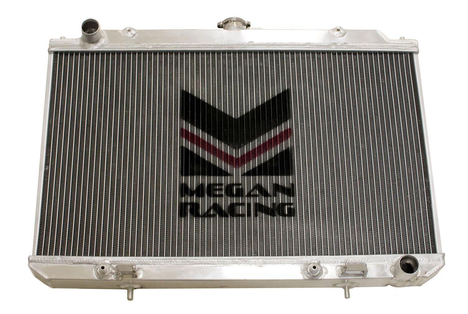

Megan Racing Radiator
Old Apr 12, 2021 | 03:29 PM
SquidBeak's Avatar
Joined: Jan 2002
Posts: 235
The top of my radiator just cracked. I plastic welded it and it's holding for now, but I really should replace it.
Has anyone installed one of these in their 5.5?
Megan Racing MR-RT-NM00
They can be had for around $150. It seems like this would be much better than any of the plastic-capped aftermarket radiators out there.
I called Megan and they couldn't tell me whether or not it would work with the stock fan shroud. They said it might not because this is thicker than the stock radiator. This is my main concern. Does anyone know if the stock shroud will fit?
Any other input on this rad?
Thanks

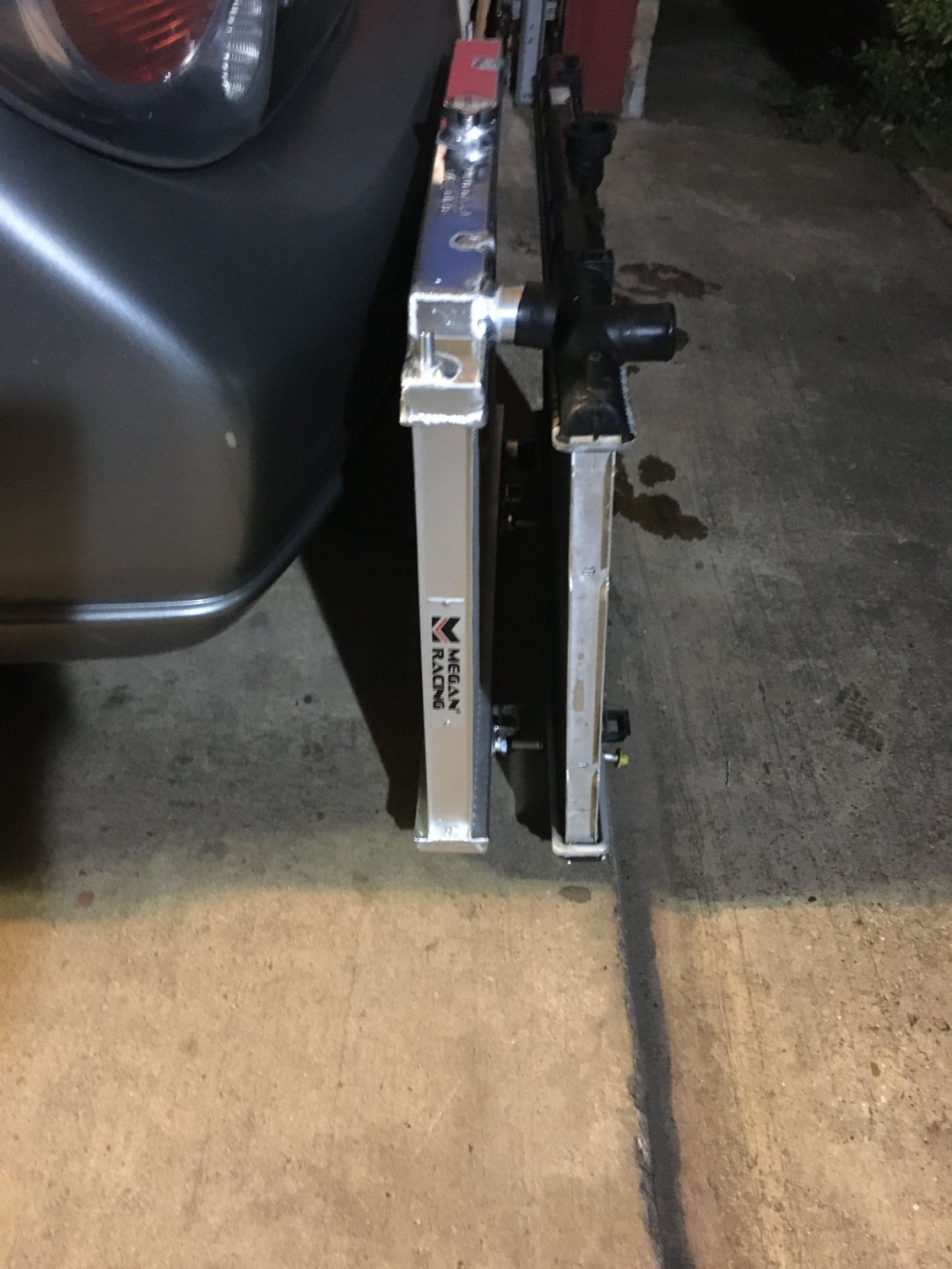

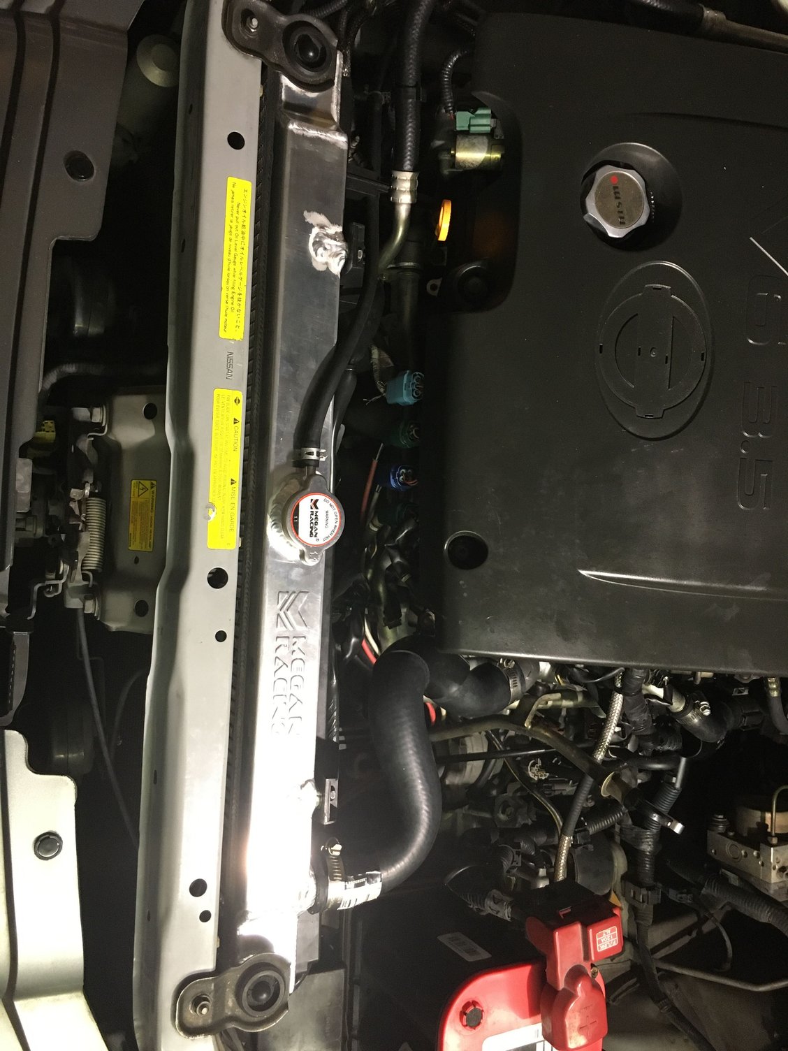

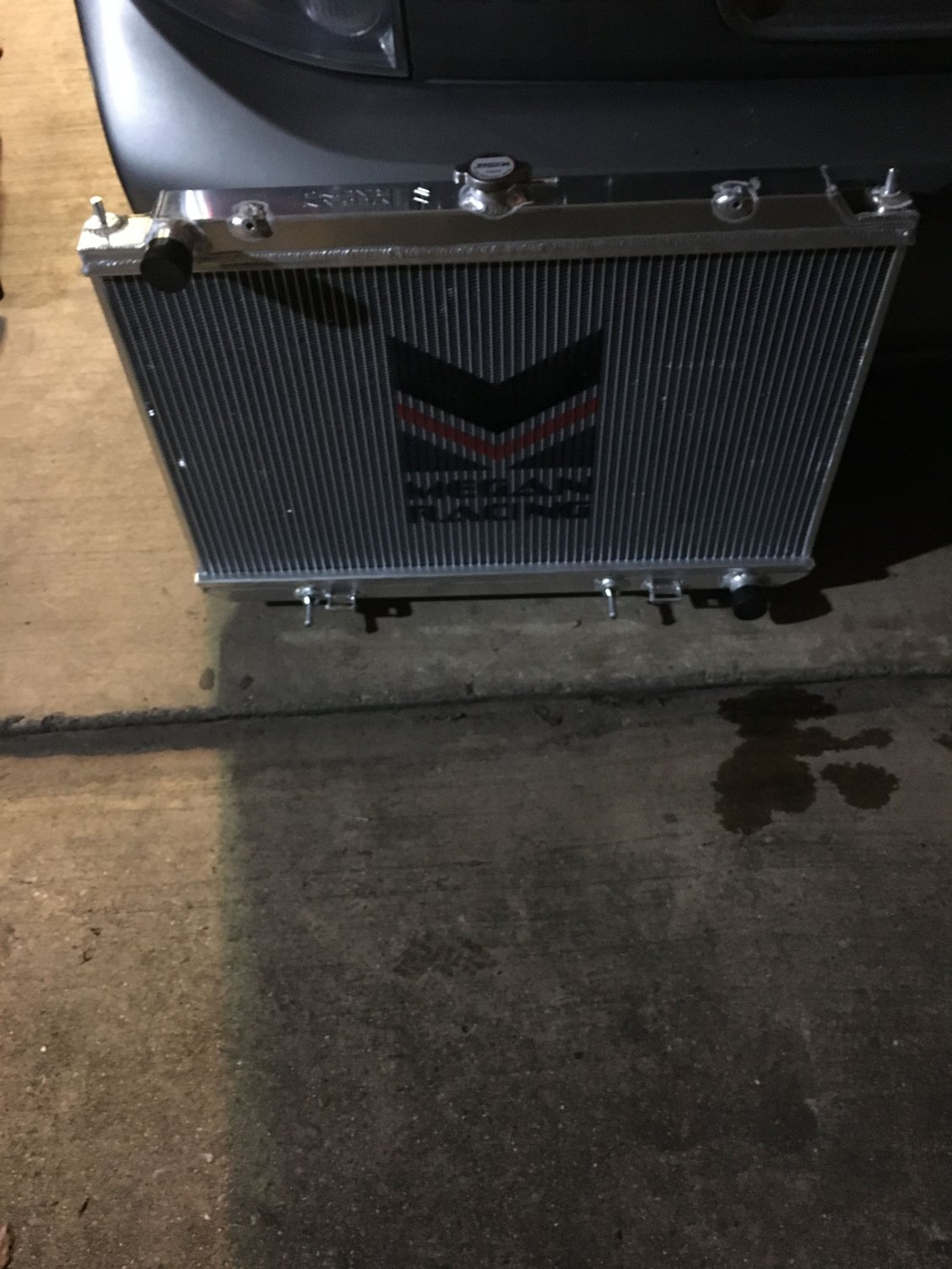

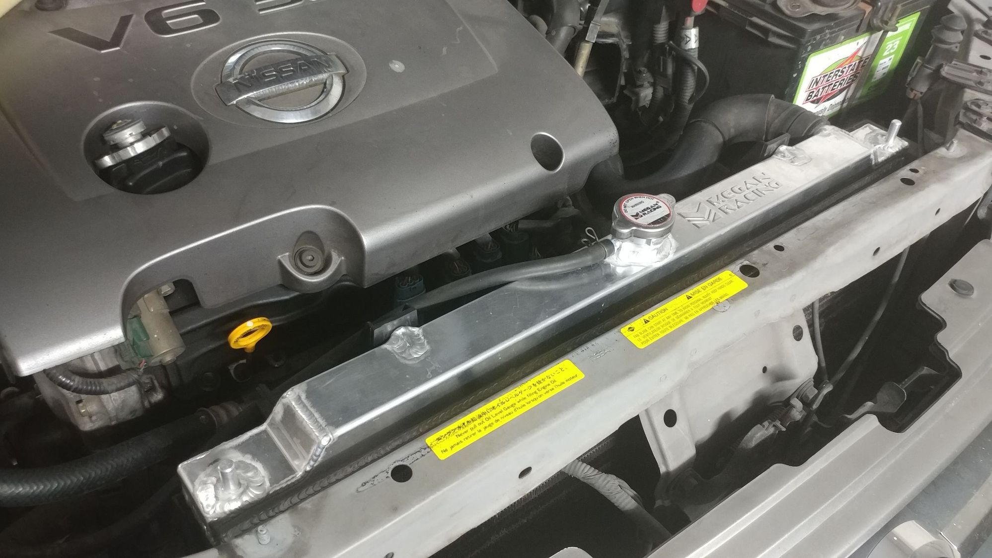

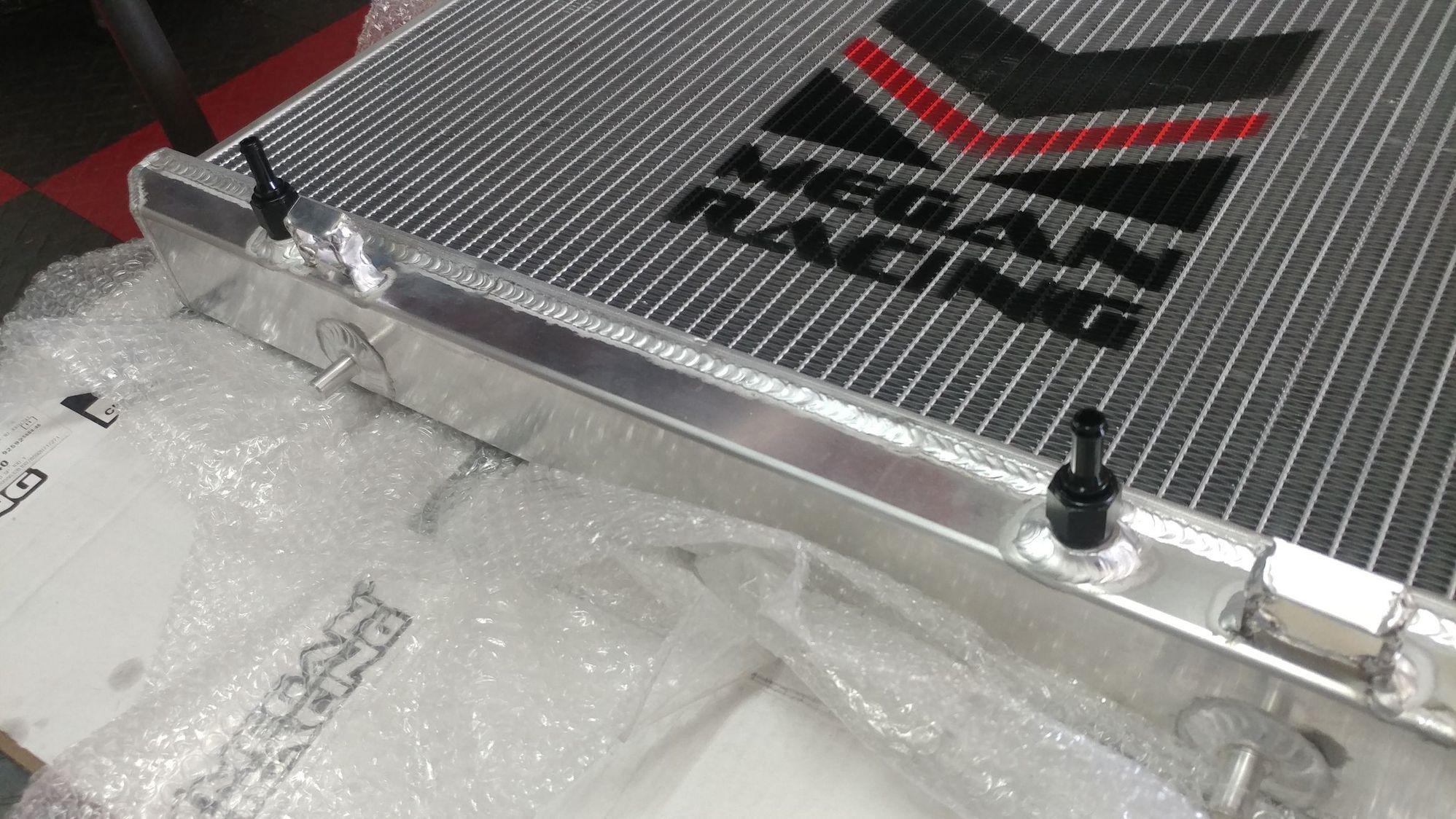

I’ve installed the Megan Racing Radiator and I love it! It’s 1-7/16” thick core versus the OEM 1” thick core. No drain! So what, it has a lower radiator hose. Everything fit the only minor issue is the upper support pegs are slightly lower than OEM & the filler cap is slightly to the right causing the overflow hose to have a little less slack. That’s it fan shroud is closer to my Cattman Headers but they’re ceramic coated so and they don’t really radiate that much heat so applying some of that thermal barrier tape might be a good idea. Function tested it and it works great!
Megan Racing Radiator top view installed.
Megan Racing Side view installed.
frontal view with oil cooler nipples installed.
Side by side view with OEM radiator.

Looks great! I would recommend buying the factory Nissan hose clamps. They expand and contract with heat. I used the T-nut type the first time when I installed my Mishimoto and right away had a small leak at the thermostat connection right above the alternator. Tightening didn't help. May have just been my luck, you may be ok. Factory clamps been holding up ever since.
Old Jun 1, 2021 | 06:56 AM
CMax03's Avatar
Posts: 9,587
From: Houston, Tx
That’s suggestive...SS worn clamps since I bought this car off the showroom floor! Especially after my first coolant flush! American worm clamps are easier but the flexing with the expanding and contracting may be true? The heater hoses expand and contract with their steel pipes as well maybe not as much Aluminum. Thanks for heads up I’ll keep an eye on it.

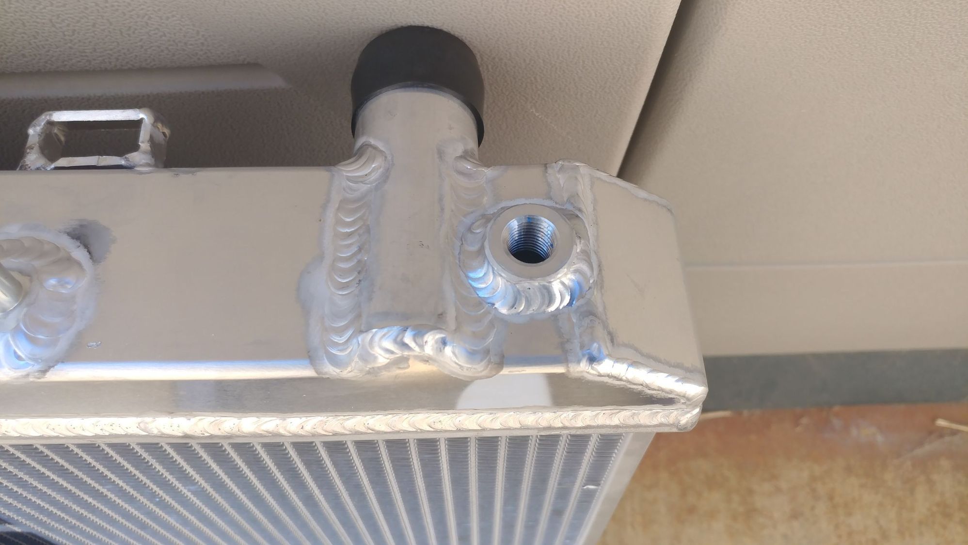

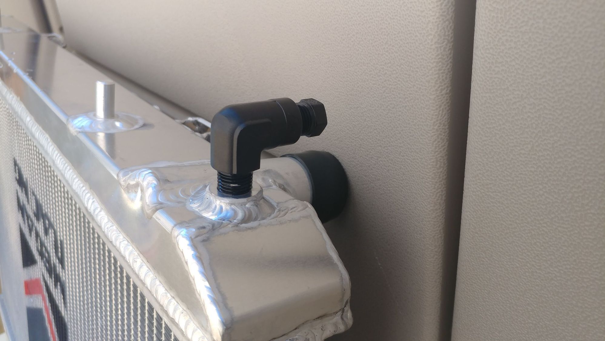

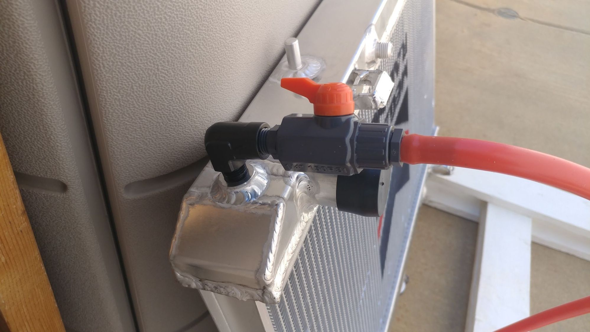

I know it's overkill, but I really wanted a drain plug. So I bought a bung, drilled the bottom of the radiator then had a local guy weld it in. Then I got an aluminum elbow, plug and a pvc valve for draining. Now, it's pretty slick. I'm going to do the install this week.
I did a test to see how everything would work this afternoon and I think it's going to be nice. I was surprised to see that the Megan radiator only holds 1 gallon. I thought it would hold more. I think the original radiator only holds about a gallon also, but I'm not positive about that.
I'll post some pics when it's done.

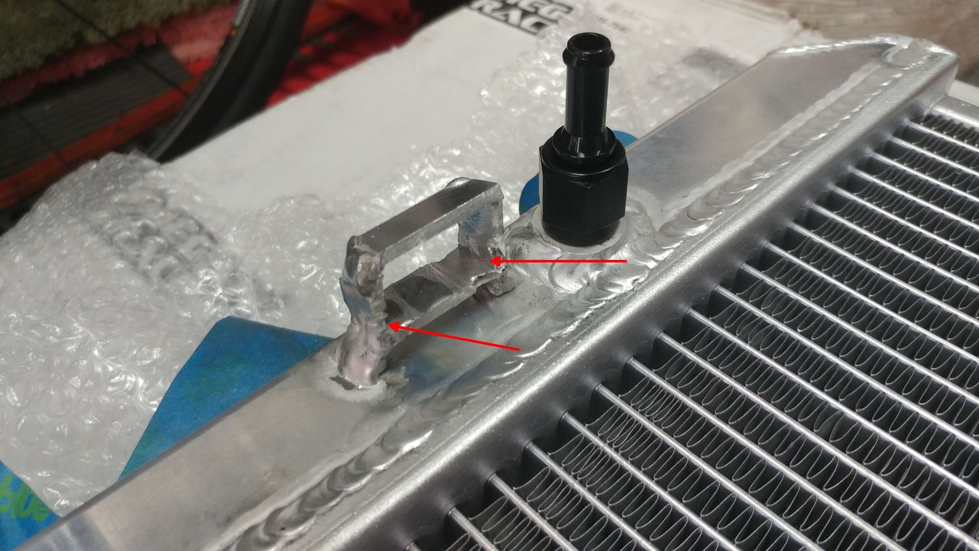

I just finished installing the radiator. Overall, I'm pretty happy with it.
Here are some observations I made in the process:
1. I wasn't very impressed with the AN6-5/16 barb fittings that came with the radiator. They looked like leaks waiting to happen so I used some nicer aluminum fittings. Add 5-10 HP minimum per fitting.

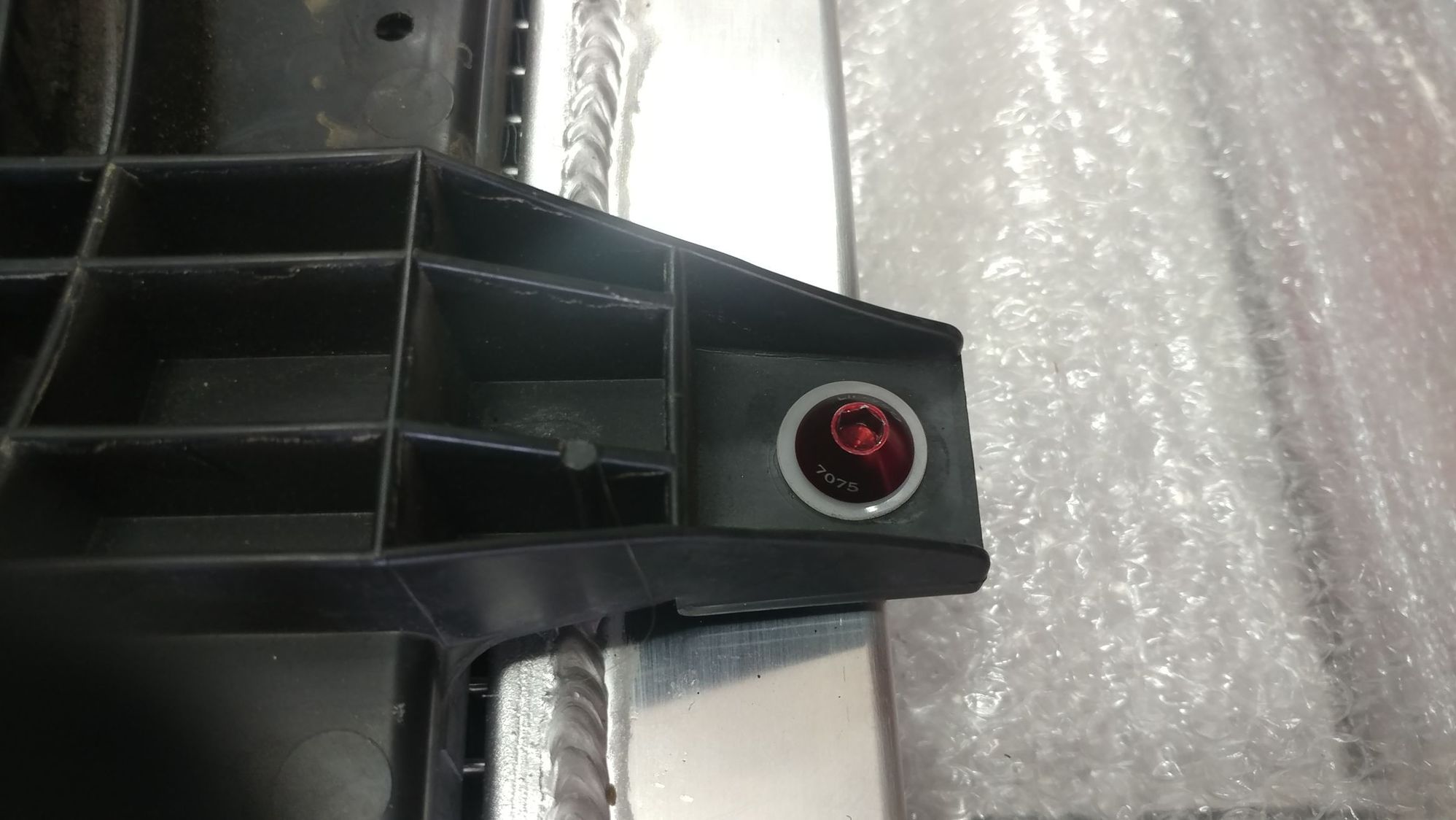

2. I had to file down the welds on one of the fan brackets to allow the fan shroud to fit. Not a big deal. Add 1-2 ponies due to weight savings.
3. The 2 screws that hold the fan shroud on the original radiator thread into plastic and are basically sheet metal screws. You can't reuse these screws, you will have to get some M6 x 1.0 screws for the new radiator. These cool red screws easily freed up 15 ponies each.
4. The drain plug made the 7-8 drain & fills much easier. Really too bad they didn't include one. The plug was good for at least 15-20 ponies.
5. This is the most important. The original radiator cap is rated at .9 bar (13 psi). The Megan cap is 1.1 bar (16 psi). With the Megan cap there was no exchange between the radiator and the reservoir at all. None, no fluid nor air. I decided to re-use the original cap and this restored the function of the reservoir. -10 ponies for reusing old cap.

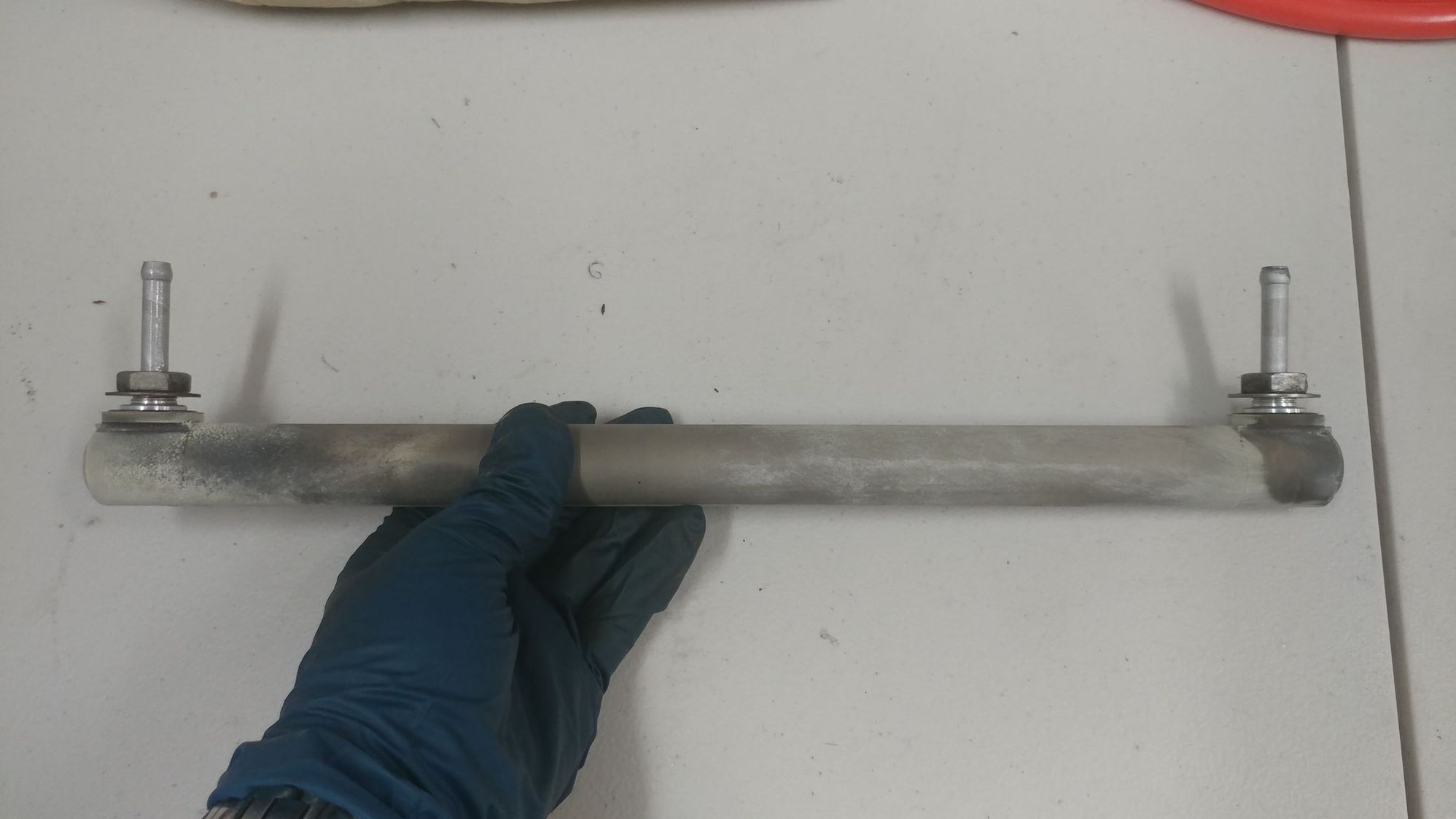

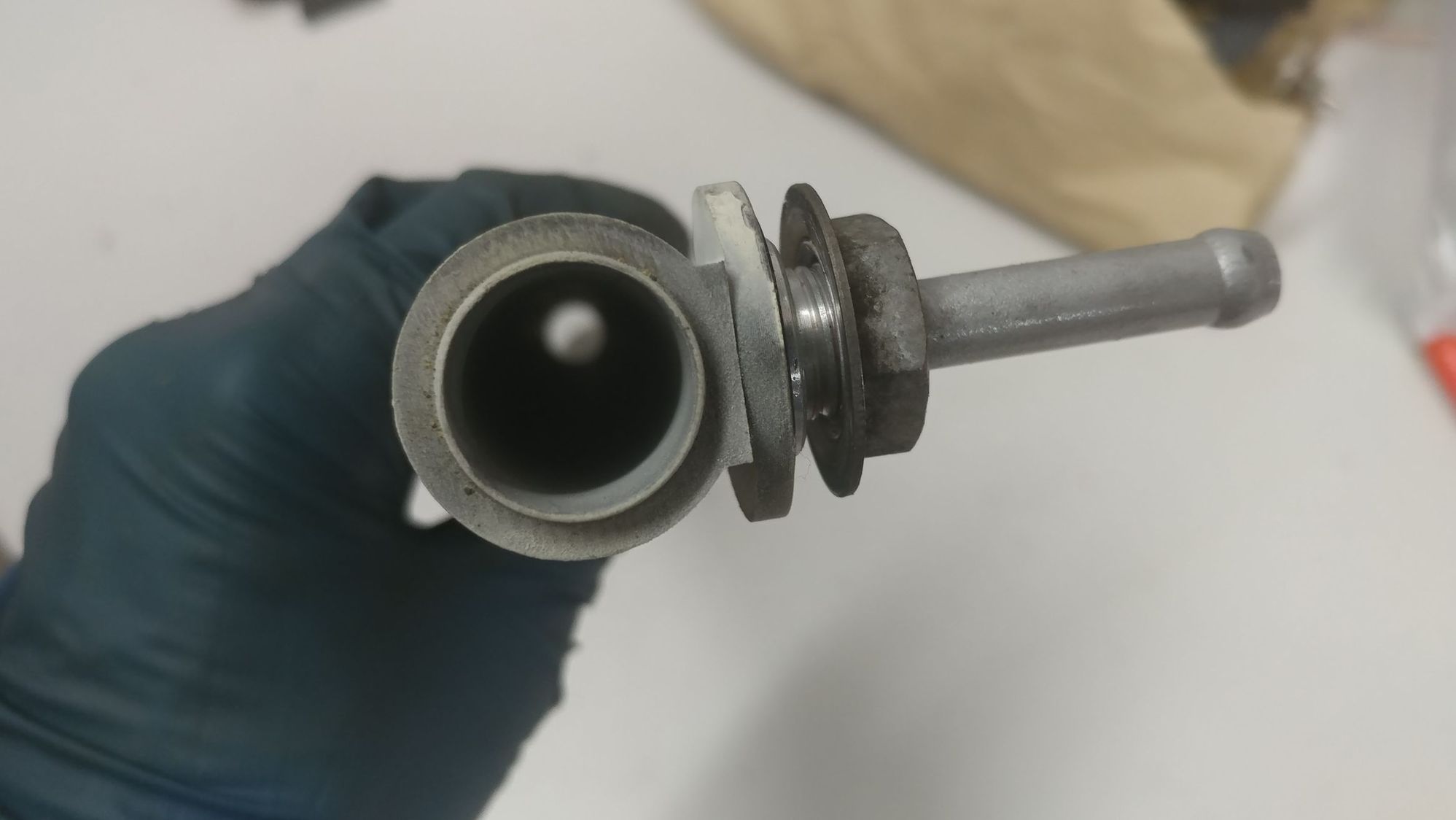

6. I decided to dissect the old radiator mainly because I was curious to see how the trans cooler works. I thought it would be just an aluminum pipe immersed in engine coolant. However, it's actually a pretty ingenious design. It's a hollow cylinder that the ATF flows through. This allows coolant to cool the inside and outside of the cylinder. I looked inside the Megan radiator with a scope and it has the same design.
Original ATF cooler.
ATF Cooler side view.
Megan ATF cooler
