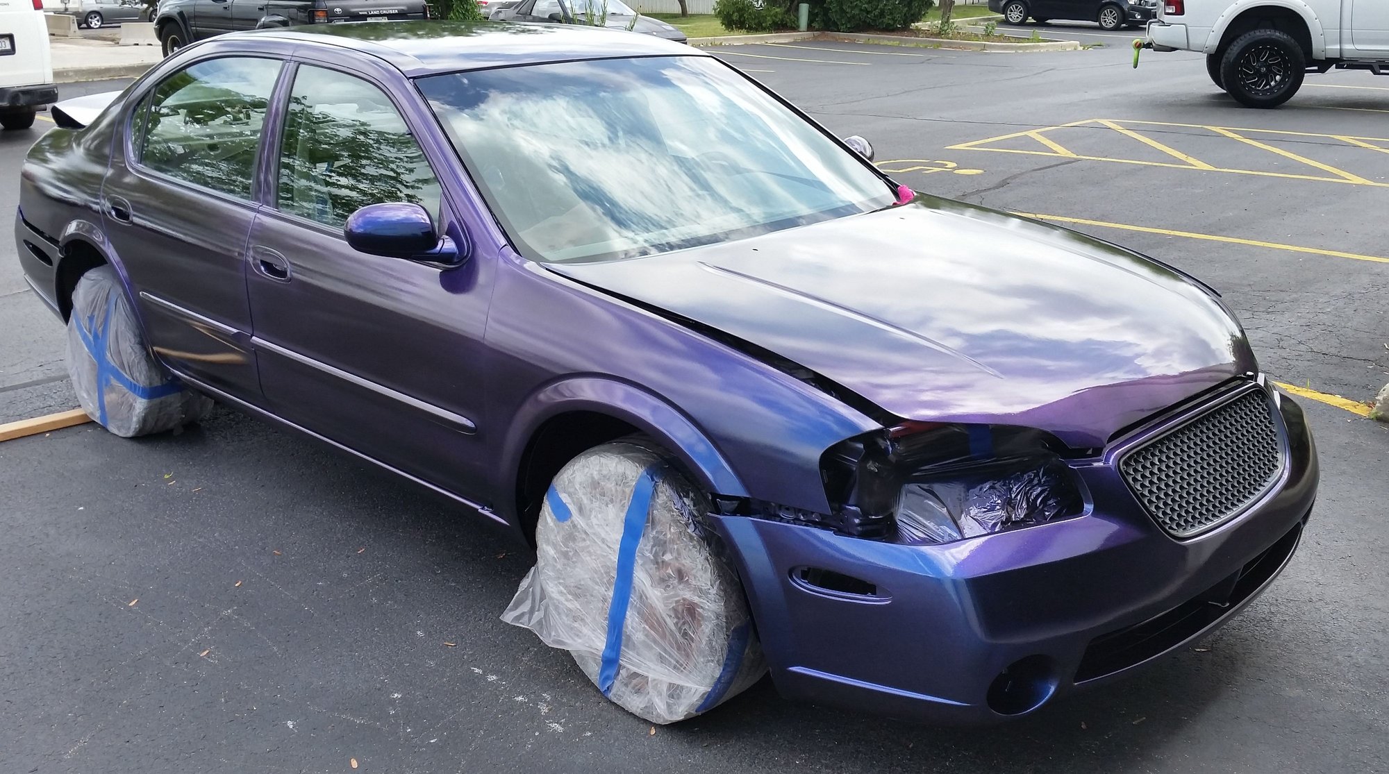

'01 Maxima with color shift blue-violet paint
