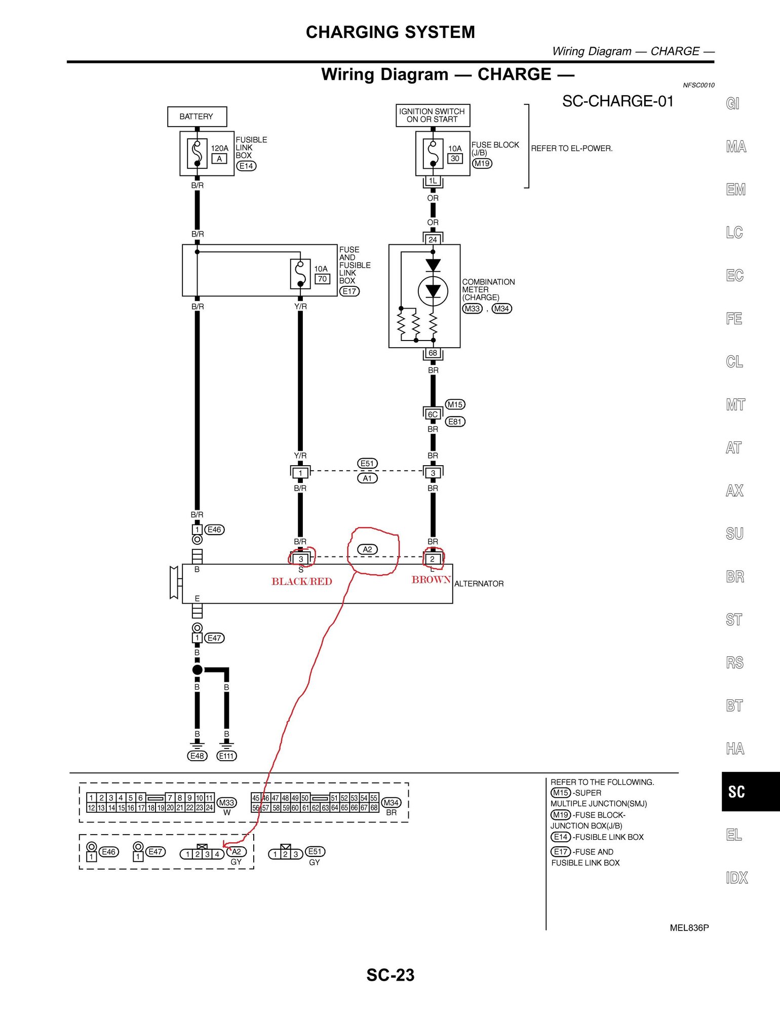

Did a quick search here and on google, but had trouble finding a definitive answer.
Swapping out my alternator and, like a dummy, I pulled the 2 wires out of the connector that goes into the alternator. Looks like nothing is damaged and I can push them back in, but I'm not sure which wires goes where. Could someone snap a pic of their wiring going into the alt and post it for me? Any help is appreciated.

Old Aug 17, 2021 | 09:52 AM
cvcrcr99's Avatar
Joined: May 2015
Posts: 7
Thank you! This was helpful and I am happy to announce the Maxima is back on the road with (another) new alternator.
