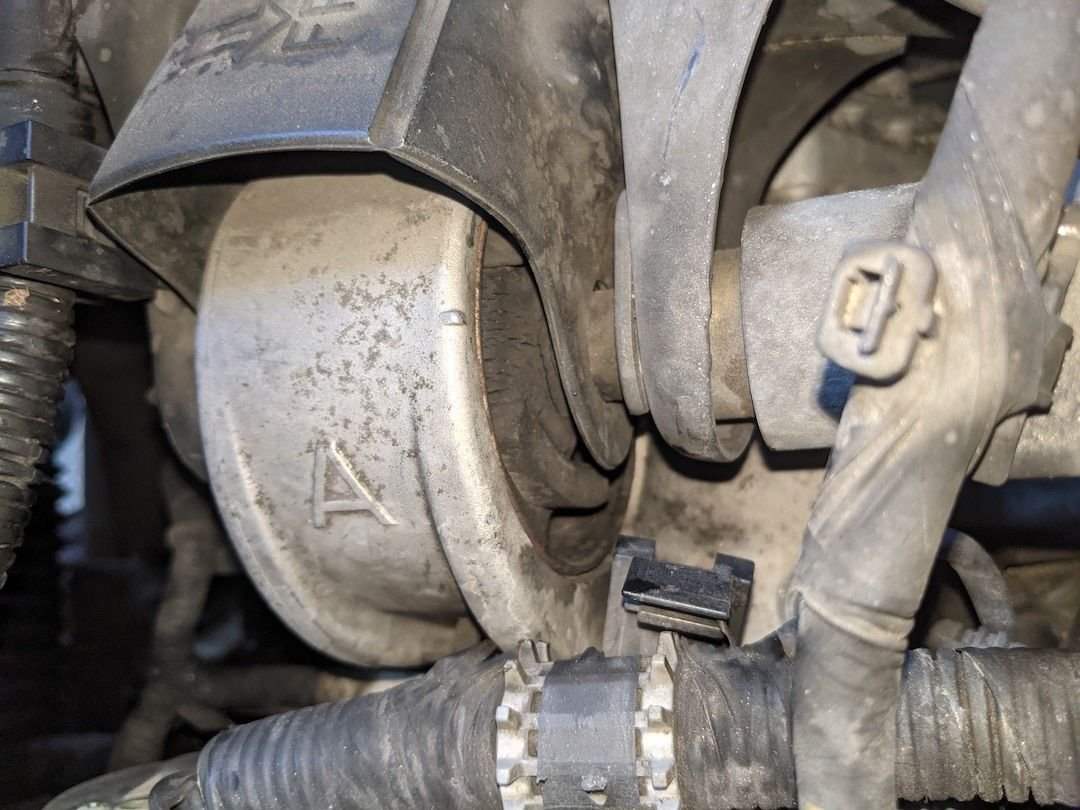

I am trying to figure out if vibrations at traffic light is because of a bad engine mount.
I was able to get pic of the driver side engine mount. Is this how a good one looks -

it's not missing any rubber but it does look old. when in doubt change them all. I highly recommend the energy suspension mount kit for the 2 lower mounts. if your car is automatic you will need to obtain a rear manual engine mount.

the mounts that do most of the work on these cars are the front and rear mounts. if you are thinking about them, it probably is time to replace them. i just replaced my original mounts at 275k miles with Energy suspension bushings and the increased vibrations from the poly mounts were not bad at all, and car drove and shifted like a new car., i would take the extra vibrations for the better feel and performance from them vs stock mushy ones for no vibrations. i daily drive too.
