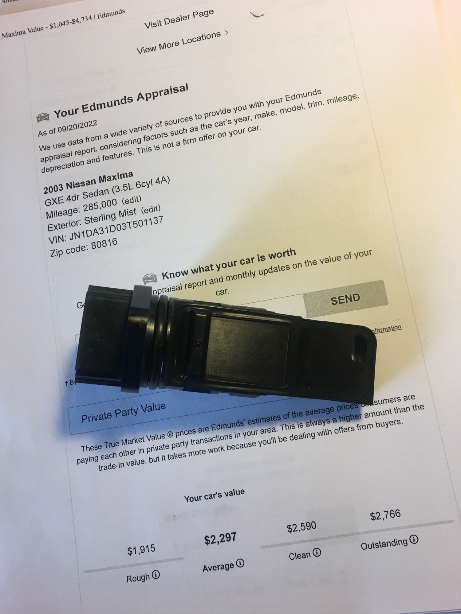

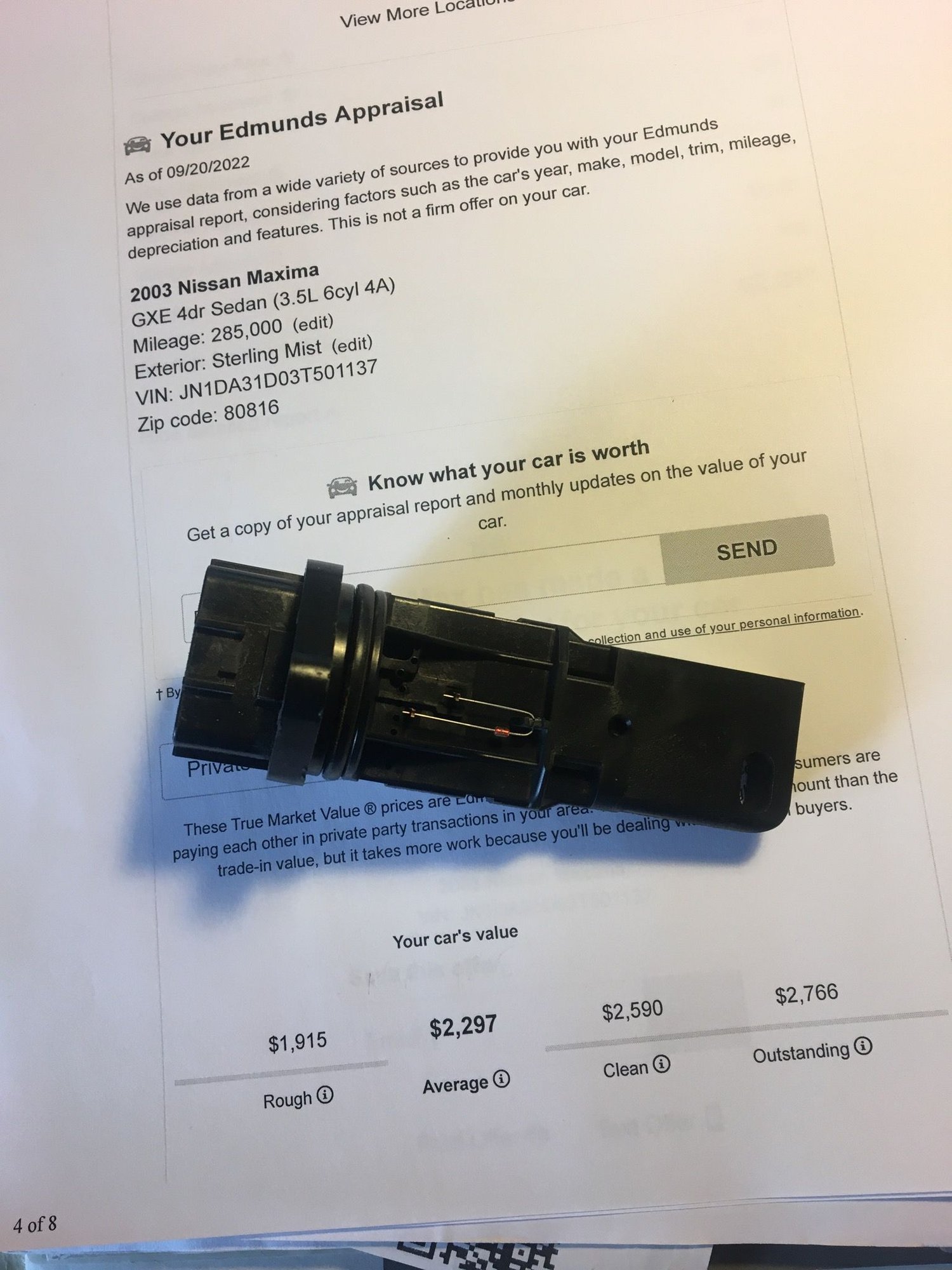

Looking on Ebay for a maf sensor. I find several that say they fit a 2003 Maxima BUT they don't look like the original I have. There is no part number on my original. It is all plastic - no visible metal plates, fastening flange is all plastic too (no metal screw 'tabs")
The only pic I've found that looks exactly like my original is here: https://www.nissanpartsdeal.com/part...tra2=&filter=()
Attached is a pic of my original
Do you think I can trust that this one on Ebay is correct for my 2003 even though it looks different? https://www.ebay.com/itm/31404473073...Bk9SR6LksY31YA
I would definitely not trust the MAF sensor in the link above. There should be a stamp or sticker somewhere on your existing MAF with the model number/part number etc.
