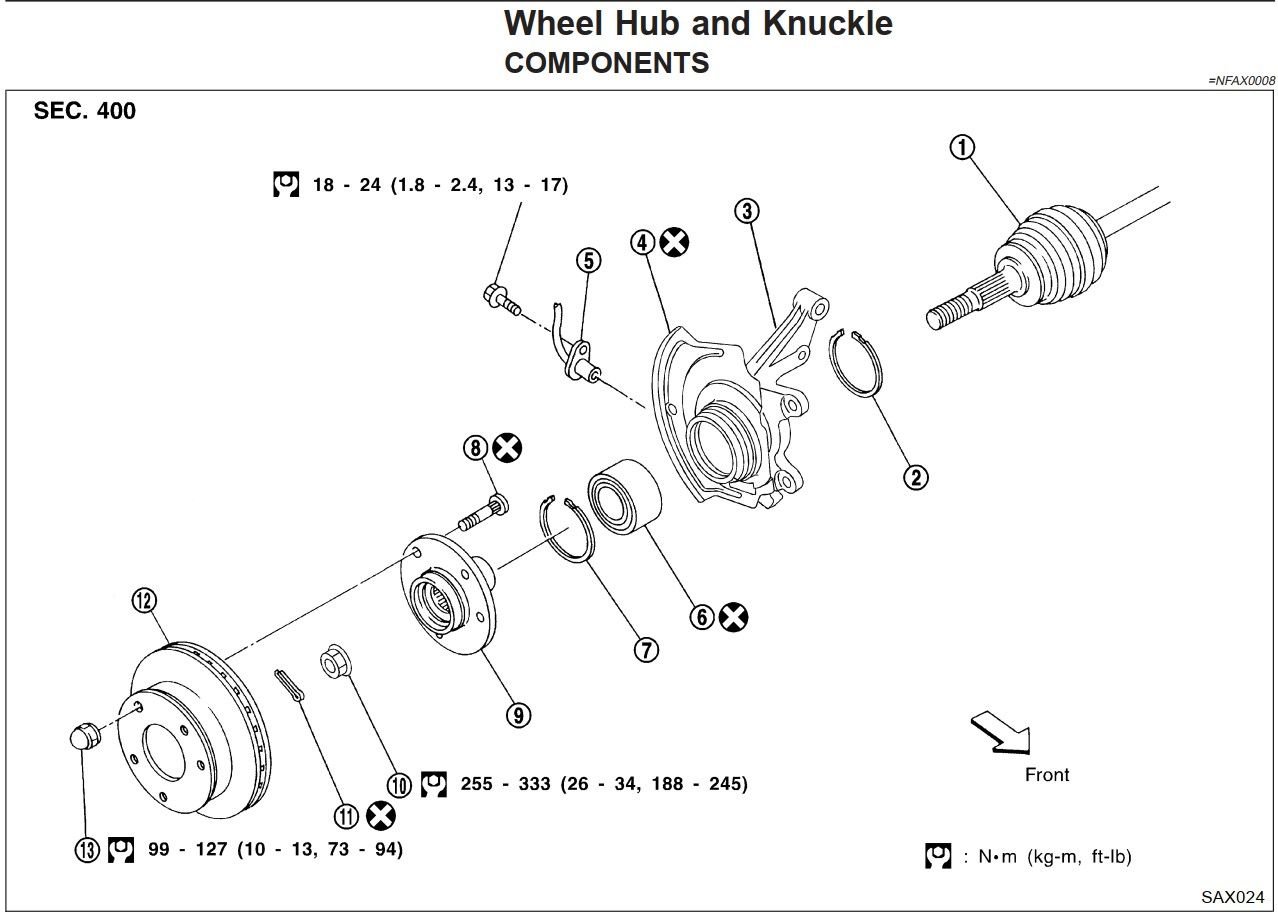

as for the wheel bearing over tightening can cause premature damage and cause it to make noise. I have the Nissan service manual and it says 188 - 245 ft-lbs for the axle nut. I don't see any reason to go over 200 ft-lbs.

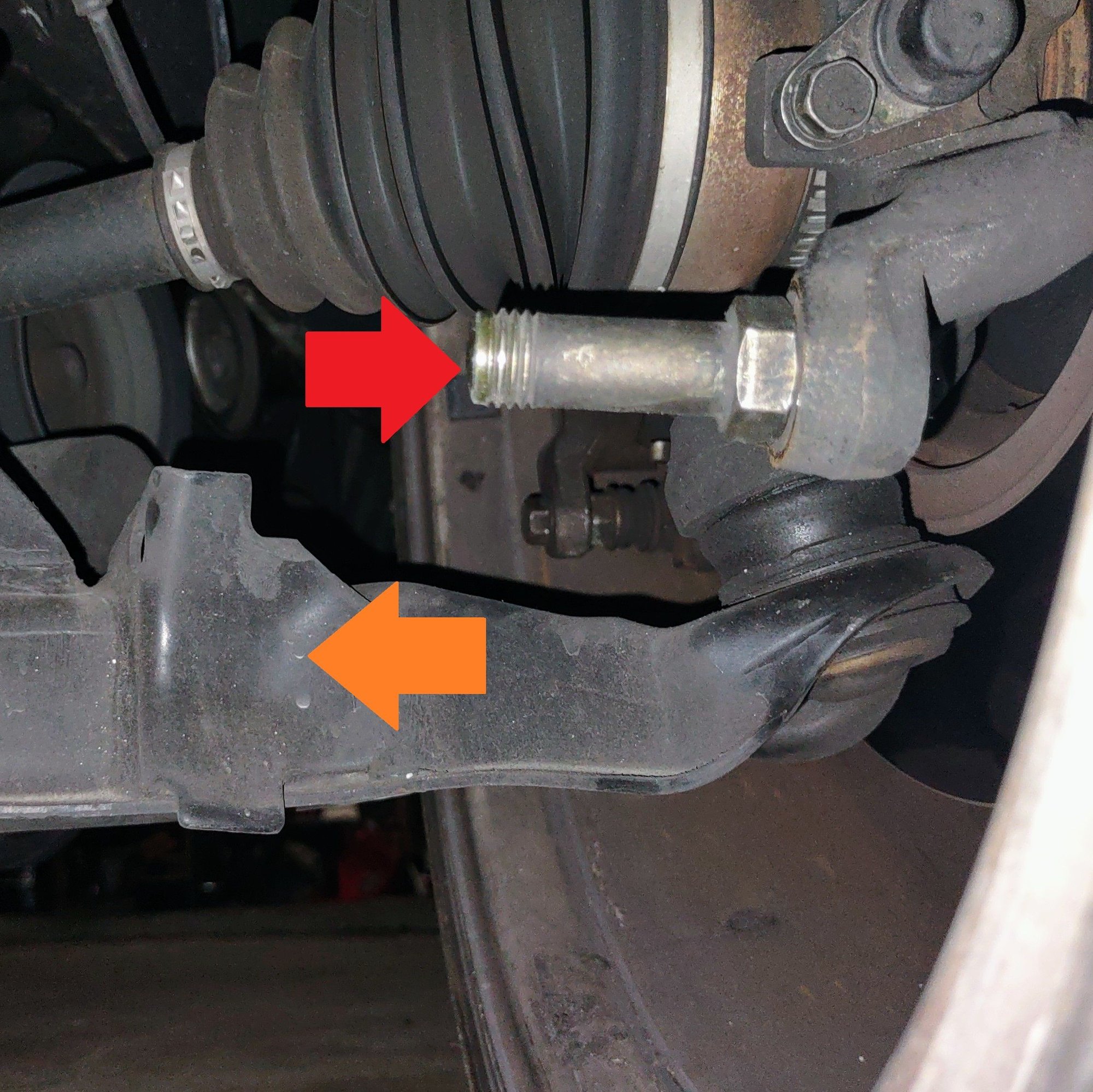

here is another thing to check. mine would make noise whenever i was doing a U-turn or moving with the wheel fully turned until I took it off. the piece with the red arrow rubs on the control arm where the orange arrow is pointing. there is suppose to be a plastic piece there where the red arrow is pointing.

i originally took it off to see if it would improve the turning radius but it didn't and I just left it off. there is suppose to be a plastic piece on the tip.
