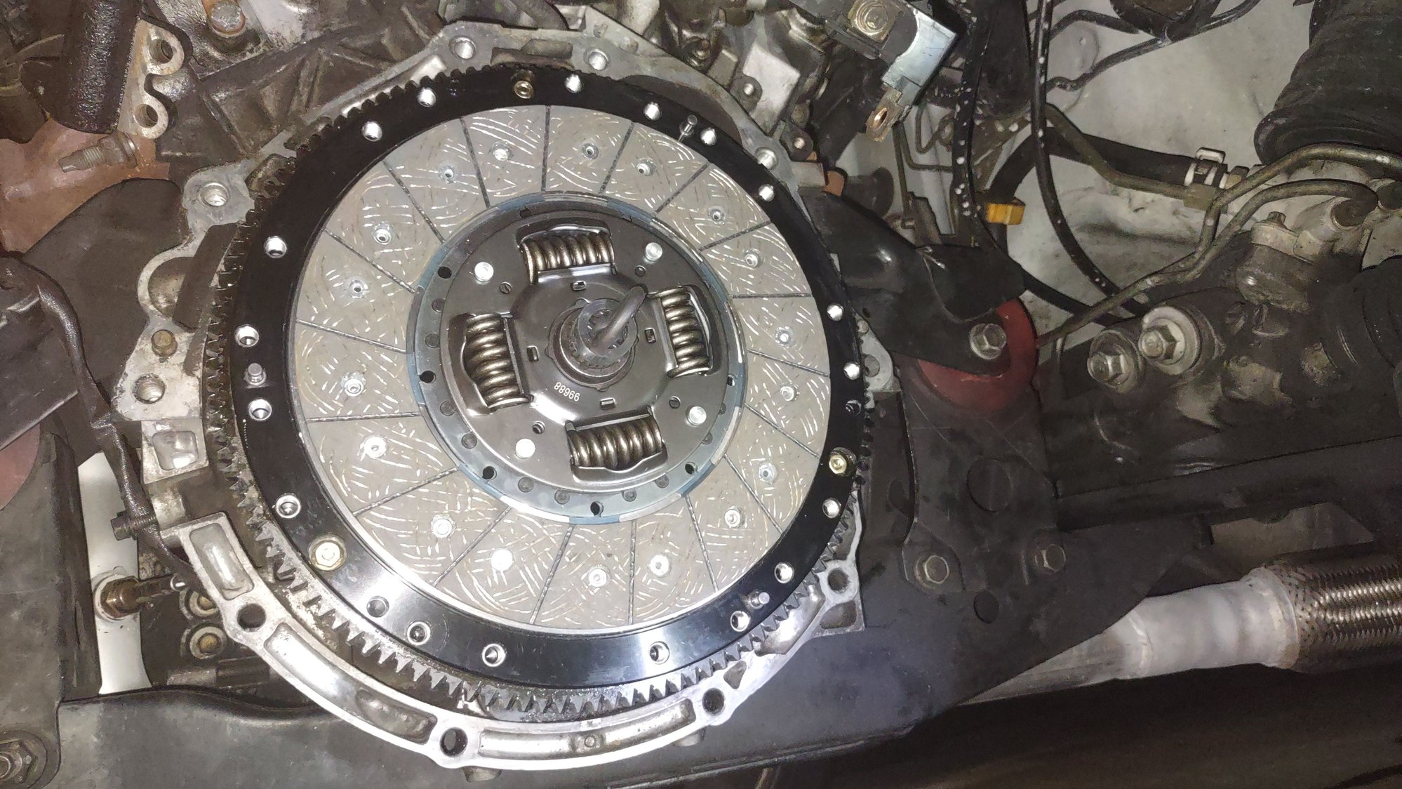

recently I installed an SE-R spec V H-LSD along with JWT flywheel and decided to try the M-Pact clutch components they sell on www.rockauto.com. the latest year Z that they list separate pressure plate and disc for is 2006, which should be good enough for bolt-ons and ecu reflash for 02 maxima. the pressure plate part number is M-PACT 98630 which is also their pressure plate listed for 02-06 Maxima. the disc part number is M-Pact 99688D which is their general sprung organic disc for many other Nissans and G35. I went with a National throw-out bearing and pilot bearing this time.
after putting 500 miles of city driving for break in I finally started getting on it yesterday and it has a lot more bite than the outgoing basic Luk kit I was running.
I also replaced the flywheel bolts with Allen head bolts with orange loctite, I hate torx bolts. Only Fastenal had the Allen head bolts that matched up. JWT instructions called for Loctite red but I don't think it's a good idea to use it on a crank. the flywheel will need to come off eventually, mainly when I do the 2nd gen swap.
double springs on the clutch disc

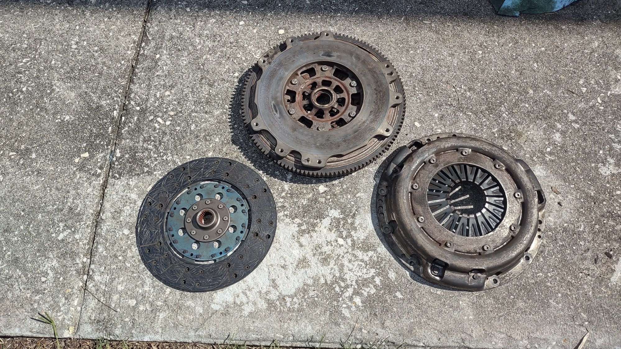

outgoing flywheel and clutch components

Old Dec 2, 2021 | 01:18 AM
Child_uv_KoRn's Avatar
Bad *** Newb
Posts: 4,975
Very good price for clutch kit as long as it holds up. Looks solid.

all the clutch components together ended up costing me $168.97 which isn't bad, now it's just a matter of how good it holds up. My lust clutch kit was an LUK that came packaged with an LUK dual mass flywheel, not Exedy as I mentioned above. when I first got my car in December of 2012 the throw-out bearing went bad a month later and I had installed an Exedy kit.

Originally Posted by uptownsamcv
all the clutch components together ended up costing me $168.97 which isn't bad, now it's just a matter of how good it holds up. My lust clutch kit was actually an LUK that came packaged with an LUK dual mass flywheel, not Exedy as I mentioned above. when I first got my car in December of 2012 the throw-out bearing went bad a month later and I had installed an Exedy kit.

Old Dec 4, 2021 | 06:00 PM
User1's Avatar
Joined: Jun 2018
Posts: 2,493
Looks clean. Refurbing and reconditioning the pedal hinge, fluid, master cylinder, all the engagement parts leading up to it will give it a nice feel too.
i had already had put in a new master and slave as well as a Nisformance clutch line that eliminates all the unneeded metal lines that Nissan put in. I haven't messed with the pedal hinge though.
