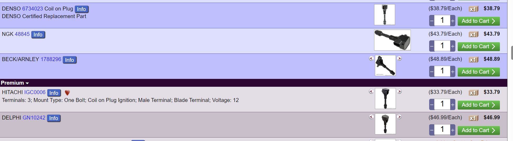

For coils, I'm running Hitachi and like them. They are the official OEM supplier and are about $33 each on RockAuto.

Agreed … many have purchased these and will attest to their quality.
… and for the purposes of your shopping, I believe that Hanshin and Mitsubishi are the OE brands. So if you run across those, you’d be quite good-to-go.

Go with Hitachi or Denso from RockAuto.

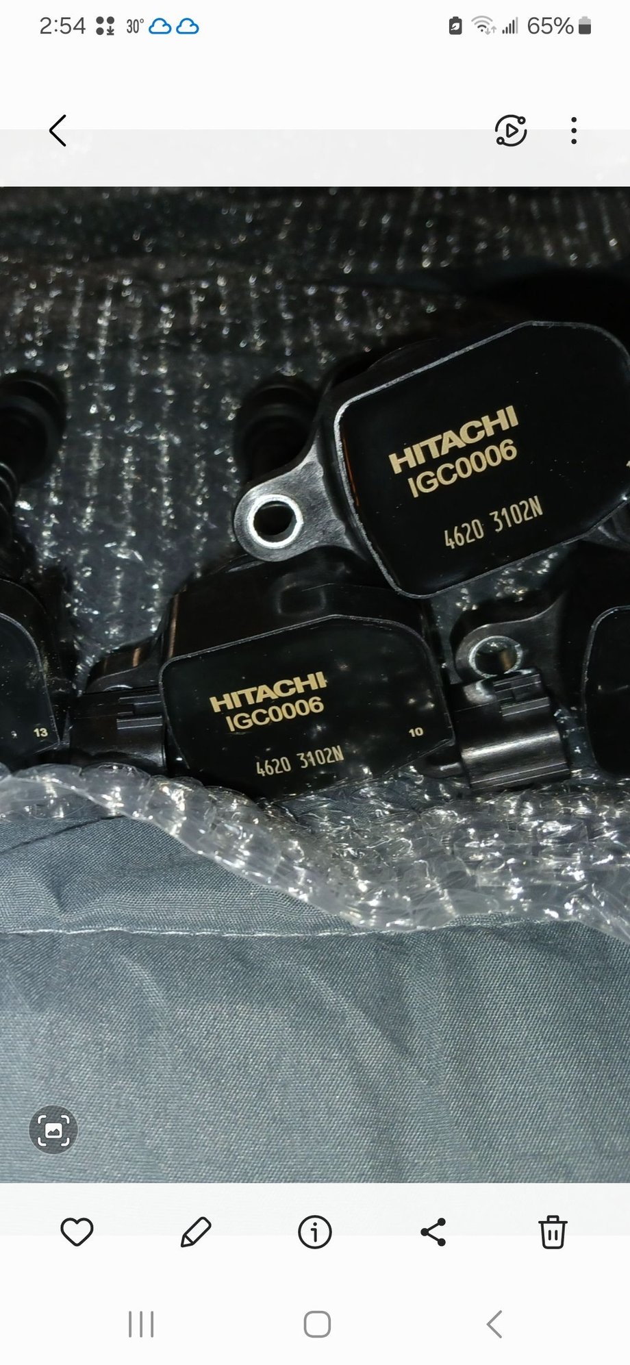

Harquebus, you 'nailed' it! That's exactly how it is. God bless you brother! I can finally take pics now to show the Hitachi coils that I bought from RockAuto.
Theres no interchangeable numbers on the coil packs anywhere, except these numbers on the bottom that say 4620 3102N and then (2) numbers to the very bottom right that say 10. Not sure what these numbers mean, but if anyone may understand the meaning of them, I would greatly appreciate it!
There's no interchangeable numbers on the coil packs anywhere, except these numbers on the bottom that say 4620 3102N and then (2) numbers to the very bottom 'right' that say '10'. Not sure what these numbers mean, but if anyone can explain what they mean, I would greatly appreciate it! IGC0006 is definitely the correct p/n for 2002-2008 Nissan Maximas, Altimas, Infiniti I35 etc. (all trims). These ignition coils came in 'brand new' Hitachi boxes and look legit. And came neatly wrapped.
Never got a call or email back from Hitachi automotive America technical support about what the 'bottom' numbers with 'N' at the end mean. Whether they may be a batch # or date code, or even a manufacturing number. I cross-referenced these parts with the oem Nissan packs and these are interchangeable with oem Nissan p/n 22448-8J115, 22433-8J115 etc. for future reference. God bless you everyone, and have a Merry Christmas! --- VQ

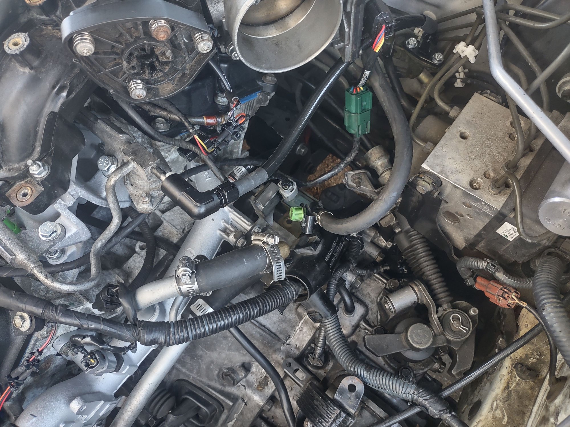

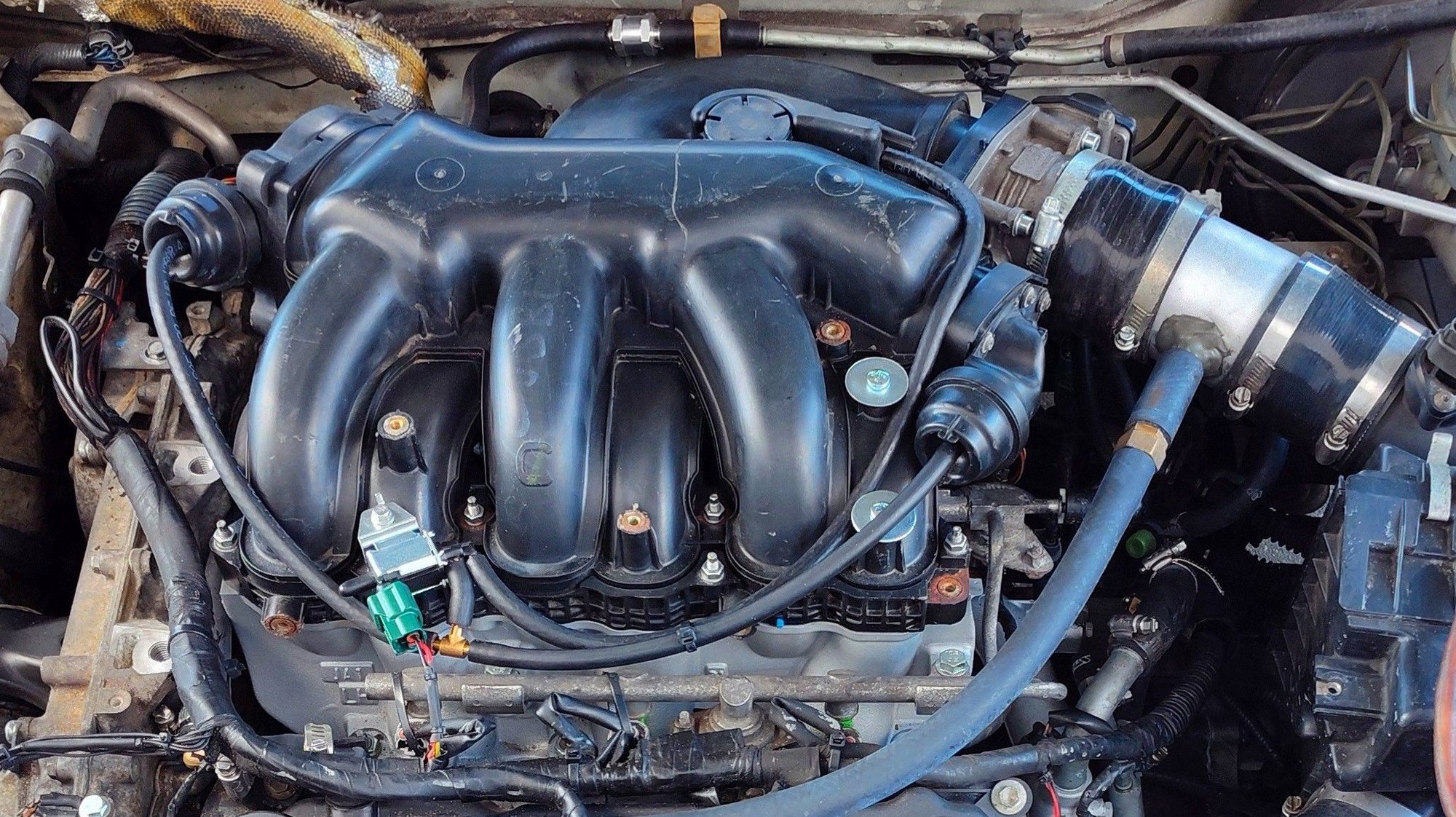

those are the right coils, I just did all 6 coils on my 07 (which take the same ones as your 03) because I had a miss and found out one was bad on the rear. As stated, its easy to remove the intake, I can probably do it in 10 minutes now, just be careful while removing those hoses as most of mines were hard and dried up, ended cracking a couple and just taped it together for now, as for coils, I used some cheap ones off Amazon and so far so good, car accelerates faster to speed with less pedal, and thats even before the old coil started missing, so I would say not all aftermarket coils are bad, but tome will tell.

And like a previous poster stated, I also DID NOT reinstall the useless brackets on the back of the manifold while putting everything back together.

That useless bracket supports the intake so you don't get a damaged gasket and get an intake leak! The VQ35DE isn't as bad with eating up intake gaskets like the 1997-2000 Nissan Altima KA24DE was, especially when get that infamous Misfire code.
