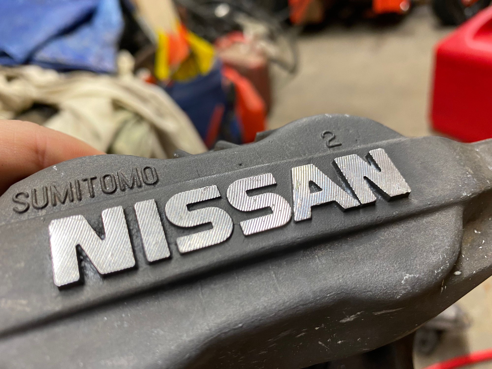

I know this has been covered, somewhere.. but after searching for over an hour i cant find a definitive answer. The links in the sticky for brake questions are all dead. So real quick:
I have brackets for mounting 300zx calipers and 13” rotors onto a 4th gen. I think the only difference with a 5.5gen is the mounting bolts are 14mm compared to the 4th gens 12mm,
but otherwise the spacing between the holes is the same - meaning I would have to drill the holes on my brackets out another 2mm. Any oldheads in here aware of any other potential issues that could arise here? The goal is 13” rotors and Z32 calipers without overhang, rubbing, etc. I feel like I knew this stuff at some point but that knowledge has since been forgotten, so forgive me on that. Thanks guys.
Heres some eyecandy while we are at it.
