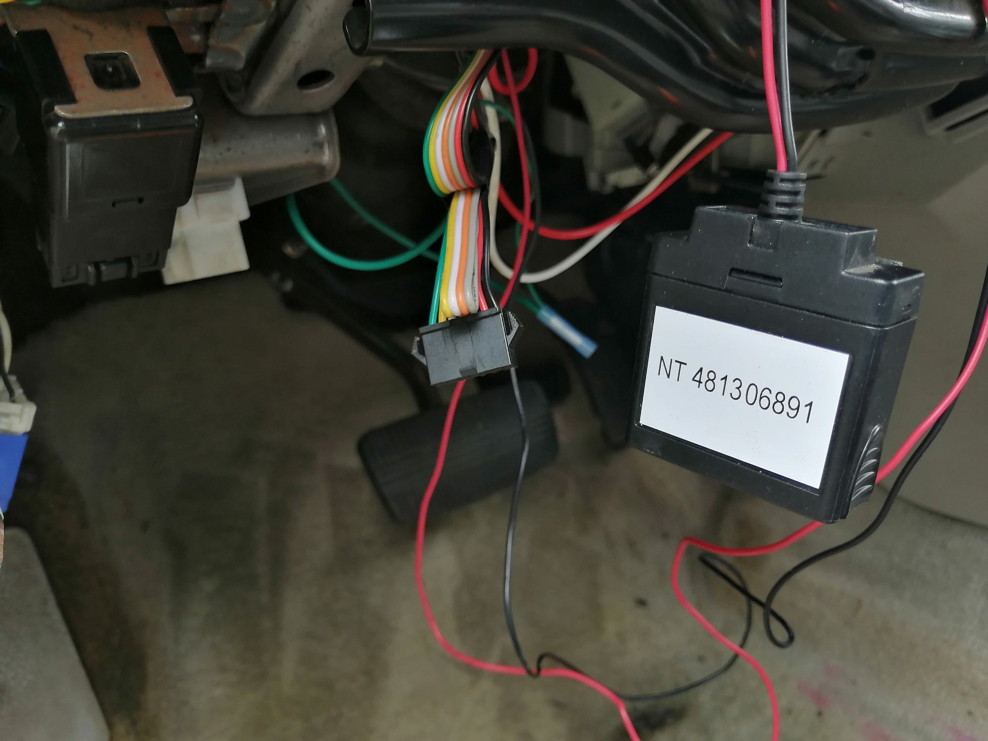

After finding and repairing the dislodged freeze plug.. I'm ready to try and Tackle the next issue. Power locks, windows and roof inoperable. There is 12 volts and ground at the upper two pin connector I assume is for the locks. White with red stripe. black wire. By looking for the white red stripe wire white blue stripe wire under the dash.. I think I've located the relay. Have 12 volts at the white red wire. White blue wire no voltage. I've tried swapping relays. At the multi-pin connector for the windows.. I have 7.25 volts at a thin blue wire. Can't find voltage or ground anywhere else. Someone had made a jumper wire to connect the white red stripe 12 volt positive power locks wire to the white blue stripe wire at the multi-pin window connector. The wire was broken. I stripped it and put it back in. Still inoperable. Checked all the fuses in the fuse panel. They are good. Also found some kind of probably aftermarket device wired in to the OBD2 wiring. The little box says it contains a SIM card. There is also this little multi wire port that appears to be integral to this contraption. Some kind of aftermarket OBD 2 Diagnostics? Hopefully somebody's will post a wiring key for the wires to the multi-pin window connector. Seems like I should have a ground there? Anybody have some advice? The photo shows with the jumper wire that was obviously added. The probe is in the slot where I found 7.25 volts. The first picture is the contraption.
