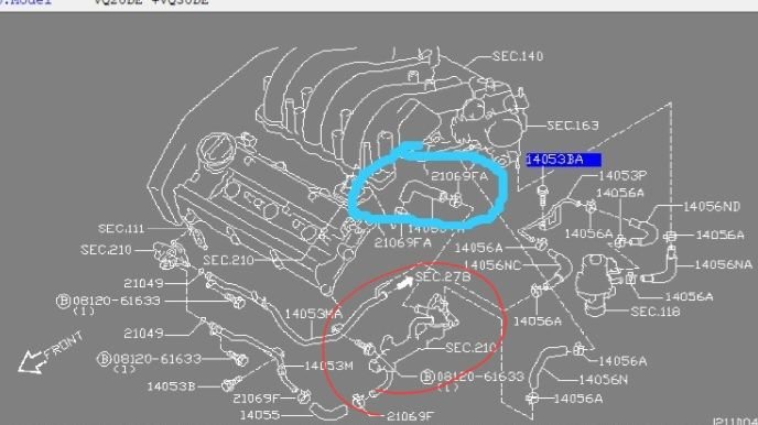

Just recently I bought a replacement engine (old one had a blown head gakset and warped head) and swapped it, after that was done I realized the engine I installed had one small difference.. It is missing the second bigger thermostat, so the coolant circuit goes directly into the block instead of passing through the middle of the intake.

This diagram attached shows how the flange was on my old engine, with the big thermostat on top and the rubber pipe going under the intake manifold

I'm well aware of the differences between the various years of the engines. Here in the USA they are basically interchangeable, save for emissions equipment for certain states. The 2nd thermostat regulates engine temps more efficiently. Not a big deal overall.
Did you swap any parts from the original engine on to the replacement?
Can you check the temps with an infrared thermometer or OBD scan tool? Is it possible you need to bleed air from the cooling system?

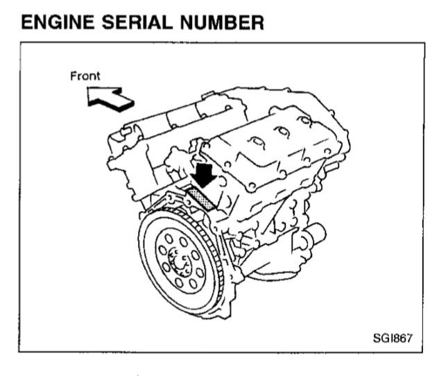

Check the serial # on the new(er) engine.
Then do a general search re: that serial #.

This is what I found : VQ30 4582960

This what I got vq30 4582960

Maybe a B at the end
