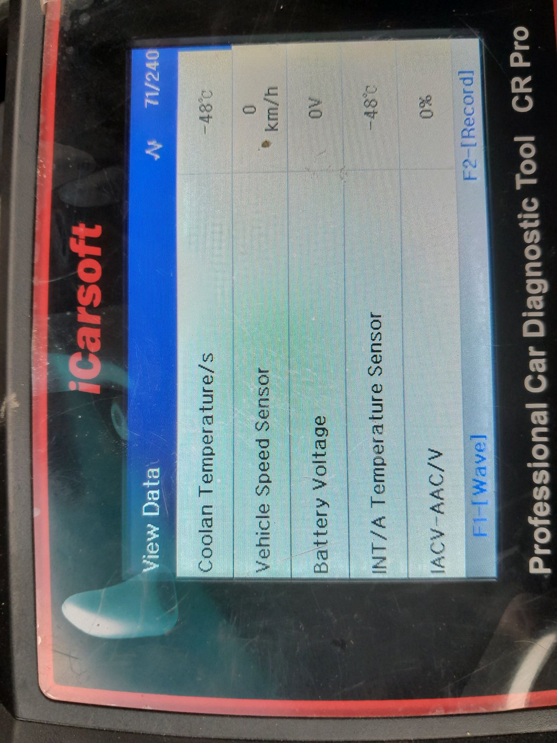

what is this Int/a temperature sensor? Why it always point at -48. Where it is and can wire harness cause it?

Intake air temperature sensor maybe?

Intake air temp and it could be caused by a broken harness, broken iat sensor in the maf, or the wrong maf
