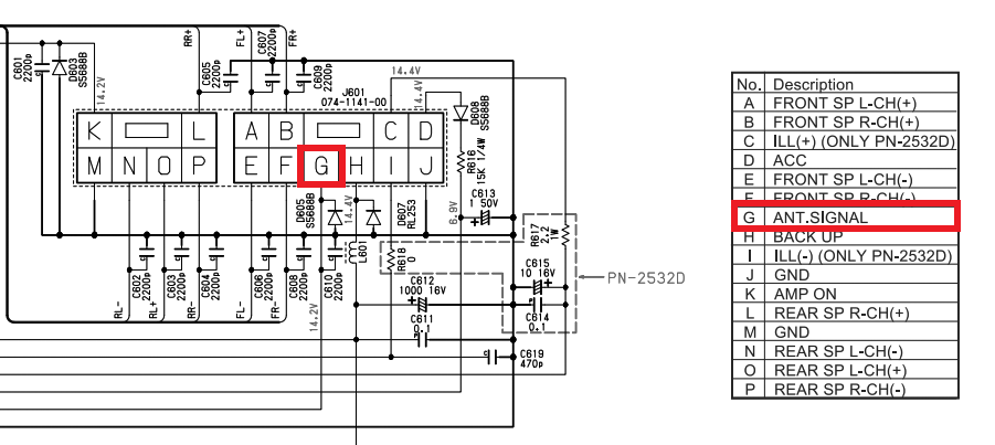

2002 Nissan Maxima
Poor radio reception. stock radio
Does anyone know where signal amplifier is located?
I found this diagram in local nissan dealer place.
No clue how to access A B C D and E.
going to check on ground today.
Thanks

sometimes radio plays excellent. I removed antenna and noticed that antenna connection is good. So may be power booster to the antenna is bad. or some thing in between antenna and HU. Do not know how to access those areas and where they are located.

sometimes radio plays excellent. I removed HU and noticed that antenna connection is good. So may be power booster to the antenna is bad. or some thing in between antenna and HU. Do not know how to access those areas and where they are located.
Especially power booster to antenna.

window tint can have an effect on antenna reception. The cars are known for not good reception due to a window antenna so the amplifier is probably ok.

when you hook up a new stereo there is a wire on the adapter harness you need to hook up similar to a power antenna wire. for years I had bad or almost no reception. with the last radio I installed a few years ago I hooked up what appeared to be a power antenna wire on the harness and now my stations work..
