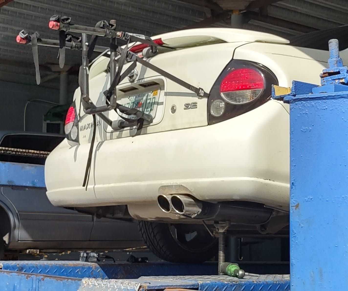

making power and keeping it quiet would be an interesting build. I do miss having the quietness of the stock exhaust but the stock exhaust piping seems like it's sized for a 4 banger. I guess it was really needed to keep the noise down. right now I'm running 3" exhaust and I went with a Thrush turbo muffler thinking it would keep the db close to stock but it didn't. I'm thinking of trying Walker quiet flow next..
