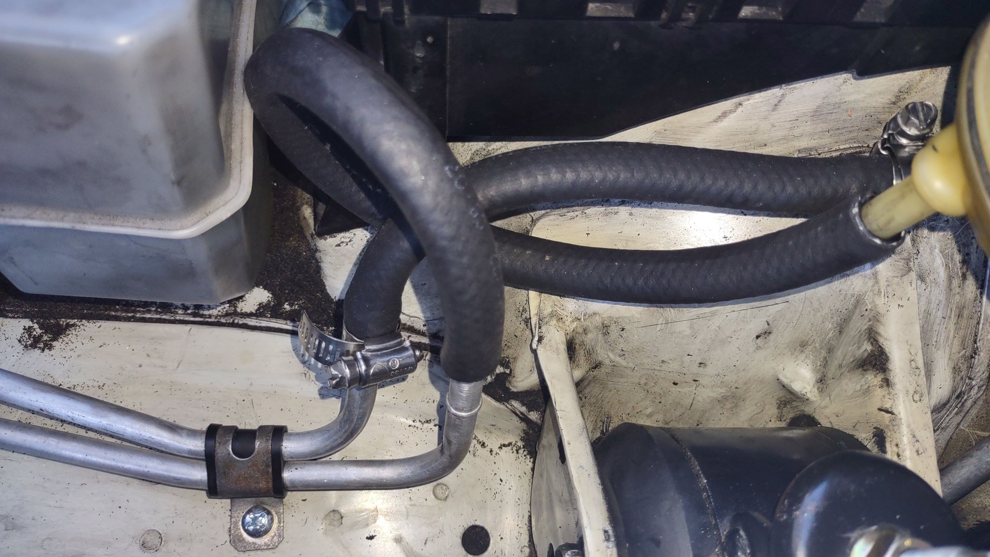

I have a 2003 SE 6 speed that has a power steering leak on the return hose that runs along the firewall from the rack and pinion to the cooler tube. This pic is from a 2001 so it's slightly different:
The leak is where the hose connects to the cooler tube near the passenger side.
It looks like the previous owner used something like flex seal to try and stop the leak but it obviously didn't hold up. I have a few problems with this hose.
1. It looks like it should be a couple of inches longer, going past the metal lip.
2. The hose is discontinued for a manual transmission so I can't buy a replacement
3. This is not an easy area to work in
4. It has a spring clamp that I can't remove because one squeeze tab is broken
Can I use a return hose from another Nissan that'll fit? 2004 Maxima?
I'm looking for any suggestions on how to fix and if someone has a spare hose for a 2002/2003 manual that they're willing to sell.

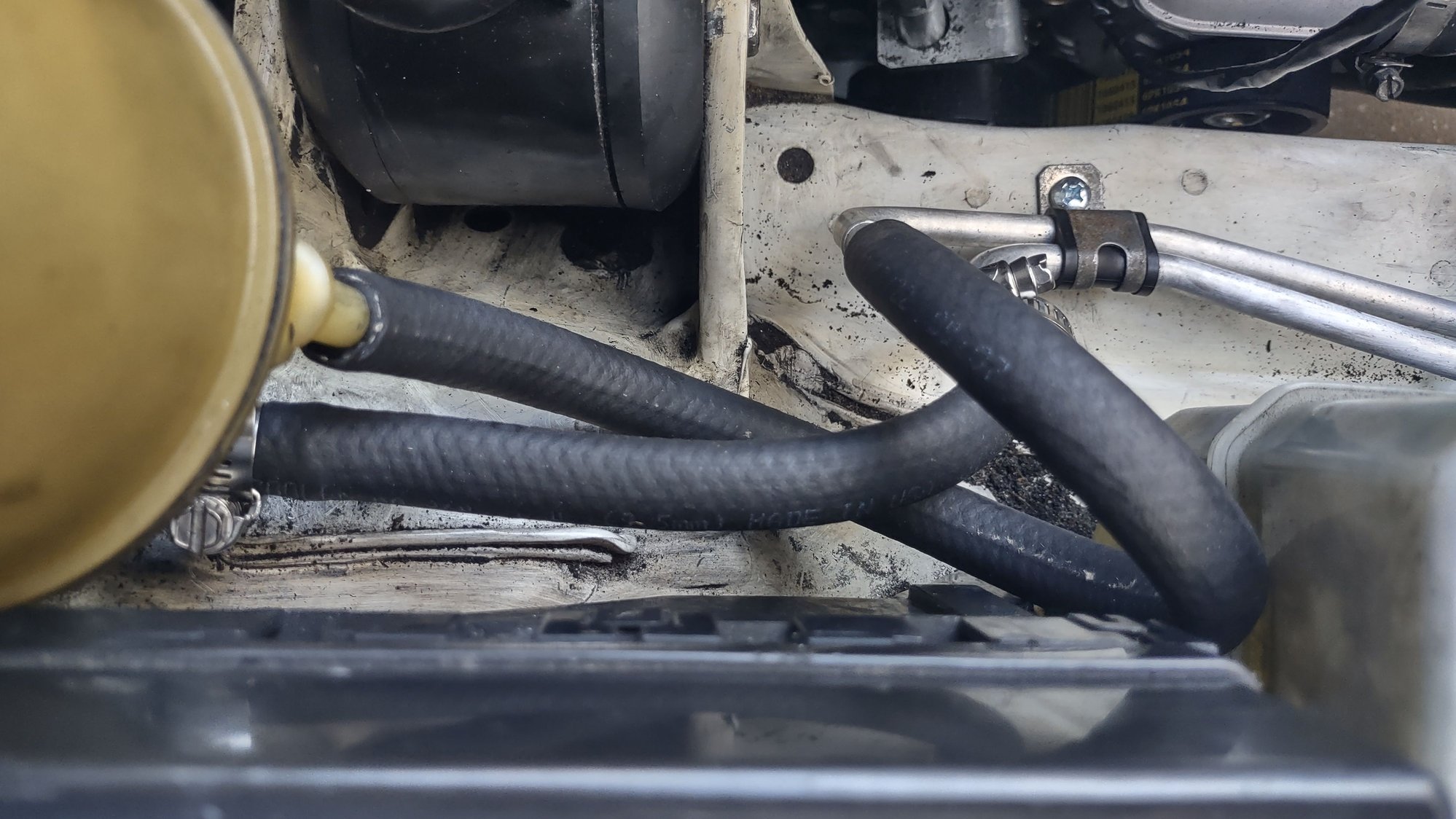

I was doing mine this morning and this is how I ended up running the hose, need to go get 2 more clamps though. you don't want to make sharp bends with the hose which is why I looped it. make sure the cooling tube is clean for maximum cooling efficiency.
