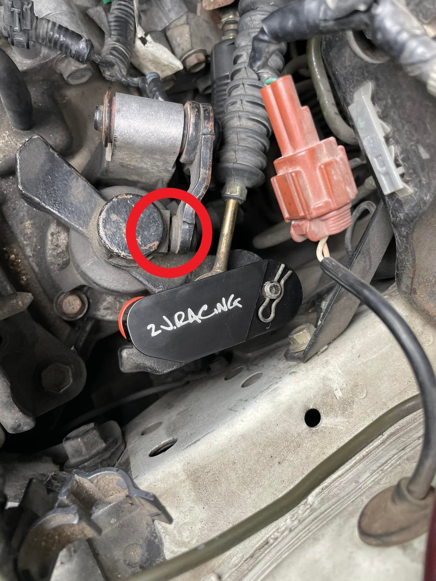

the first time I did my clutch and couldn't go into reverse afterwards I actually lost a piece. if you look in the red circled are below there is a piece that is in there. if it is missing you will have a hard time going into reverse. Nissan didn't have it so I had to find something that works...

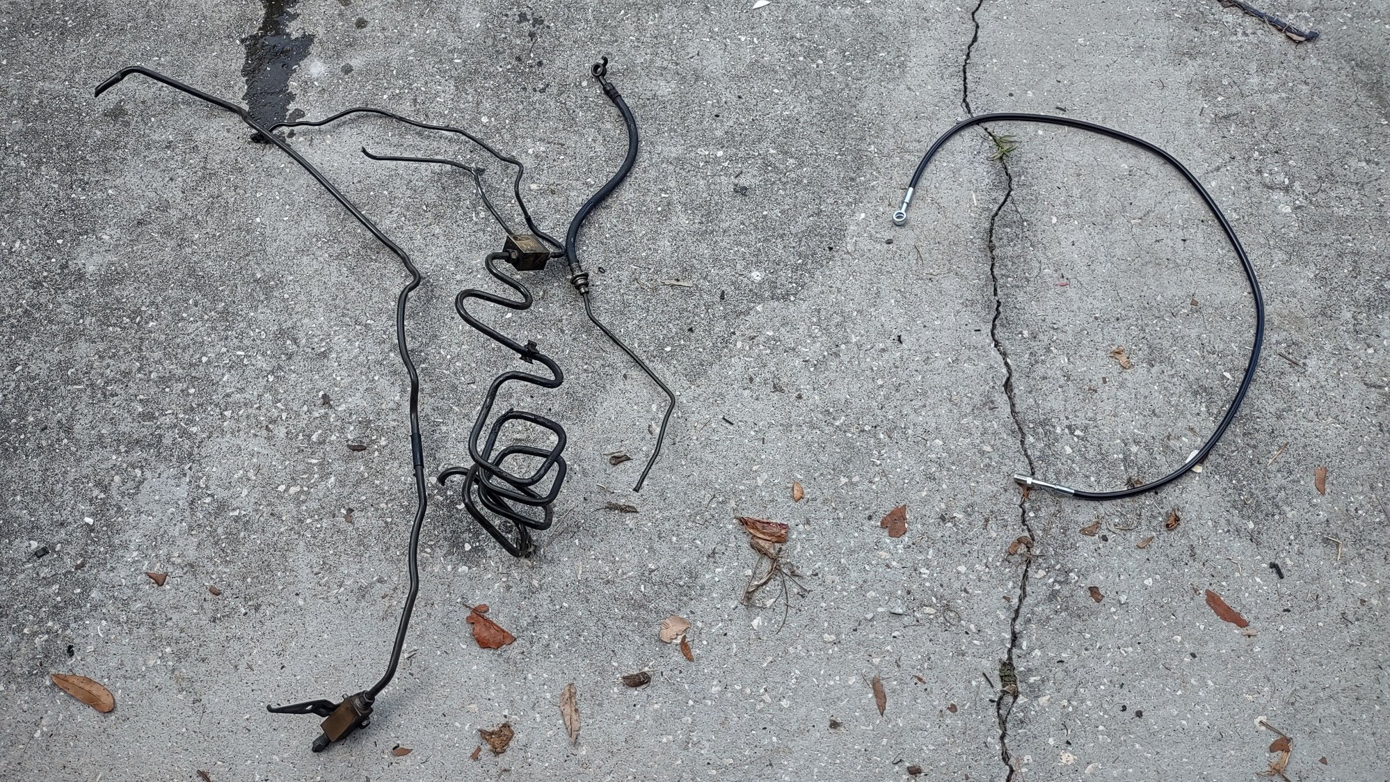

these cars are a pain to bleed, I highly recommend the Nisformance one piece clutch line to eliminate all the unneeded factory metal tubing our cars have.
I remember on really hot days my clutch pedal would lose pressure back when I still had the factory lines.
You really caught my attention with that! When I swapped from one 6 speed to a different one, all of a sudden it was very difficult to get the car into reverse, and it felt like a linkage problem. I haven't found a solution and just deal with it and have to really shove it to get it into reverse. So what exactly did you lose, and what was your solution? I don't see anything super obvious in your picture.

the pic above is just one I found online real fast, I just went outside and took a close up of mine. it's been ten years since installed it so I don't have much info on it. it's some sort of brass bushing and it fit perfect. I don't remember if I ordered it online or got it locally. I'll check through my old posts and see if i started a thread on it.
