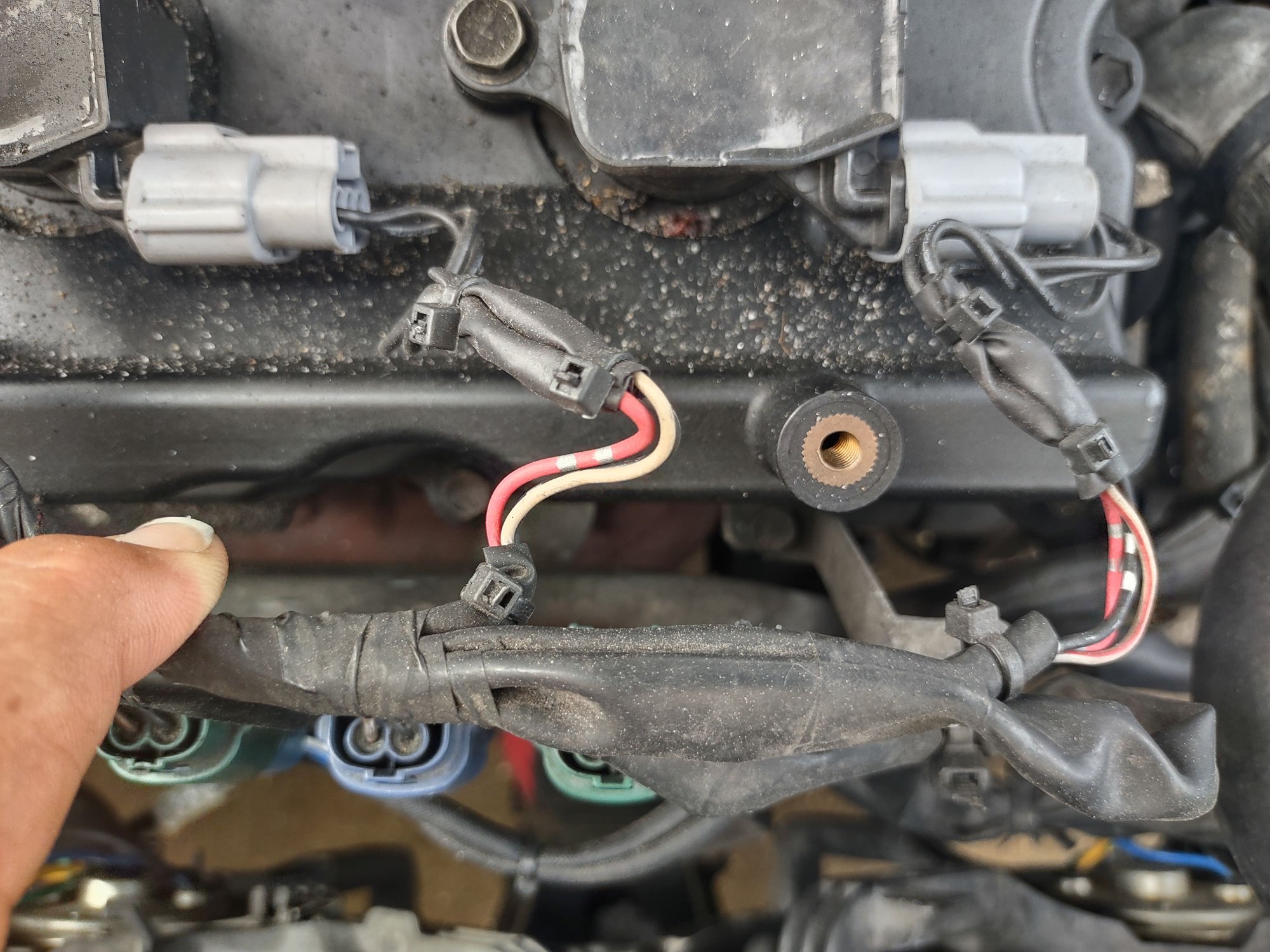

I cant figure this one out.. 02 Maxima with consistent 4-5k misfire/cutout under hard acceleration. A few weeks ago the car loss all power due to mid cat being stopped up. I replaced the 2 front cats and removed the mid cat. During this time, I also changed VC gaskets, new coils, new plugs and fresh fbjc101 injectors. After i was finished, I started the car and noticed the TB was not plugged all the way in. I plugged it in and did the relearn. However, the car runs great when cold but once its warm the misfire/stumble begins. I replaced fuel pump and nothing changed. My original injectors were fbjc100's and Im wondering if that has something to do with it. I put on a new MAF and still nothing. Drove it all day yesterday and still no SES light. Im stumped!!

I think its the coil connections. There's a guy on Ebay that sells a harness because he had the same issues. I will change the connectors and report back this weekend.

Well, it wasnt the coil connectors. It runs worse now than it did before after i did the relearn steps. After it warms up, it runs like poop..no engine codes
