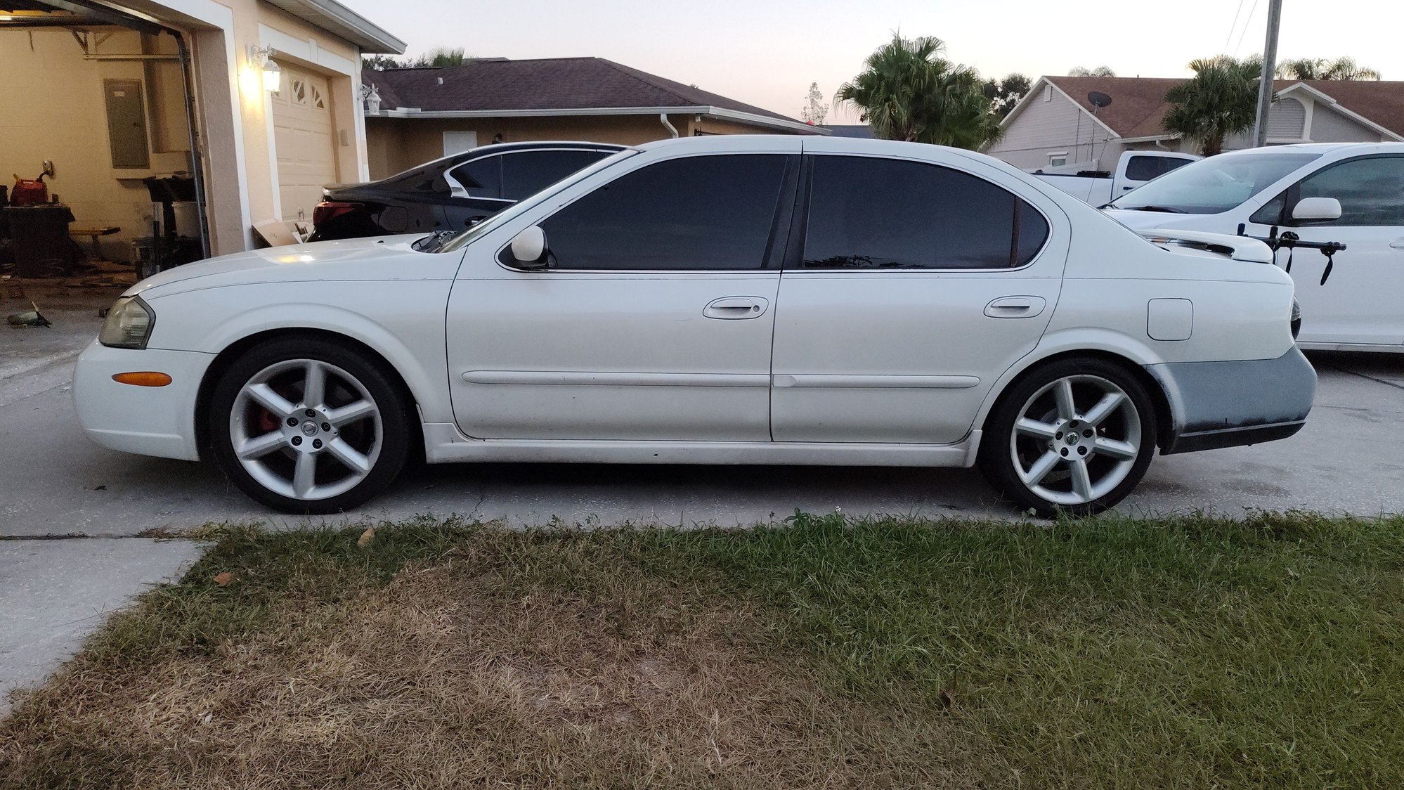

I was due for some new struts plus I wanted to go a little lower up front. I've had the Megan racing springs since 2013 and the last time I installed a set of struts was in 2016 and went with Gabriel Ultras. this time i went with Tein S Tech and KYB GR-2 struts. springs were $275 and struts were $315 shipped from rock auto, also have new strut boots and upper mounts.
the car has a more solid feel compared to the Megan Racing springs I had paired up with the Gabriel Ultra struts. still a comfortable ride and feels good at highway speeds. the rear is about the same height as the Megan springs and the front is a little lower now. I went for an alignment today and I was told that the camber and caster was ok and only needed toe adjustment.
245/40-18 tires on 350Z touring wheels.

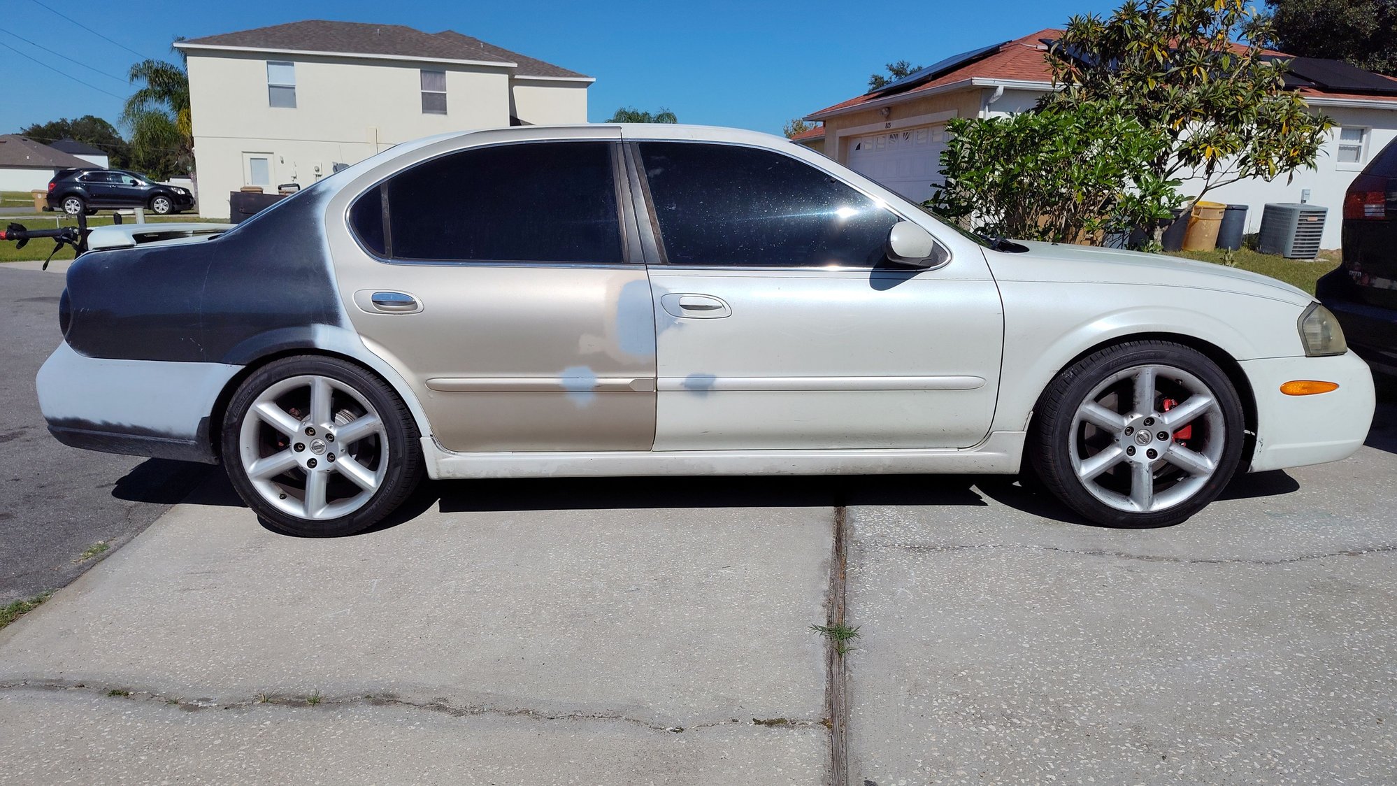

fender gap is more visible on this pic of the bad side

Old Nov 6, 2023 | 01:09 PM
nick's Avatar
Joined: Dec 2001
Posts: 2,072
From: San Diego
Looks good and even.

these cars come with a ton of fender gap and look way better lowered. the Tein S-Tech springs are stiffer but still comfortable. all the other springs I came across leave a ot of fender gap.

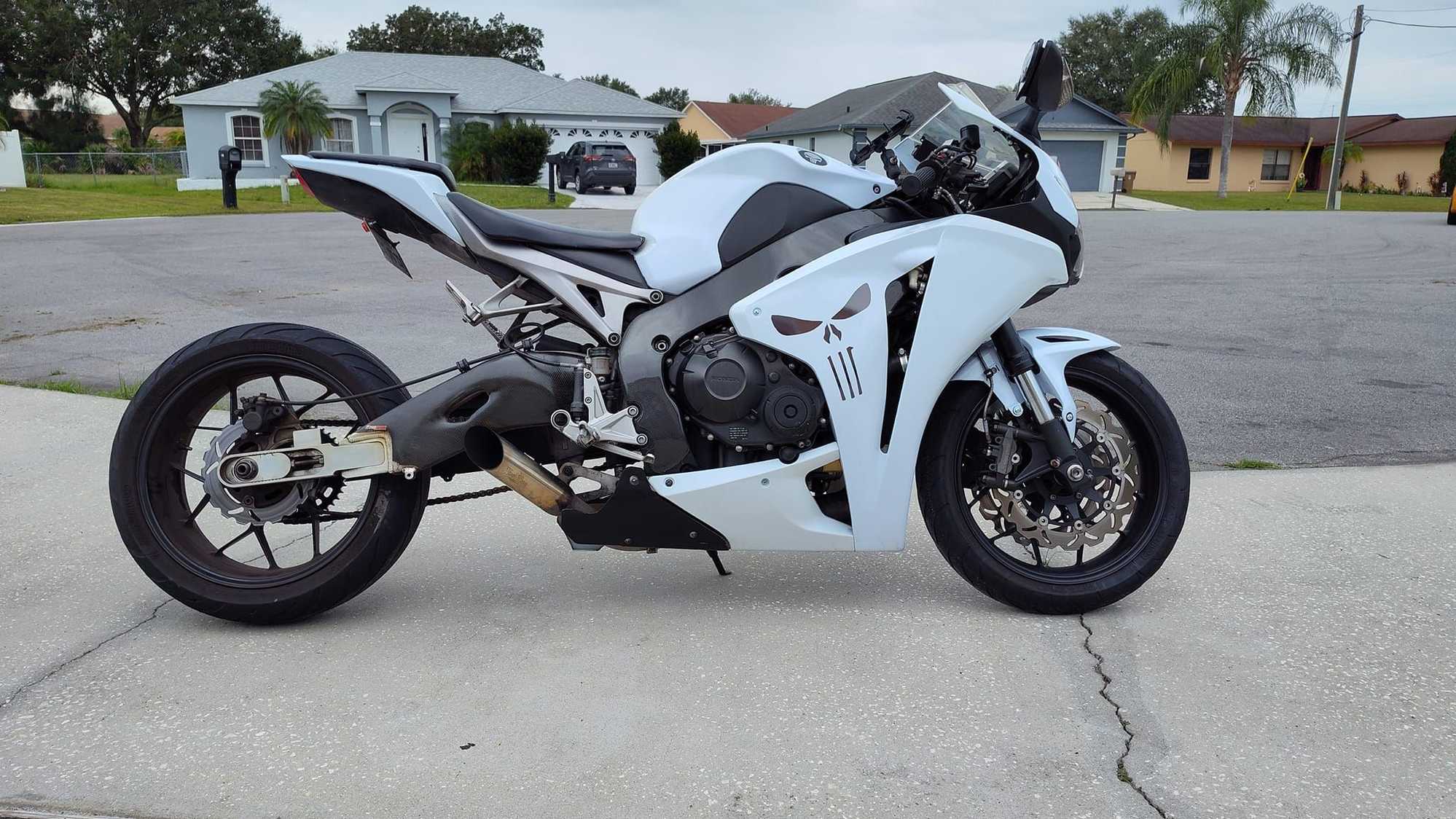

just going to keep it white and paint the swing arm and rear subframe black. I'm about to do the 2012 fairing conversion, 2008-2016 is the same bike so the fairings fit perfect. just have to change the headlamp and ram air tube. it also makes the oil filter easy to get to. here's an example I found online..

it's not a gixxer, it's a Honda, CBR1000RR.
I'm going to wait until I get my tax return to paint the Maxima, the guy that did the body work said he will do it for $1,500 . I'm considering a mesh style grill. one of my friends also hooked me up with a set of G37 coupe 19's so I'm considering getting those painted black and having them ready for when I paint the car. they were plasti dipped black but I was thinking I would have them painted gloss black but if that's too much I'll just clean them up real good and keep them silver. the one in the pic is the only one that has some curb rash...
