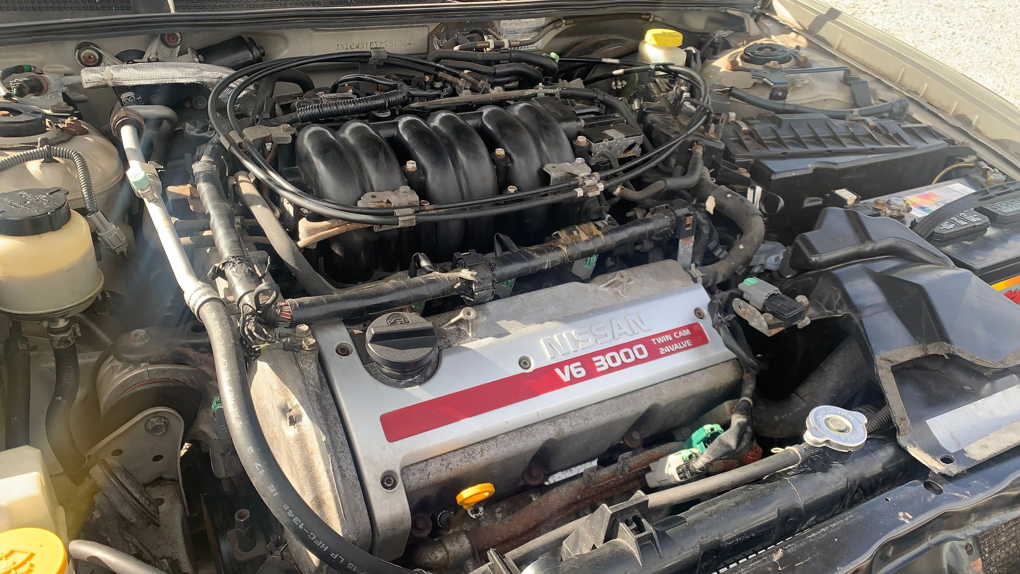

Hello everyone this is my first post here on the forum although I’ve been lurking and taking tips here and there from people and would like to share some things and also learn some things I have a 2000 Nissan maxima vq30de automatic I got for 800$ and it had some issues
(idle air control and a leak in the hose next to the iac unit which was a coolant hose. the motor mount was barley on so when I drove the whole motor would shift and move and cause the transmission to slip so I bolted the mount and that stopped the slippage but it was still shifting funny and the transmission vent was plugged so I bought an aftermarket transmission cooler and that made it shift way smoother and my tranny stopped seeping oil)
Now I wanna manage the car and do some things like mabye learn how to tune with it and find some aftermarket headers to mabye throw on or put bigger injectors or try the apexi safc2 on it but I need to know if its worth it for an automatic for one and 2 I need good new sources and links the car is completely stock so if you have any ideas of any upgrade I should do first let me know I’m also on a budget
