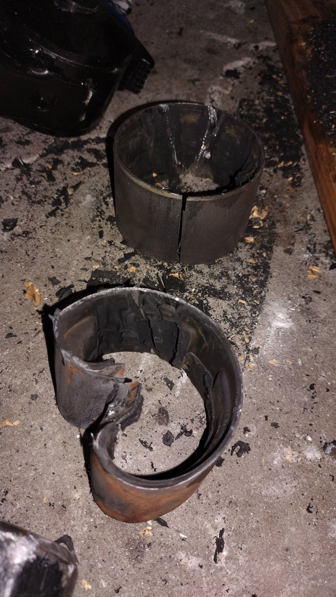

what I do with the old bushing is drill a bunch of holes than remove them than use a saw to cut the sleeve. out. if your interested I have an extra set of lower mounts already prepped to have bushings installed..
this is how the bushing sleeves look when they are removed from the mount

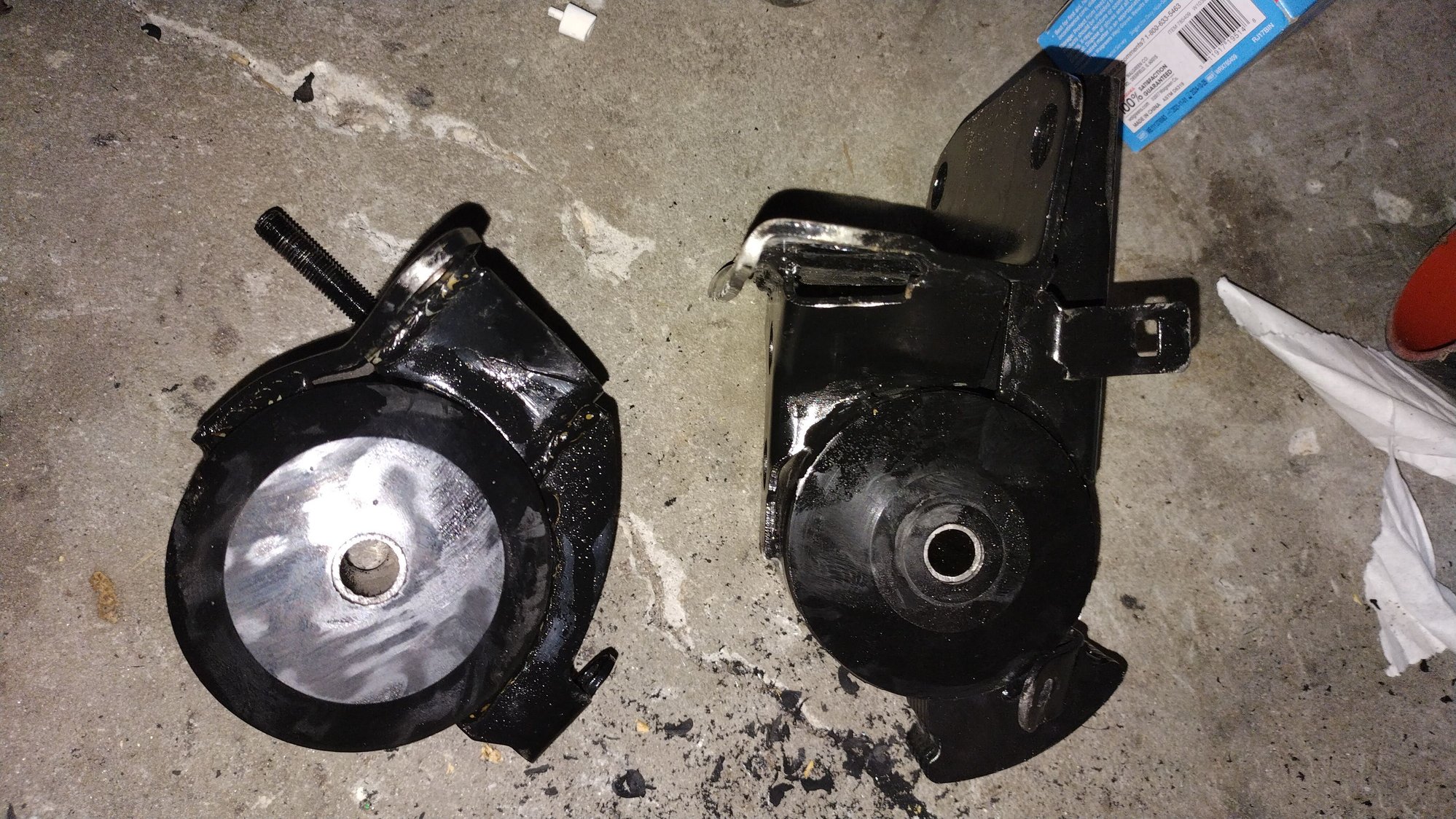

these are my lowers with energy suspensions inserts. these have to be pressed in.
this is how I press the in
these are my upper mounts with Nisformance inserts. they are 2 piece bushings and don't have to be pressed in. they also make lowers but i didn't know about them until after I got the Energy Suspension ones for my lowers. the energy suspension ones also have lifetime warranty... I have all their suspension bushings installed on my car also.
