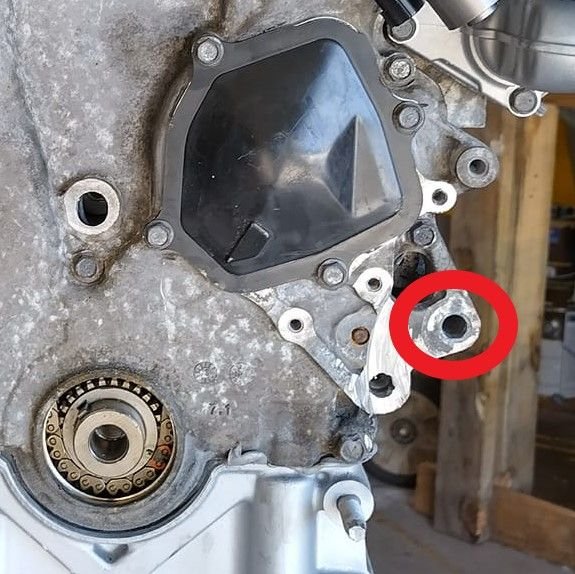

the Nisformance site has the guide ( https://www.nisformance.com/Articles.asp?ID=252 ) and they sell all the stuff needed for the swap.
the only thing the guide doesn't mention is spacing out the alternator. I used 3 M10 washers stuck together with RTV on the lower front portion of the alternator mounting location to align the belt..
location where I put the spacer...
spacer made with 3 m10 washers and stuck together with ultra gray
