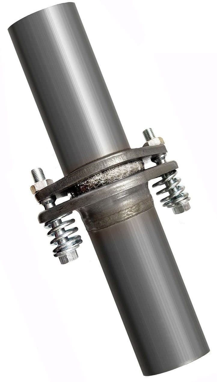

maybe a donut flange would be a better option. I was going to go with one next but the last flex pipe I had installed on my Warpspeed Y has been doing ok.

back when I had my 5 speed V6 Contour they used a donut flange and it never gave me any problems, same with my CRX and all the 90's 4 cylinder Hondas...

Hmmm. Does look tempting. Looks like it would give a tiny bit of way vs haveing flange up without the donut. I'll look into that option. Thanks!

the donut flange is able to rotate on the donut and the spring keeps pressure on it so it seals really good. it's also easy to change the donut if it ever goes bad. the donut flange on my CRX never gave me any problems. even when the old rusty upper tranny mount bracket broke and the engine and tranny sagged real bad.

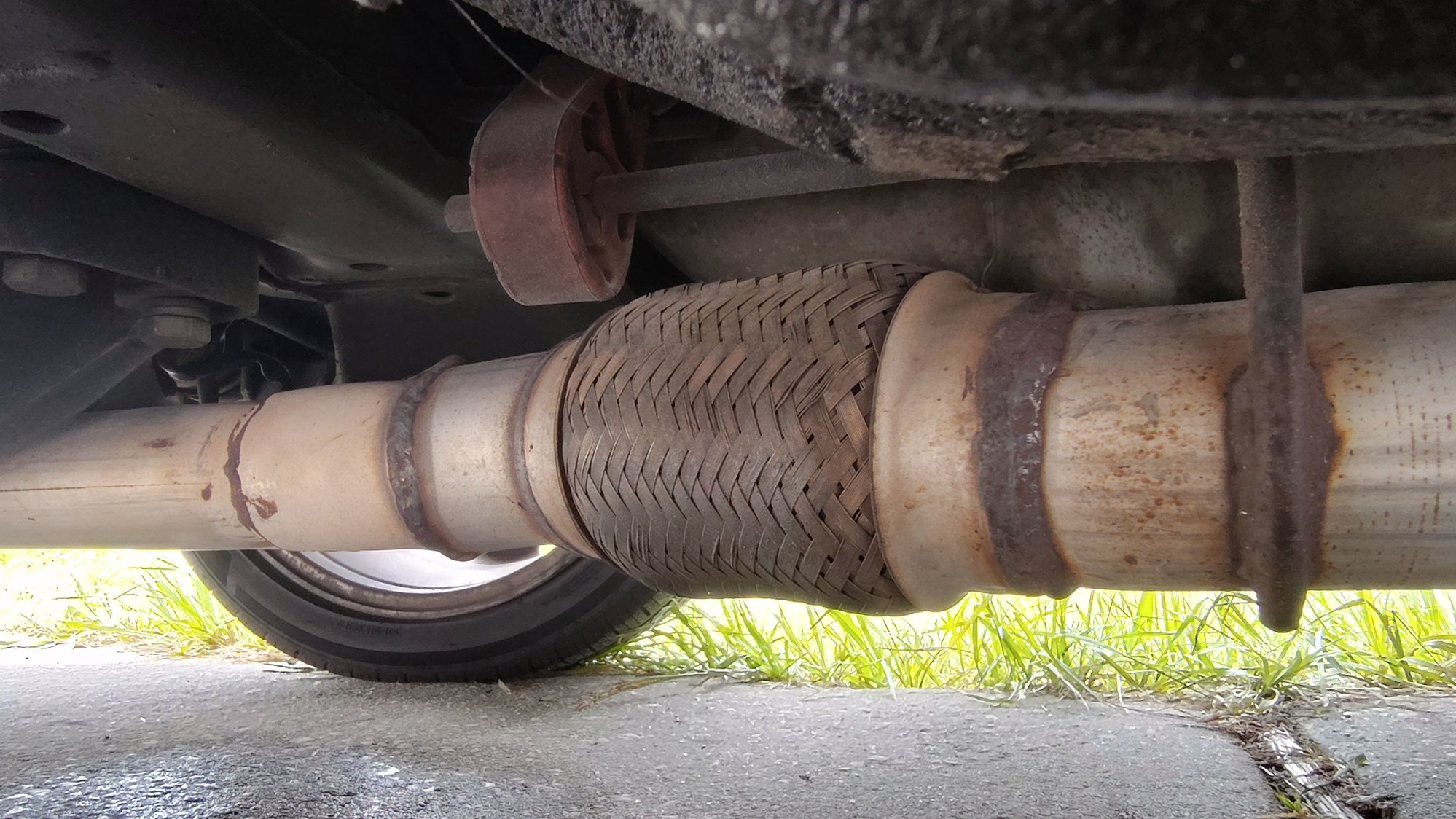

here's a pic of the second flex that was put on my Warpspeed Y and I guess couldn't handle the heat, it collapsed internally..
Wow, it collapsed allright!
I went with another Y pipe from RockAuto, cheapest and easiest thing at this point. I installed it over the weekend. Next year, I'll hopefully be welding my own pipe. I'm on a mission...
