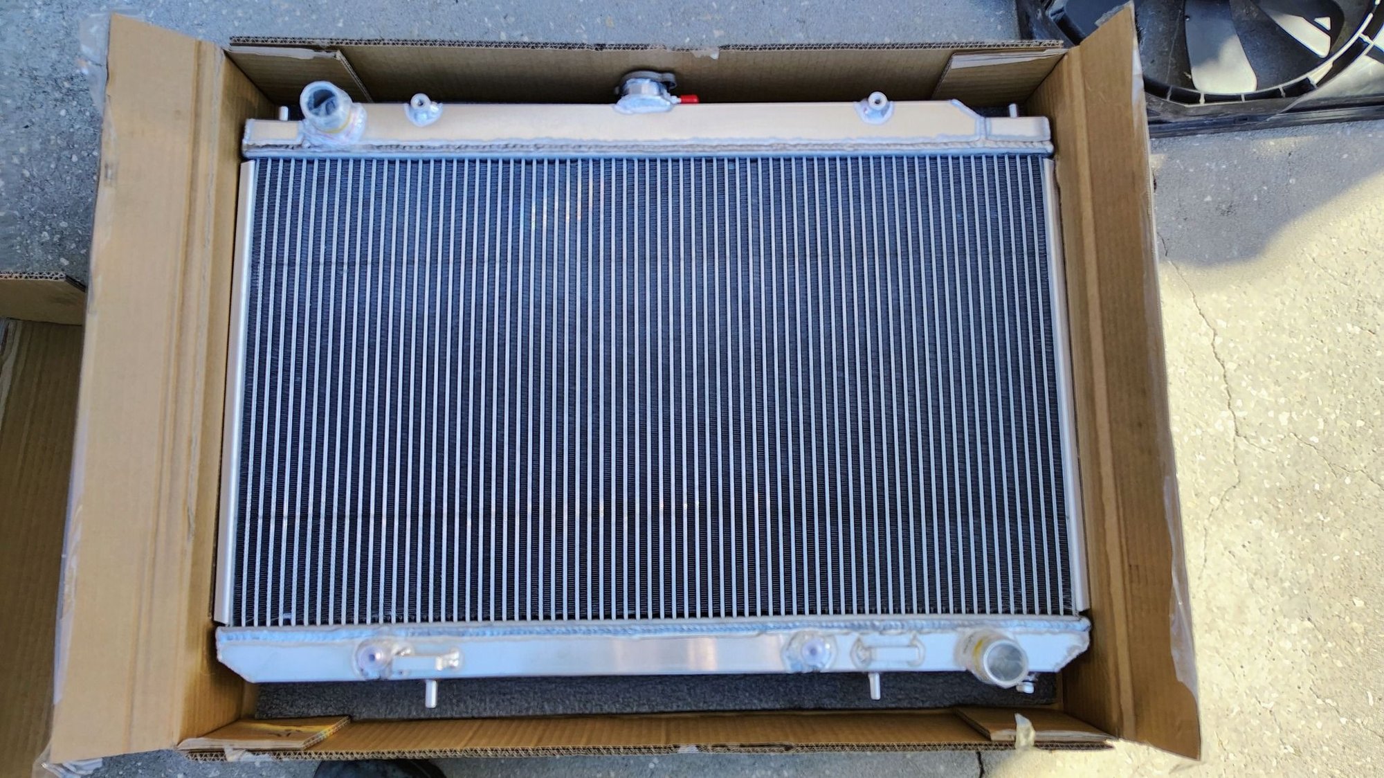

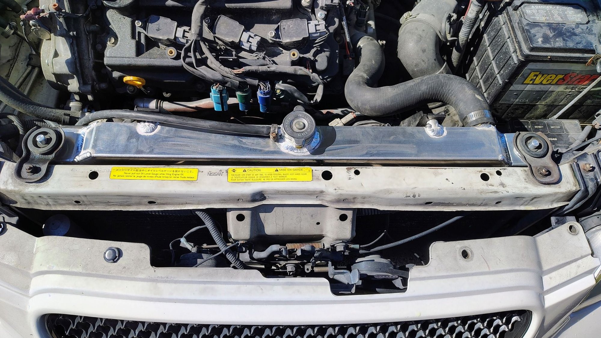

so I installed an all aluminum radiator today that I got off eBay. only paid $136.53 with shipping and taxes. it actually fit good with the exception of the lower shroud tabs that had to be filed down. the upper shroud bolts weren't included, luckily I already had some M6 x 1.0 x 12 screws left over from something else I was working on.

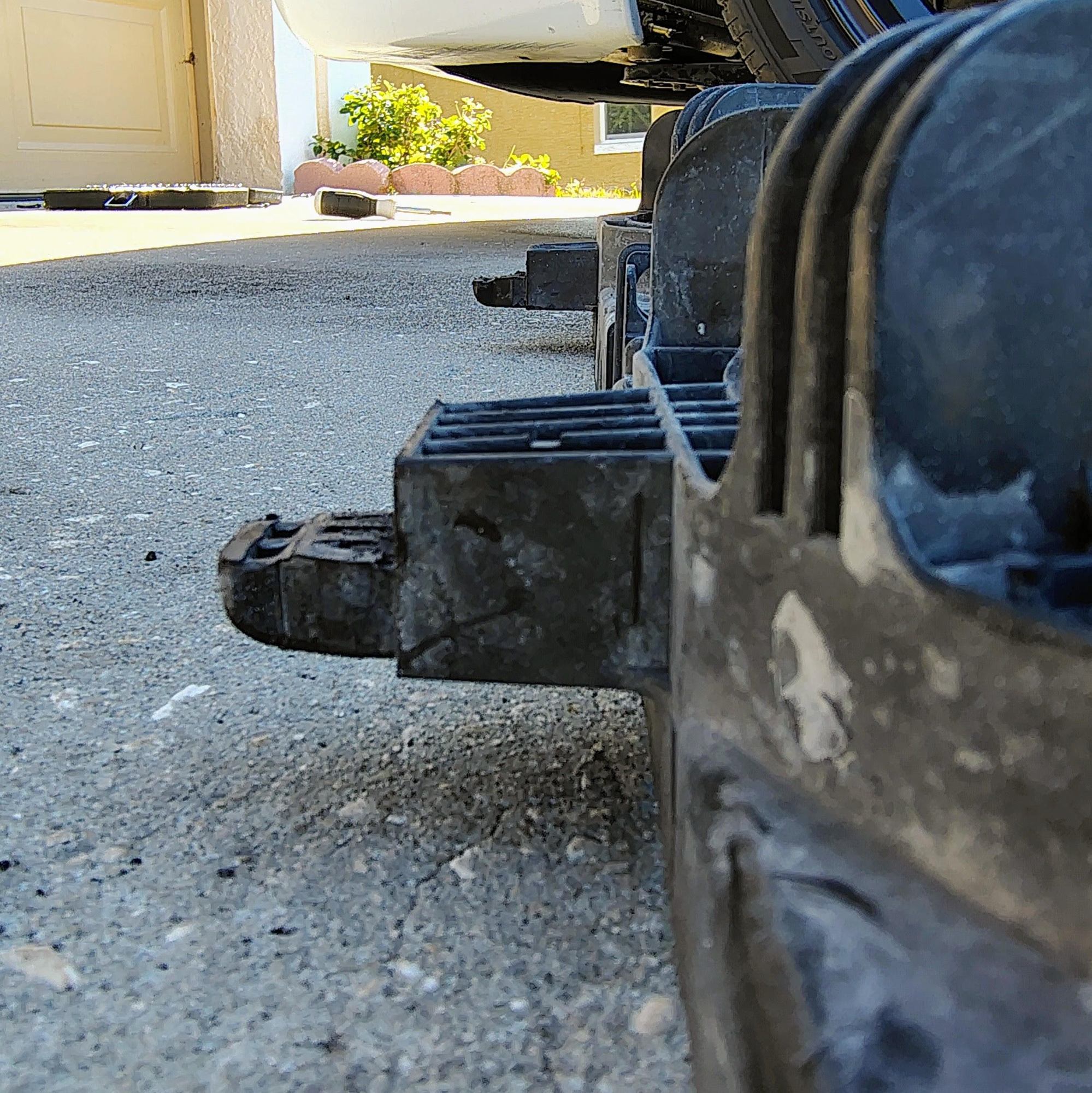

both lower tabs were filed down

I had to tighten the hose clamps really good on the radiator end of the hoses. I noticed I had a leak when the engine cooled off but no leaks while running, the hoses are a little over a year old. everything is ok now that I tightened them real good. .
