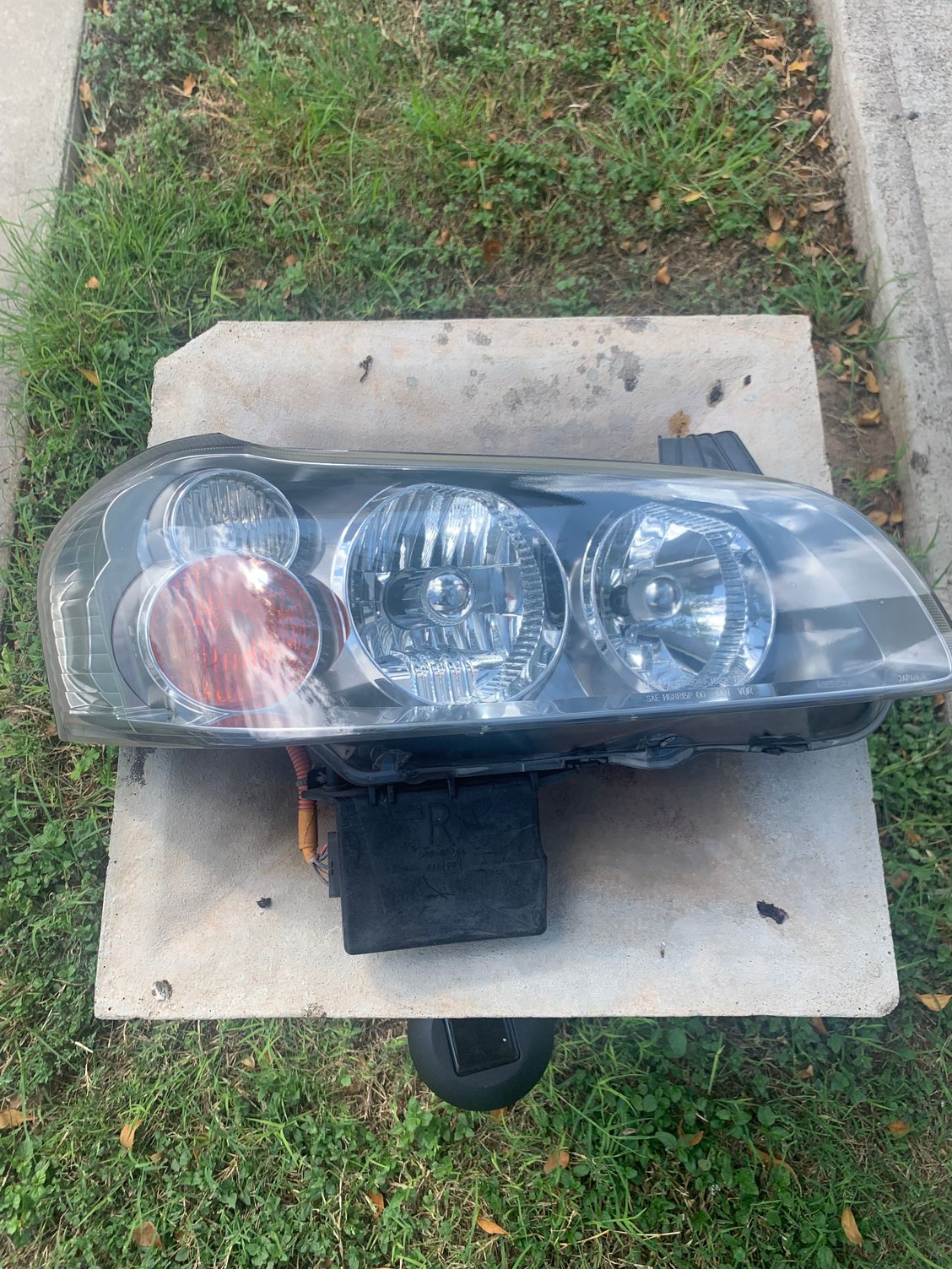

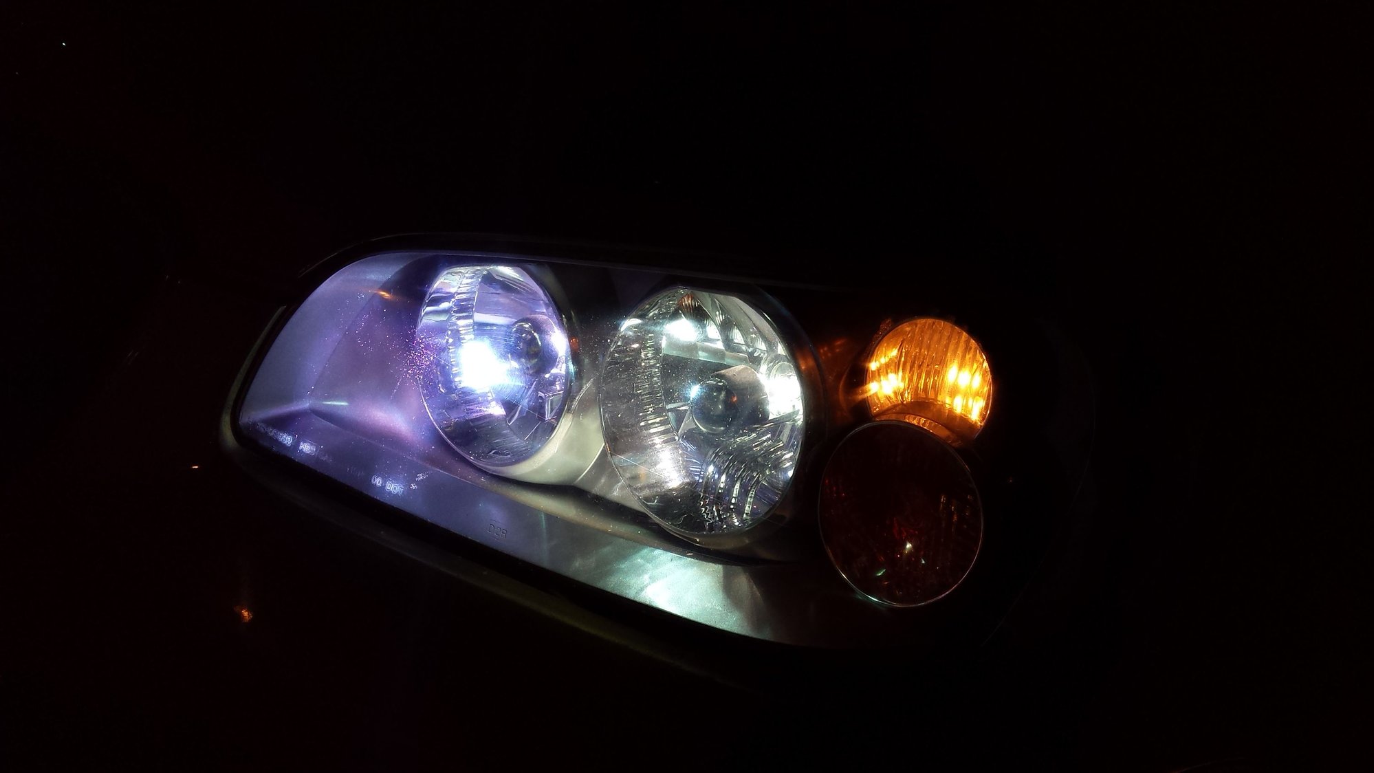

How bad are they? I polished my cousins old lights. I had him clear coat them after.

looks great ! what polish? i still use Meguairs plastix as preventative maintenance on my current car. and always used it on the maxima every couple of washes.

Various grits of sandpaper, probably 400 working up to trizact 3000, then rubbing compound.

damn nice! the legit way to do it.

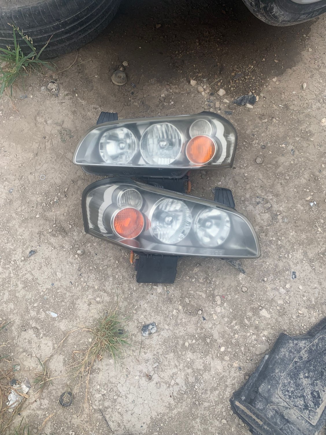

This is how they looked finding them in the salvage yard! Actually not that bad!

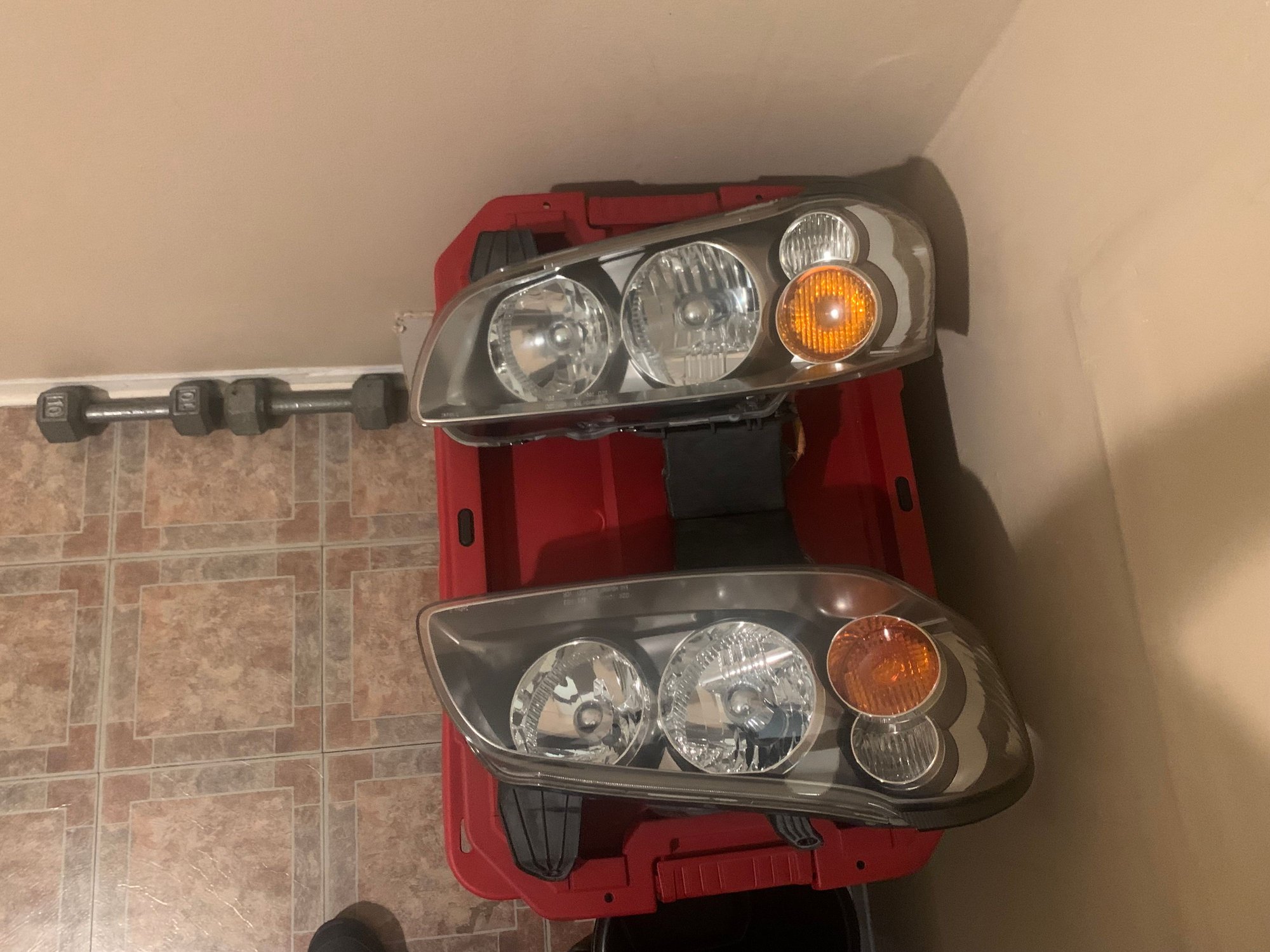

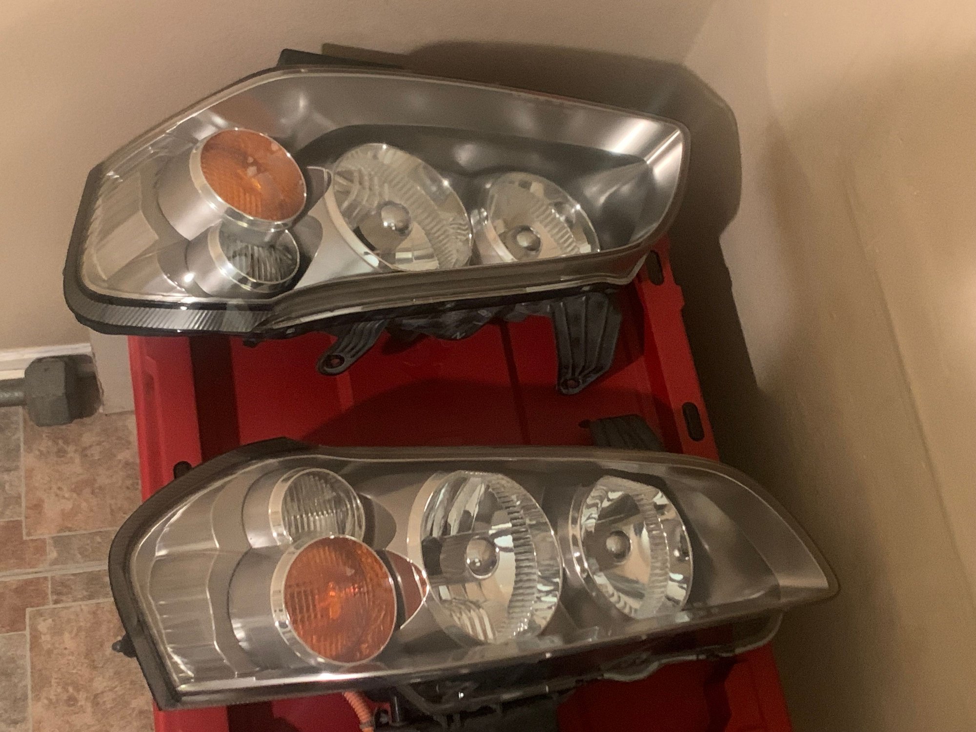

Here’s the same headlights after clear coating them…
After clear coating
After clear coating
Outside light after clear coating…

Any particular cleat coat to use? I assume one designed for UV protection.

I’m not sure what brand the paint shop used but yes it was UV rated…He was spraying a front facia or hood.

You can get 2K clear in a can. It's 2 part with a button on the bottom to mix the hardener.

Yes the you tube video on this thread used Eastwood 2 part UV rated clear…
