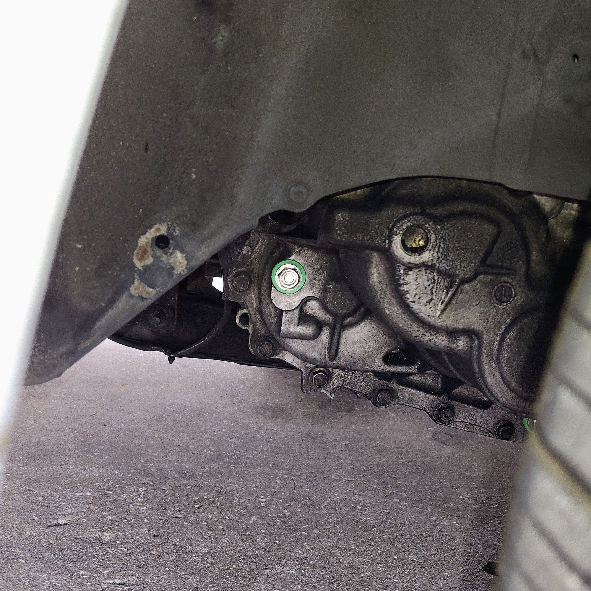

just cut the wheel all the way to the left and the fill hole is right there. I use a funnel with a tube. I change my gear oil every January. I also went with a drain and fill plug bolt off a Volvo since I hate Allen bolts..

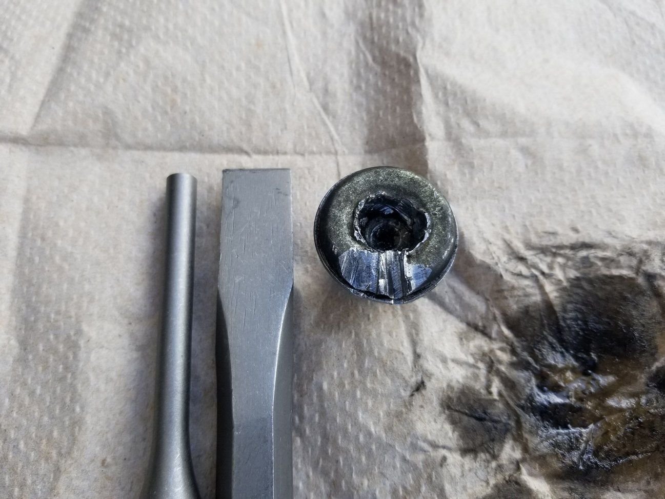

What Volvo did you get them off of? Those T55 bolts are pissing me off right now. I'm not going to put them back on after I change the fluid out. Also, thanks for the tip. I have a lot more room than I thought I would when I turned the wheels all the way to the left.

Funny, I've stripped a couple Allen's on my new to me '06 and have been replacing them with proper bolts from PYP yards 🤓

just go to eBay and search for Volvo M18 x 1.5 oil drain plug. it's also longer than the OEM Nissan plug so it puts less stress on the threads. If you noticed in the picture, I started using green synthetic fiber washers to also reduce doing damage to the threads on the transmission case. mine had a few threads pull out over the years but these longer drain bolts were a big help. I also had drain plug issues as seen in the second picture below...

Thank you very much! Yeah, I know eventually that's what's gonna happen to mine if I keep using those T55 bolts.

I believe the OEM drain and fill plug is a 10mm allen. a regular flanged hex bolt is way better..

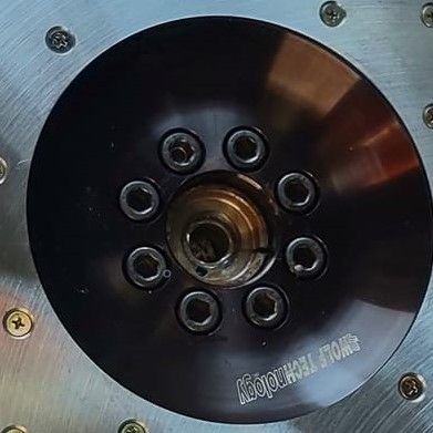

allen heads have a tendency to accumulate dirt so it's best to clean them out before putting a bit into the head for removal. I never liked allen bolts and I hate torx bolts even more. I actually ditched the torx bolts on my flywheel for allen bolts
true. i used to feel that way until i got seasoned in the shop. now i love them. triple square (xzn) can suck my ***** though.

I've taken them out three times before and It's a pain in the *** every time. I ordered those other bolts from ebay and they should be getting here on Monday. Got some Redline MT-90 a couple weeks ago. The guy I bought it from about 4 years ago put ATF in the transmission instead of gear oil and I drove it for 5k miles until I realized it. Hopefully the MT-90 helps it out until I can either rebuild it or find another used one. *sigh*
