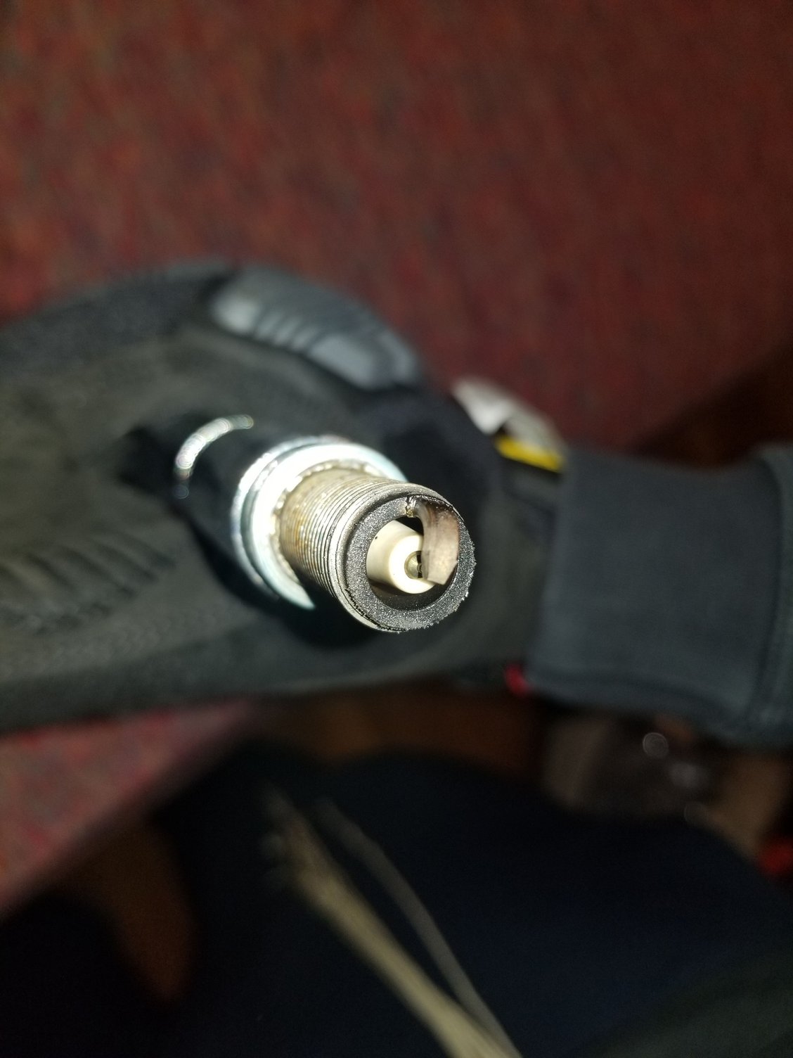

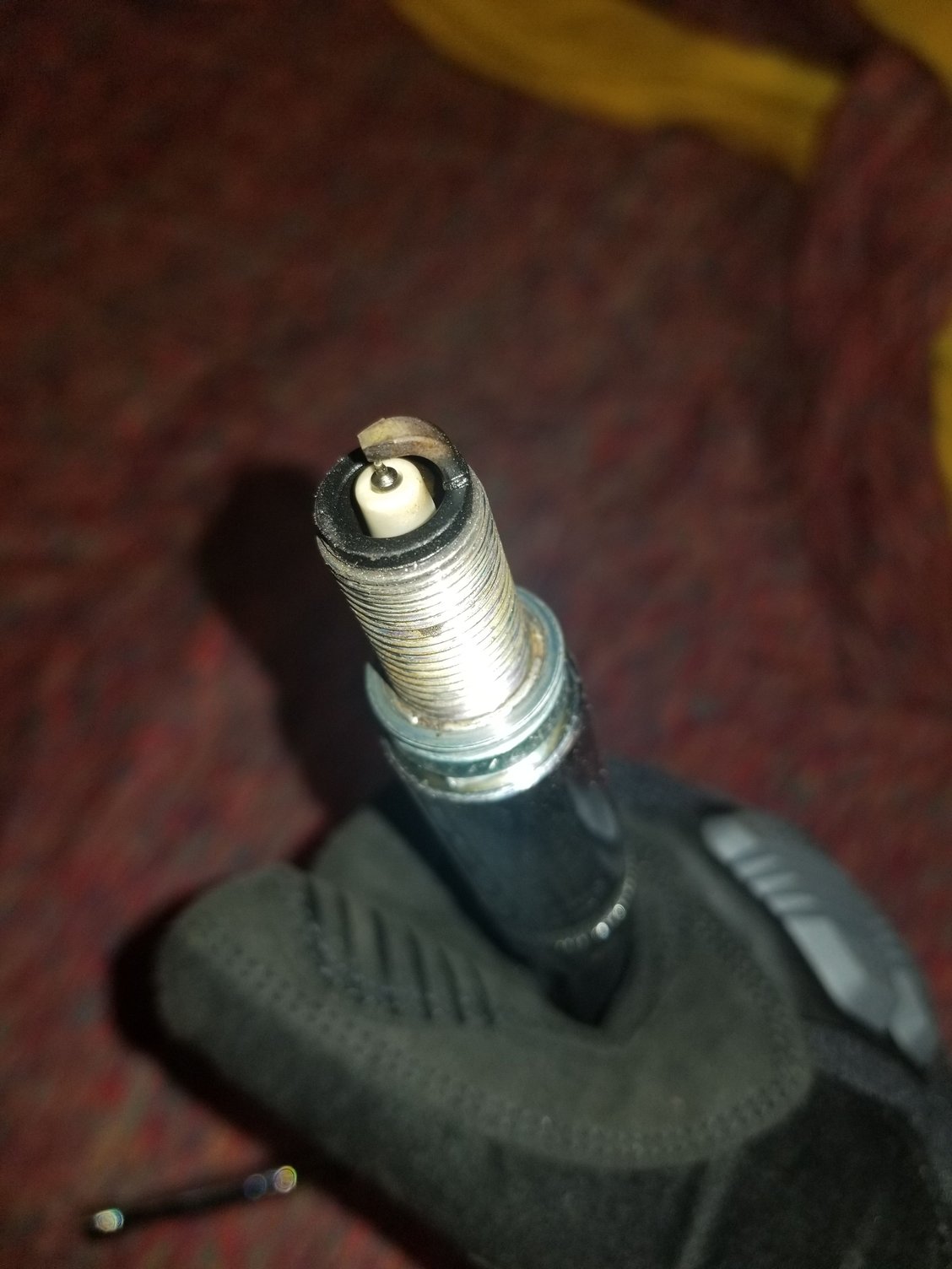

My 2008 Maxima SL is fully stock.
It has 125k miles and I noticed a rough idle, so I decided to change the spark plugs.
Once changing the spark plugs, I decided to change the coil not boot (and spring) as well.
I changed the list plenum gasket. This took me 10 hours - every !#*$& screw/hose/clamp gave me trouble. I also didn't have the proper tools for this job with this car (since there's no space anywhere) and this caused everything to take longer.
I bought the parts in rockauto, they recommended the NGK LFR5AIX-11 as the OEM replacement, so I got that.
​​​​​​The spark plugs that I took out were actually the DILFR5A11, which is what I later saw that the SM calls for. (Incidentally, Amazon incorrectly claims that the DILFR5A11 does not fit my car.)
when I started my car again, I immediately got a few codes, which I cleared. Two of the codes were p0223 and p1217, I'm not sure what the 3rd was. Not sure if this matters, but at one point, I pushed the butterfly valve of the intake with my finger just out of curiosity.
I drove the car for a mile (prob made it up to 30 - 40 mph) and all was fine. The next day, I drove it to work - around 10 miles. After 9 miles or so, I gave gas and it took a second to register, but once it did, I was driving ~40-50 mph A mile later, at a red light, the car started idling very roughly. After I turned, it started jumping very roughly (I'm gonna take an uneducated guess that everything was misfiring) and was just getting worse. The tachometer was bouncing up and down, I barely rolled into a parking spot at work. After work, I cleared the codes and tried driving again, but the car was really jumping. Then I started hearing popping noises from the engine area, so I pulled over and towed the car to the shop. At this point, the car had a p1217.
when the mechanic got around to looking at the car few days later, it wouldn't start.
He told me he took the spark plugs out and put them back in and the car started working again. He didn't see anything wrong.
After paying $265 for nothing other than labor, I decided to check for pending codes before starting a 70 mile drive. I found p0113 and p0300 pending and I brought the car right back into the shop.
​​​​​​​Any clue as to what went wrong?

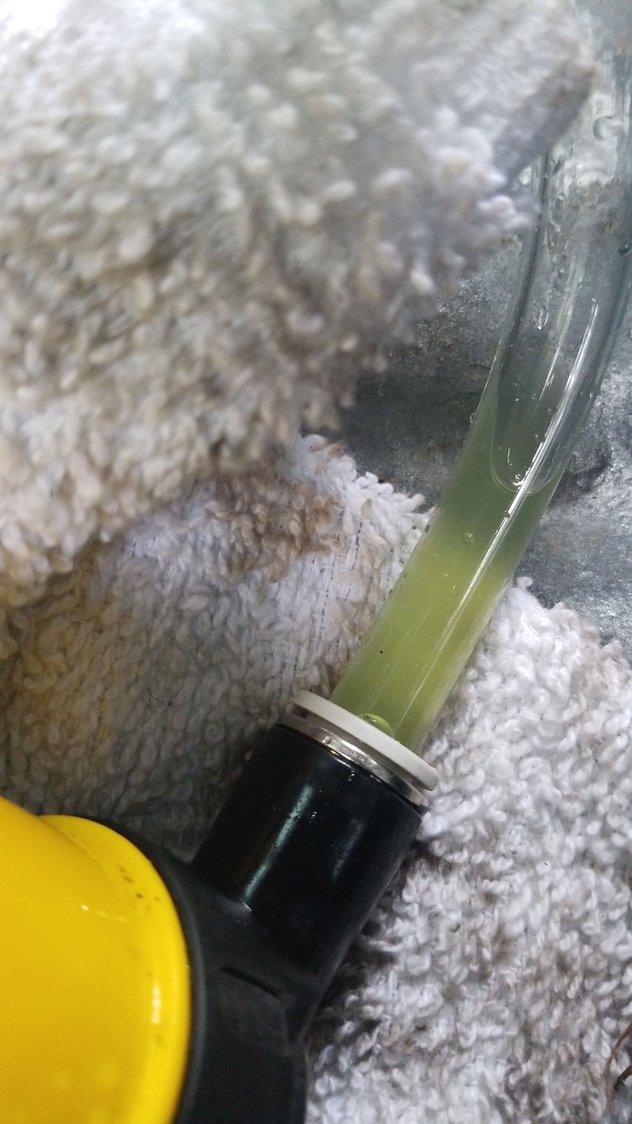

I didn't take out the back spark plugs yet. I lifted the back seat and pumped out all the gas. Found what appears to be antifreeze, that would explain everything. I really don't think the spark plugs themselves were the issue, although perhaps they got mucked up by the coolant.
​​​​​​I didn't get every single droplet of gas, there was still a few ounces of gas left, some of that was probably coolant.
I added a 4 gallons of gas and a bottle of Iso-Heet.
When I started up again, it was still misfiring.
This is one of my brand new plugs (#6) after 20 miles of driving. (I didn't take out the others yet.) I looked into the bottom of the cylinder and it looked pretty dirty.
I'm thinking that I should change the fuel filter before trying again.
Anybody have any thoughts they want to share?
