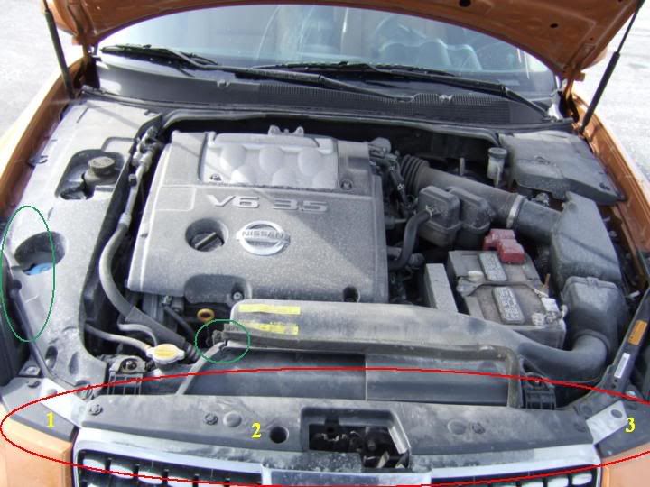

Thank you all for the useful comments. Here is a link to a bigger version of the picture showing the engine bay. From what I remember, I thought it was road salt, but it seems strange to have so much salt in there.

The motor also looks suspicious to me. I can't really spot anything wrong. It just has that "I've been living in a body shop for a long time" dusty look to it. Which makes me wonder. Combined with the tore up fender liner, I'm very suspicious of the front end of that car.

1. Some cars in front end accidents will be brought to outside tow yards and left with their hoods open because they cannot close, thus the extreme amount of dirt and rain drops spots that is evident in the whole engine bay except:
2. The front "red ellipse" area seems worked on, thus all the whipped down areas from parts that may have been removed, whipped down and replaced.
3. The "green circled" area on the air intake duct looks cracked in the corner, like the car took a passenger corner shot to cause this.
4. The left "green ellipse" is the cover I recommend removing and get a good look in this area for spray paint, bent brackets, cracked paint, bondo or things that have any indication of body damage.
5. For the money you’re going to invest, bring someone with some level of car body expertise to exam it.
6. Now with that said, well-repaired exterior structural damage isn't bad if fixed correctly, we just want to ensure you are well aware of this prior to purchase, get the best price and are happy with your decision.
7. Carfax is OK, but it's NOT the holy grail of a cars history.

Sorry for the grainy picture, things I feel are suspect include:

I'm no expert but by looking at the picture of the engine bay and the stuff that's broken, I'd say the car has been in a front end collision of some sort. Maybe nothing major but stuff in the engine bay shouldn't get broken due to normal wear and tear.
Hey, my car has never been in a collision or under water and my engine bay is as salty as that at times...I also have had plenty of broken and missing pushpins caused by me replacing the pass. side bulbs (you all know how you have to rip off the plastic cover) I had to remove all those pushpins for the trenz install....broke a few, and never replaced the top plastic cover. Now my car would render itself just as suspect as this car...even though its never been in any accidents, gotta make sure not to jump to conclusions in your assessment.
The corner of the air intake circled in green is exactly what mine looks like. That is simply the glued foam seperating from the plastic snorkel, due to rain/salt/snow/wind.
Thanks for the careful analysis, and I will definitely go to the seller and take off the plastic panel.
