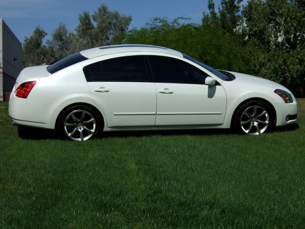

Here is a technique I used to raise the rear of the vehicle to get better leveling.
I used 2 1 inch spacers and tied them on with tie-wraps.
I then removed the bottom rubber piece and placed it on top of the spring.
This was very effective and did not change over 1.5 Months in level and did not have any irregularities. Seems to be reliable.

Posts: 619
what size are those wheels?

Posts: 804
18 by 8 wide

Posts: 1,207
Thanks for the info. Are those H&R's all the way around? Pretty even drop.
Are you running factory struts or aftermarket?
Old May 10, 2007 | 07:14 AM
coolmax05's Avatar
Joined: Nov 2006
Posts: 804
The spacers are good as new after 1.5 Months.
The Springs are H&R's.
I am running on factory Struts and KYB GR2 rear shocks.
With OEM shocks I can tell you for a fact, this car has better ride quality than a 2007 Maxima.

I've heard the HRs give a good ride but they drop the rear too much. Which was the only reason I didn't go with them in first place. Excellent work on the spacers though, even with the Progress spings my car can seem a little low in back. Especially if you have a sub box, passengers and a full tank of gas.
The 1" spacers....where are they available at and why did you have to tie them on?
For the record here is what my research has shown for the drop on the most popular springs for our car.
Eibach-- 2" front, .8" rear
Progress-- 1.75" front, .75" rear
H&R-- 1.4" front, 1.3" rear.

The spacers are available at Summit racing. Also check your local checkers or autozone for spacers.
I tie-wrapped the spacers onto the springs to make installation easier and to keep them from moving around. Remember, they are not custom and do not fit perfectly. Hence the improvising with the spacers and the bottom rubber piece that I moved to the top of the spring. Seemed like a more secure setup that way to me. And...it worked perfectly for 1.5 Months with no wear or movement whatsoever.
Once again, great for leveling the rear end and allows for heavier people in your rear seat without rubbing.

You can order them from "Summit Racing". From there web-site look up "Mr Gasket". They are about $10 each. Also try your local auto parts store like Checkers or Kragens. They are not made specifically for your car. A little improvising and cutting will be in order and using tie-wraps is a good idea.
They are called spring/coil spacers. They usually raise the car a inch or so.

A lot of people hate the front end being so much higher than the rear end.
To counter this effect rear spring spacers can be used.
Regarding the rear end rubbing-you probably only allow beautiful skinny models in your nice ride so you don't have that problem. For some of us who are less fortunate who end up giving big azz (who did it and why looking) heavy girls rides this problem is "HUGE" (they will be in the back seat). Yes it's times like this that you turn up your subwoofer hoping the rearview mirror will fall off or they just jump out at the next stop sign and subsequently get some walking in. But enough about my problems I've said too much already...lets see, stiffer rear shocks-check, stiffer rear springs-check, higher rear tire pressure-check, rear anti sway bar-check, rear spacers-check. Ok I'm off to pick up my date.
