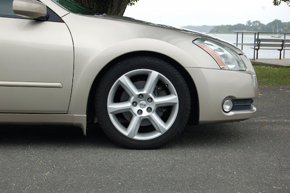

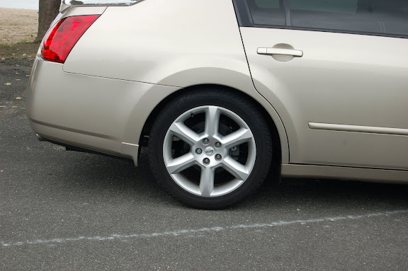

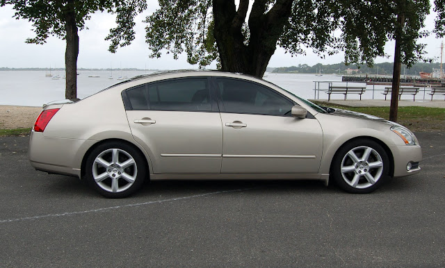

As for the pics, here they are. The drop is very ummm even ... it seems as if the front and back are exactly the same. No rubbing or touching, however I think the bushing that came with the struts is banging but it's not bothersome and only sounds over certain bumps and the top seat on the left side needs to be replaced as someone has told me before and I'm looking to replace that soon.
