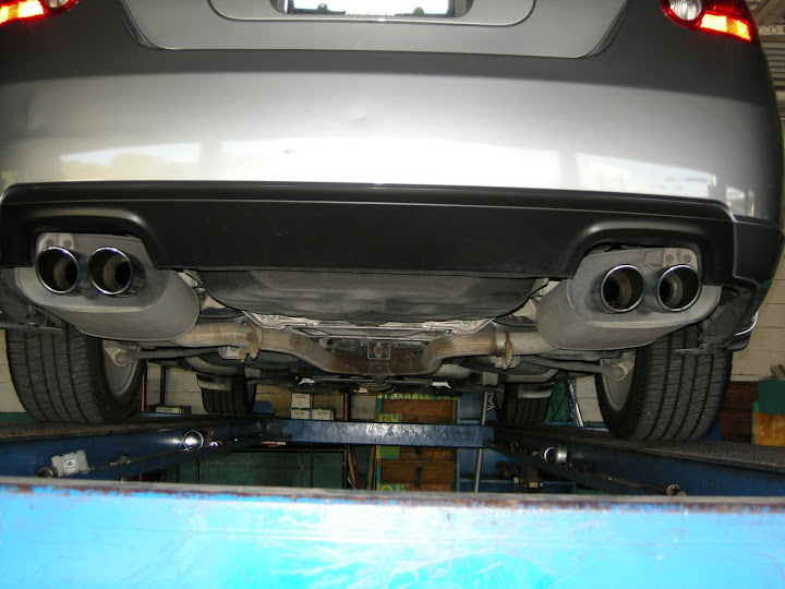

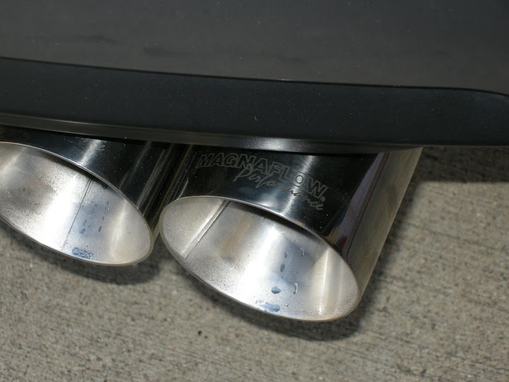

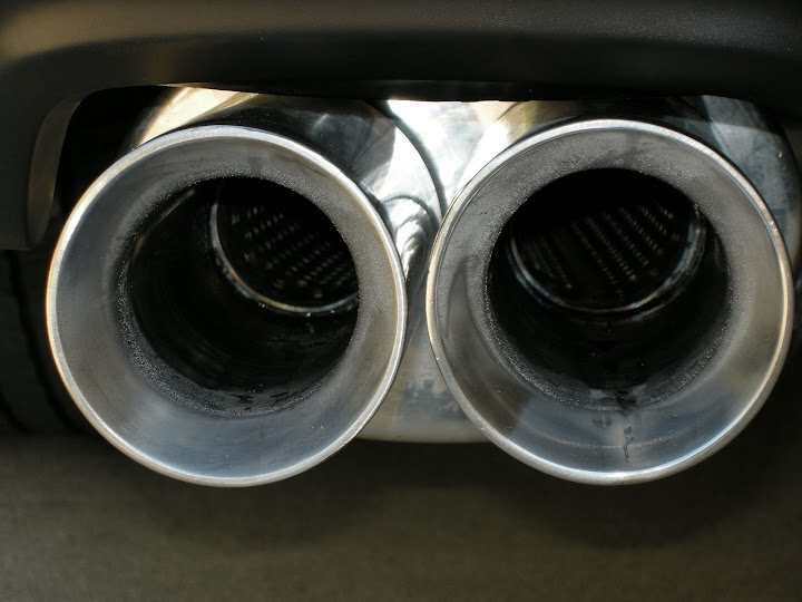

Magnaflow Mufflers #14816 installed. Update, resonator removed
I didn't recieve the mufflers in time to be installed for the Houston Maxima meet but I got them installed Mon. The mufflers plus the Fujita gives my car a totally new sound. It's much a deeper tone, not obnoxious but it will get you notice. The stainless steel looks good too.
The Y pipe should be next although I've been eyeing the LED tail lights for the longest time. A few question from this noob:
Raceline or Cattman ? Which is better?
Removing the resonator will definitely increase sound. Will the Y pipe increase the sound?
Y pipe + CAI =15-20 hp? T or F?

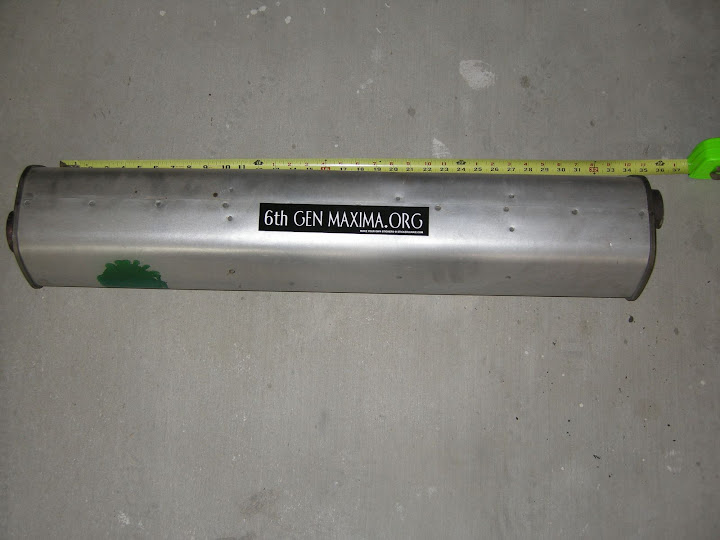

Well I just removed my resonator and just plugged in a straight pipe to take its place. The beotch was a freakin' size of a missile. 3ft. long to be exact. The sound drastically change. It sounds real nice on the outside but it's louder on the inside. I'm still getting used to it. I may or may not put a smaller resonator if the sound continues to bother me.

What's the make and model of that resonator. I am intrested in replacing mine.

I wish it was that simple but the procedure was a little bit more labor intensive than that. I was watching him all the time. Yes he made the cut and No, he did not just tack the new ones on. He had to fabricate the small "S" pipes that connects to the main pipe because those connecting pipes are part of the stock mufflers. You can see it on the first pic where it clamps on to the main pipes. The connecting pipe is cut and bend depending on how far out you want the tips to protrude out. Remember, the Magnaflow came as mufflers only with no pipes. I told him keep the length long enough just to see the laser etching on the tips. And as for the stock hangers they will not work with the Maganaflows. Again, look at the stock mufflers, where are the hangers?...right in front beside the tips. You can see it on the left side of the mufflers on the first pic. No way this would fit on the Magnaflows. He had to tack on a small connecting rod on the side of the muffler so they can be secure. You can barely see it on the right muffler on the second pic. A lot of work for a $100 Do you have the same mufflers as I do?
