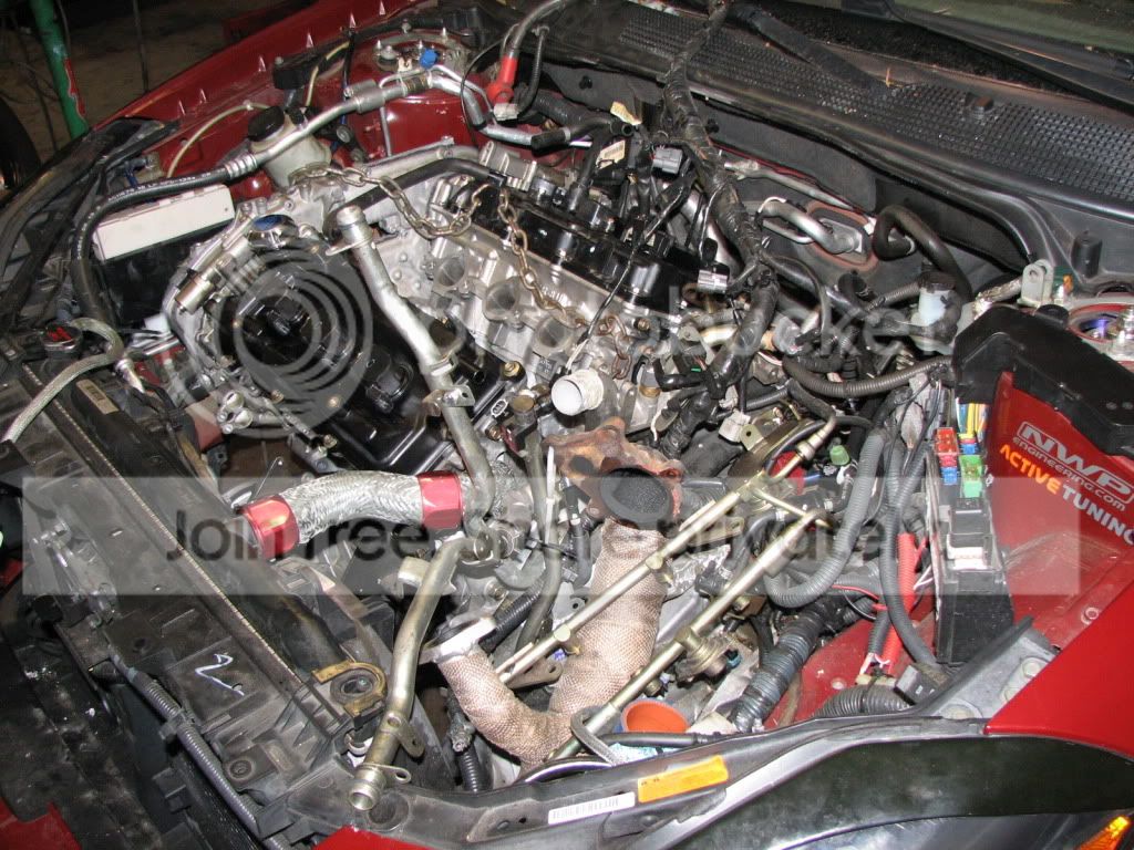

the pic was taken right before it went into the shop , it was a mock up of where the intercooler will sit.
the turbo itself will be mount underneath the battery , GT35
As it stand I wont be doing anything until the tranny is put in its place.
Since were using a 05 Altima Tranny and A33 pedals and swap parts and A34 Axles . it will take some time to get her up and running again before we see #s.
Im not going to post build thread until shes finshed because we know how the .org gets on everyones case on unfinshed projects.

its not the CF hood , We did a few hoods here are some of the pics that my shop does
http://forums.maxima.org/7025192-post40.html
Stillpimpin hood
My cousin 500HP VR4 , still needs a retune to break 6 ... already rape m5 and a carrea
I have vents instead of a cut out,
The goal is to get heat out and not trap it underneath the hood.
As for the informative build thread or what not. It seems to be cover and sometimes everyone on the fourms knows everything and quick to answer things that are misinformative as well.
My guy is from the UK and hes done Numerous VQs and also is a Jenvey Dealer ,hes done that and wrote the book on VQs and as well as ITB setups.
I run thru my build thread with him before I would on here because of the simple fact everyone has a differnt setup and opinions.
He has done a 3rd gen , 4th gen and 5.5 gen turbo. current one he just finshed up is my buddy Stillpimping VQ35
Base on his setup and how he did his and he was a differnt route to try and fit the turbo underneath the battery.
If you look at your head and where the header/manifold bolts on too. you will see the bolts that hold the 14mm in place. if you look you can repostion the bolts, that makes it easier to use the g35 manifold.
I will still be running the downpipe into true dual exhuast setup.. I do not like the way the SFR kit routes the downpipe across the intake manifold. Even with it Jet coat and Heat Wrap , your still going to have some sort of heat asboring back into the intake pipe.
This is where my shop saw the kit in person and now it making adjustments.

OK, Engine is back in and lower accessories are being reconnected. Awesome work and the engine looks almost brand new, lets hope it works as well (insert fingers crossed). So that's the good news. Now for the bad news, when the car was parked outside, 2 idiots were horsing around with a piece of heavy rubber, still not sure what, so when one went to throw it, guess who's car roof it hit??? They will fix it but I'm still pissed because it's more down time on the car...
