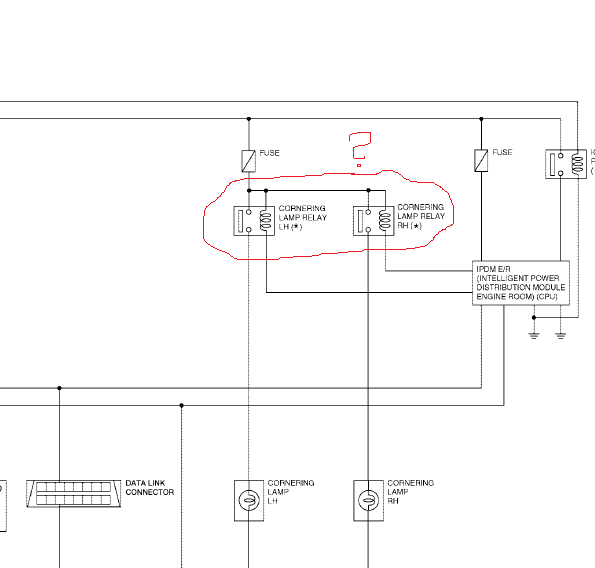

Old Aug 10, 2016 | 05:28 AM
arux's Avatar
Joined: Aug 2016
From: Poland
Hi guys,
I'm looking for some cornering light right relay for cornering lamps.
I have situation that left cornering works ok but on right side i have only turn signal without cornering lamp.
all fuse are ok in ipdm
where i can find it? are the inside of ipdm? in instal schemat of ipdm looks like both are inside
