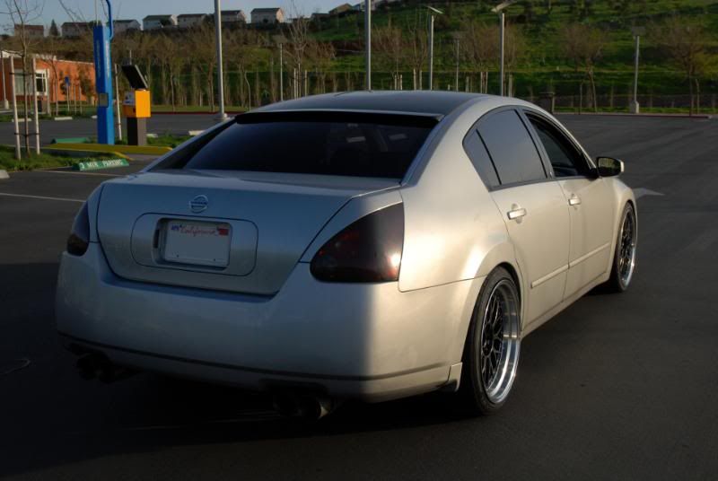

My wheel offset pictures with 10 and 15mm spacers
Old Mar 6, 2011 | 01:46 PM
  #41
n1smojunkie's Avatar
Joined: Dec 2010
Posts: 62
From: Washington

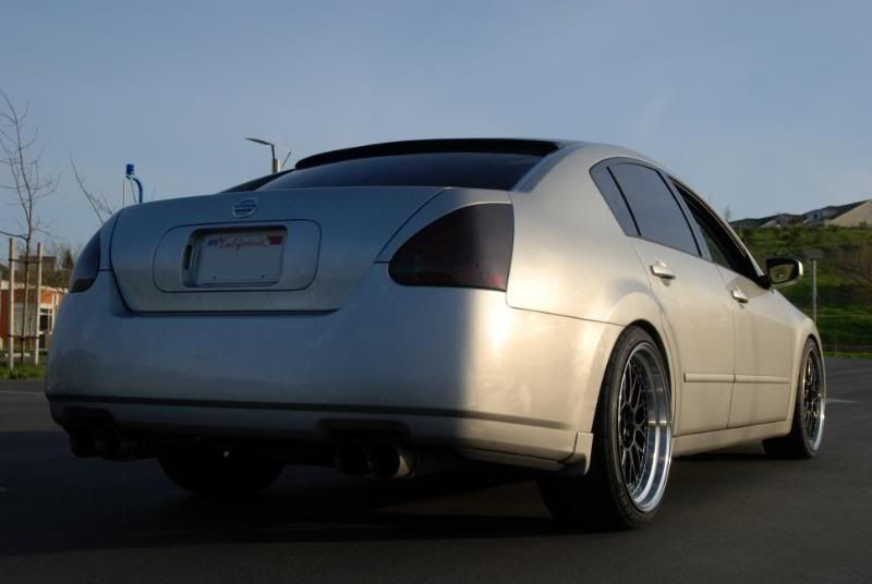

This setup looks great

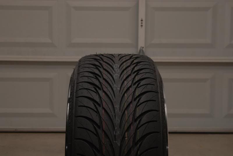

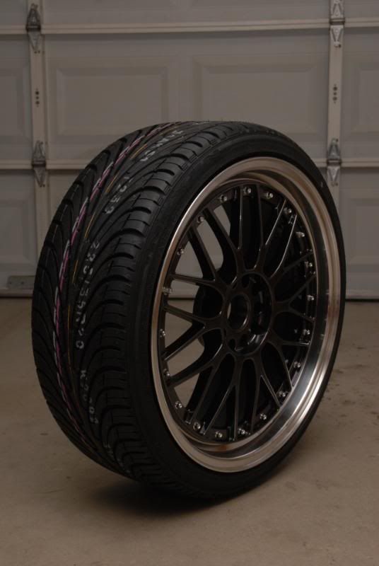

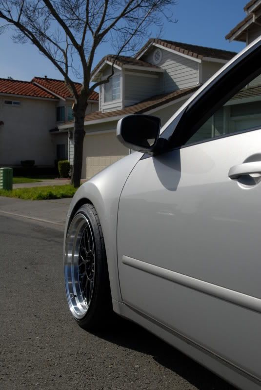

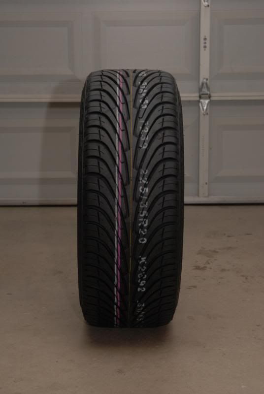

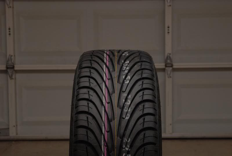

Here is a Nexen N3000 225/35/20 mounted on an 8.5".

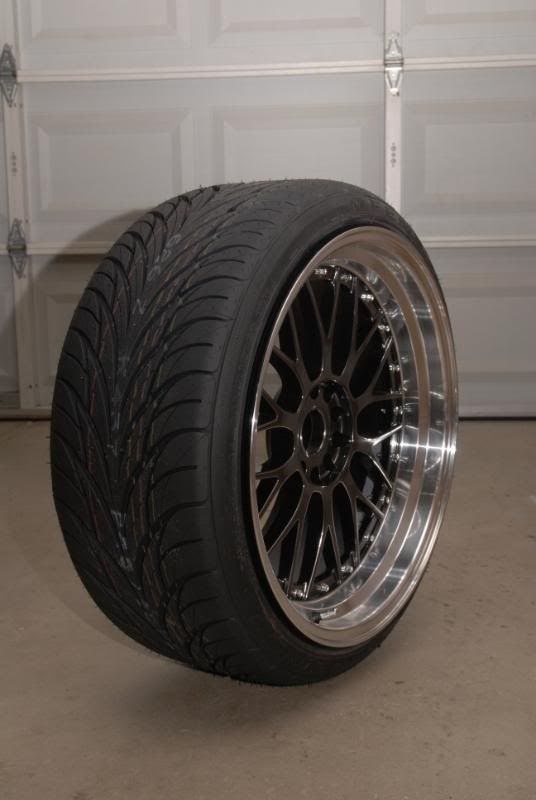

Here is a Federal 595 245/35/20 mounted on a 10.5".

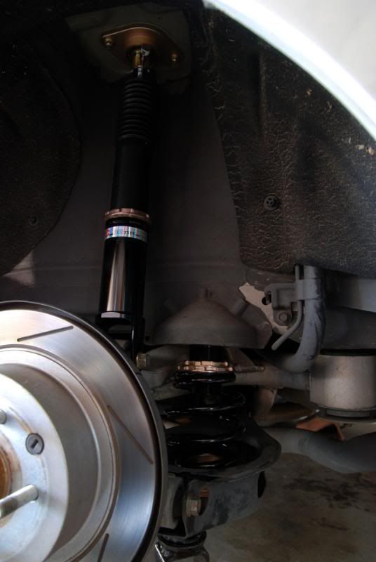

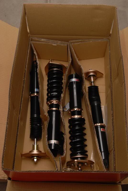

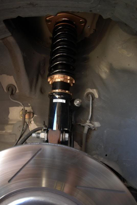

Here are the BC Racing BR Type coilovers.
I was only able to do one side because it seems the nuts provided with the shocks are the wrong size and I could only find one, gotta pick one up in the morning. It was dark so this is the best I could do for now.

That looks hot dude.

It does look good, but hitting 1 pothole is gonna bust that rear bead.
Safety first... lol

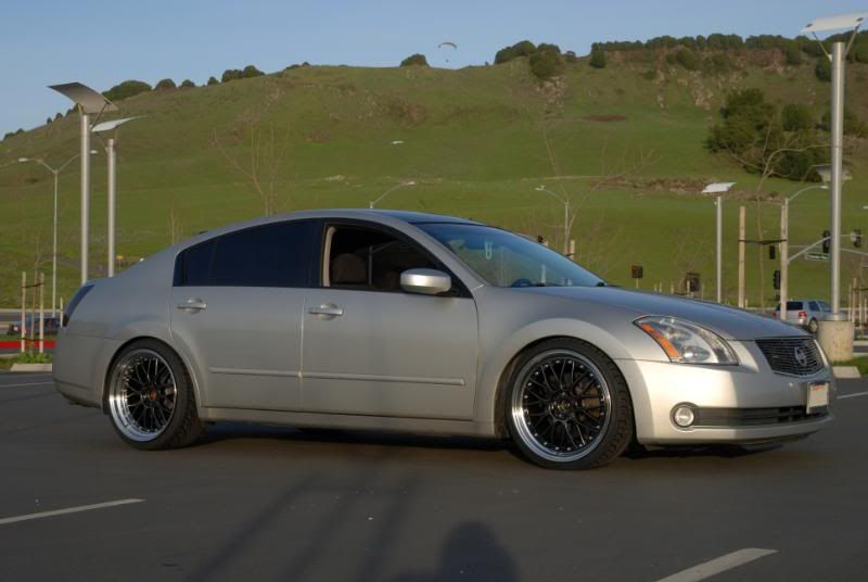

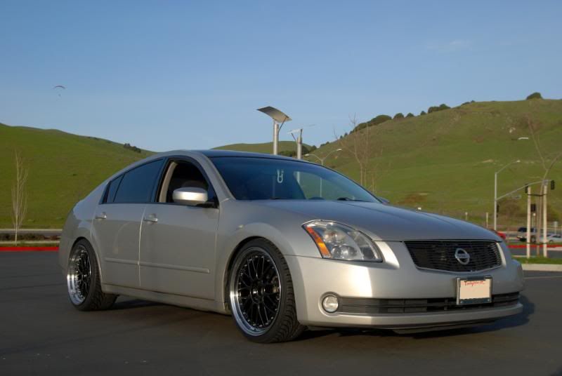

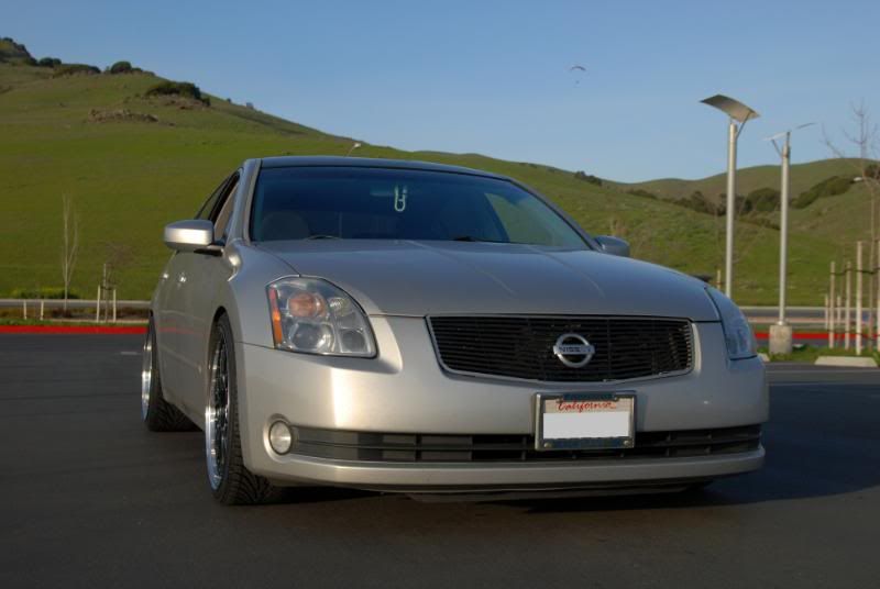

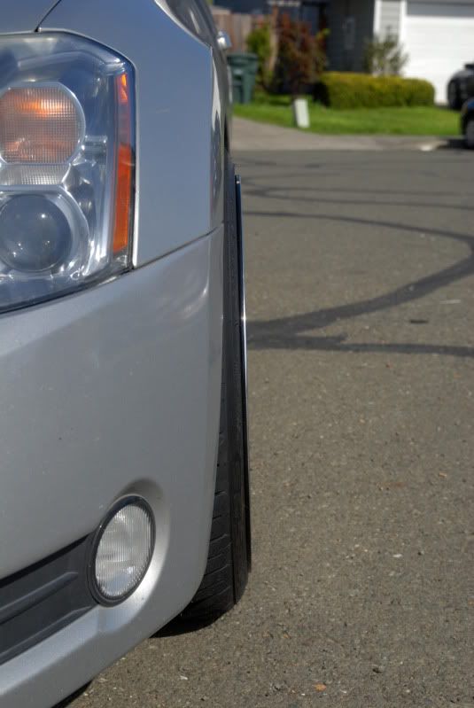

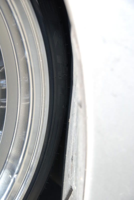

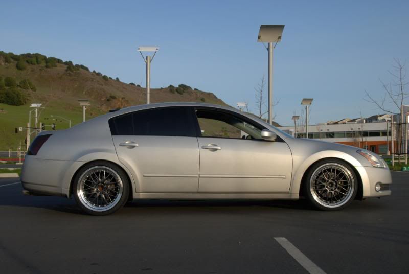

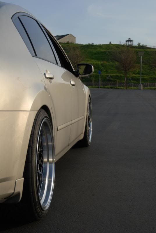

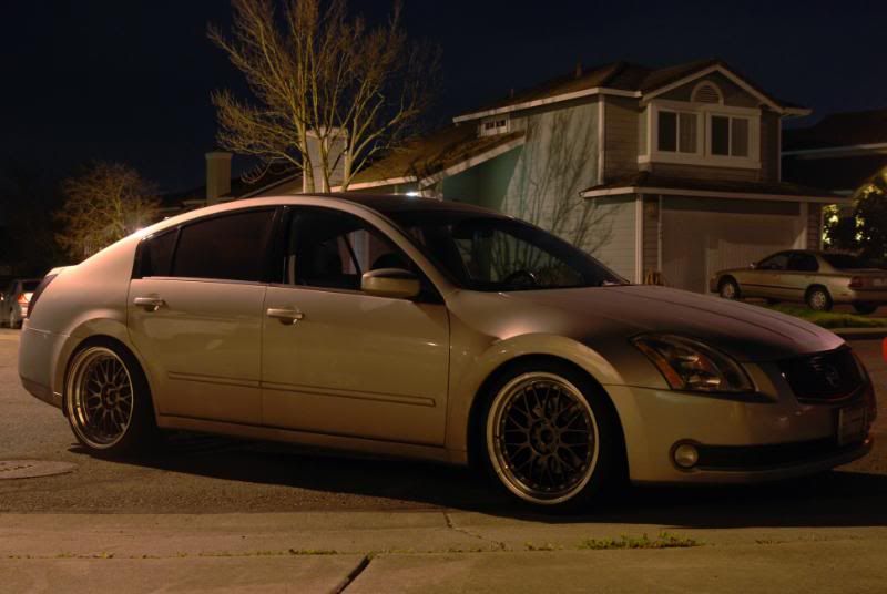

Here are the BC coilovers installed.

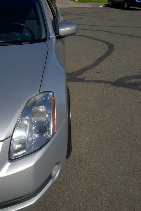

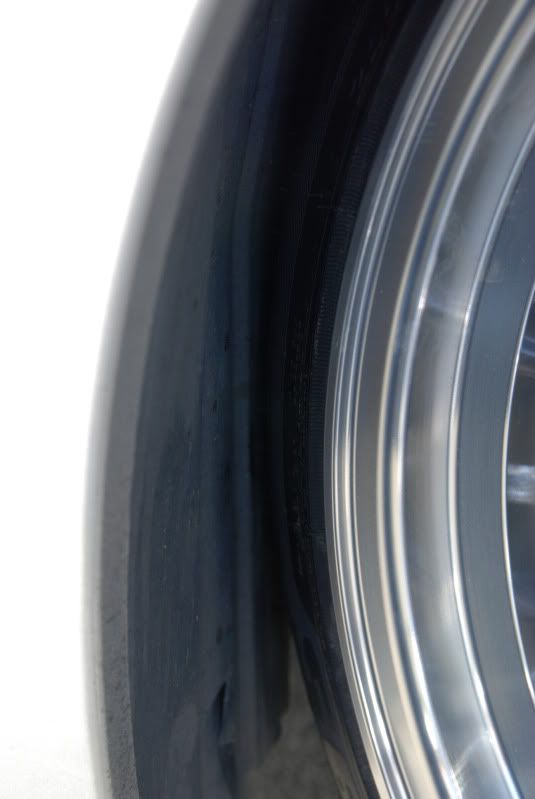

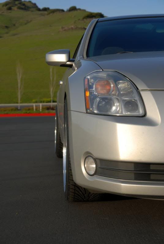

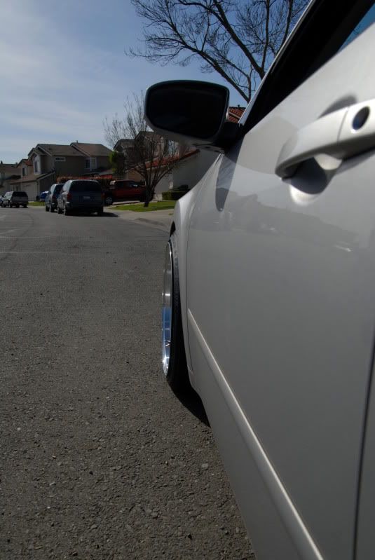

This is for all you guys asking me to put the 10.5 on the front. Keep in mind this is with a 245/35/20 tire and Progress/KYB suspension. It looks like it could work, you just can't turn all the way without rubbing the fender liner (which I'm already doing with the 8.5 and 225/35/20). You will more than likely have to lower more than this and run negative camber. For these wheels specifically, it doesn't look like the center cap will fit if putting the 10.5 on the front.
Rubbing on rear of fender liner, full left turn.
Rubbing on front of fender liner, full right turn.
Center cap not (can't be) installed.

I need to lower the car a bit more, but I'm going to wait until the springs settle, so it'll stay like this for a bit. I still need to modify the rear bumper mount. I've set the dampening to 20 all around (0 is hard and 30 is soft), and so far the rear has not rubbed yet. I hear a bit of noise on turns, which I believe is the front tire rubbing on the fender. I also hear occasional noise from the front on certain dips, which is either the tires rubbing or noise from the coilovers.

looks good. lower it a bit more and some camber and you'll have a badass stance. btw i like your grill. what kind is it

looks good. see, the 10.5 squared set-up would have looked sick
Thanks. I need to deal with my rear fenders before I go any lower. I need to trim the fender liner, get the fenders rolled flat, and modify the rear bumper mount. I'm also trying not to run too much negative camber. My grill is an E&G grill with the middle painted black. I need to repaint it, I might just try using Plasti Dip.
Thanks. While the 10.5 all around COULD work, I don't think it would with these wheels since the center cap can't be installed. And I'm already rubbing on turns in the front with 225/35's on an 8.5, I can't even imagine any tires taller than that with the same drop. Maybe someone who doesn't DD their car can try it.
