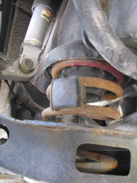

You can do a few things. Speaking outta experience. Its not always necessary the fender rubbing. Wish I had taken some pics. Jack up your car and take off your wheel and look to see exactly where's rubbing. I got 22's on mine and it wasn't the inner fender flaare, it was part of the bumper and the body that was making the contact with the rim.
What I did was shave as much as I could and it gave it a lot of clearence, then I used some rubber spacers that goes between the springs to give it a little stiffness. Then when I lowered the car I had to roll the fenders.
Here's a pic of the rubber bushings between the springs
You give the dumbest advices ever, just stfu, seriously.
I'm no expert, but is that even safe?! It looks very wrong...
