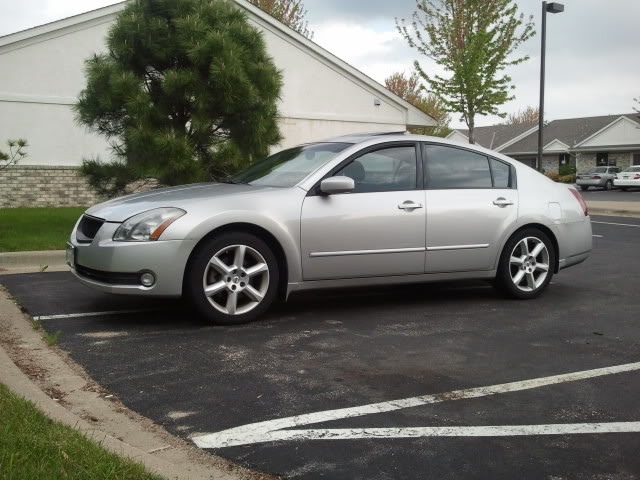

I installed BC BR type couple days ago. I like the look and ride quality. but today right front one started to clunk over bumps at low speeds only. I raised the car, nothing noticeable wrong. Any idea how to isolate sound? did any of you with coilovers experience clunking sound.
Some pictures of before before and after install.

After:
