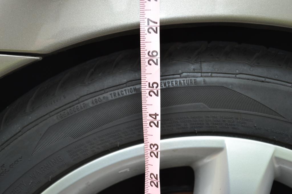

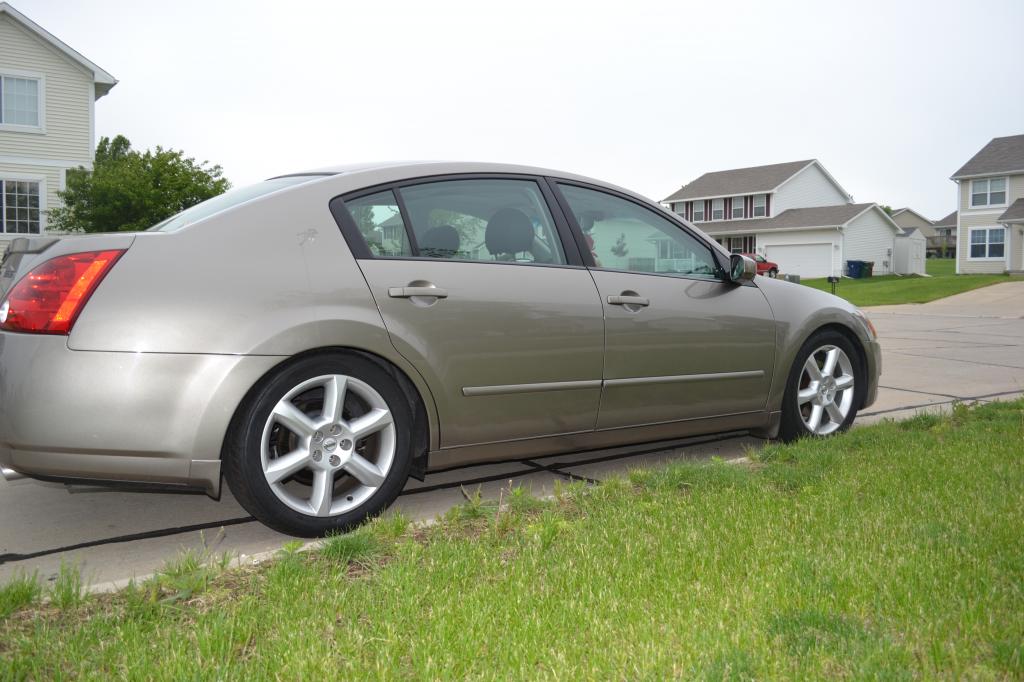

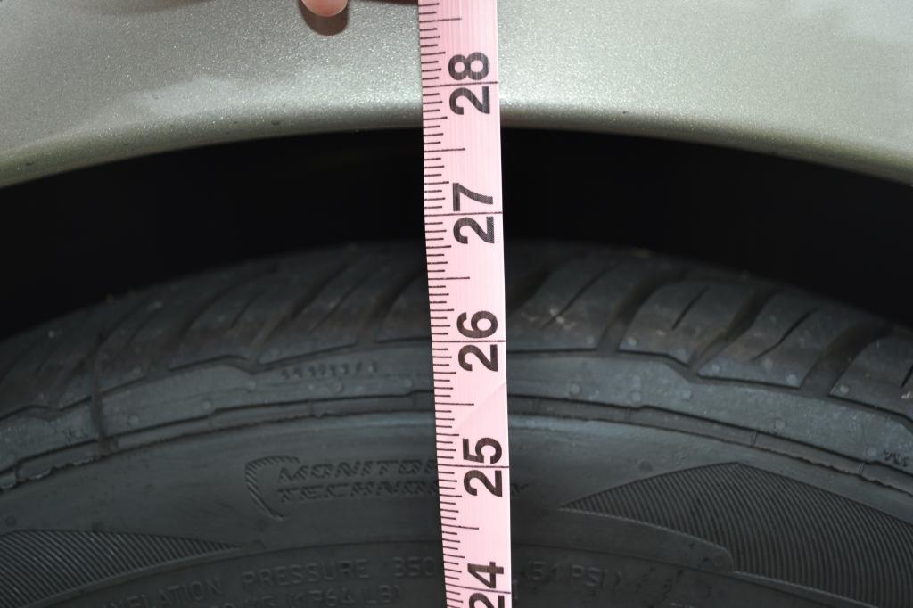

Here's some obligatory pics to show what I'm talking about. It's a terrible picture, I'll admit, but it's the only one I have where you can see the sag at all. I'll take a better pic in the morning.
Thanks in advance to anyone willing to help me lol.
Here's the gap in the front:
And here is the rear gap:

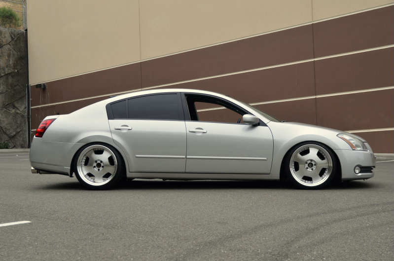

I don't think your car is actually sagging in the rear. What you are seeing is just the height difference between the front and rear wheel openings, it's just more obvious when you lower the car. Like most cars, the front wheel opening is taller than the rear, so if you lowered the front and rear the same amount the rear wheel would reach the fender first. Like you've already seen, if you try to make the wheel gap even front to rear, you will have a raked look. I initially had even gap and you can really see how that causes rake.
