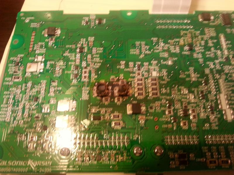

Hey guys , do anybody know if the ac/heater climate control amplifier needs to be reprogrammed if it has been replace?

well i found out the amplifier don't need to be reprogram ,I found one around the same year and it work fine.... all dash instruments are work and a/c....the burn amplifier was causing the code U1000..... Everything fix and well....just want to pass the info on.....
