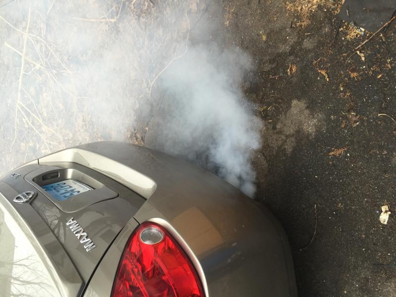

Here is a pic of it smoking! Maybe the car just needs to be run hard since it sat for a long time. Looking for advise

I'm telling you it the valve cover. There are seals inside that are for the spark plug tubes.

Thanks, Im gonna do valve cover gaskets on both banks and also run a catch can to start with. It's hard to tell how the car is acting because I did't register it yet also. Thanks
