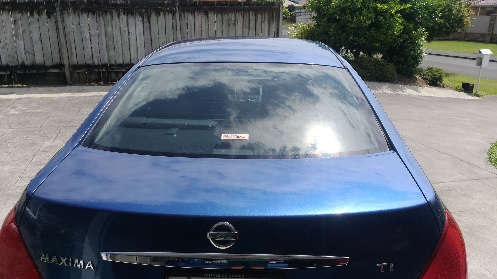

Old Dec 25, 2019 | 02:31 PM
StevenHwa's Avatar
Joined: Dec 2019
I got this in Auckland NZ
Maxima ti-j31? Never heard of it. The models are SE and SL. Where are you getting this ti-j31 from?
everything about this car is still good, only the high mounted third break light is malfunction.
owner's manual doesn't mention how to open it, even I bought E-manuel from internet, no information either. I have LED and electronic knowledge basically, If I can take apart of it then I can fix by myself
The back of backseat is not foldable, above the third brake light, there is a cover, Does any one know how to do it? Thanks in advance
Merry Christmas and happy new year
Cheers Steven Has
