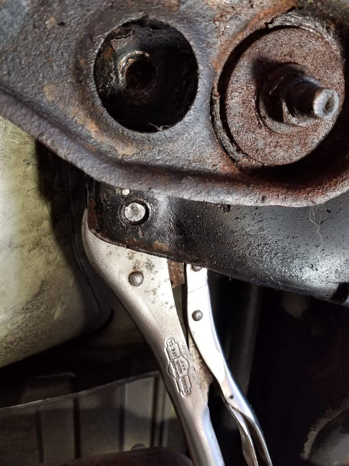

The threaded portion of the bolt is stuck in the suspension member above the control arm with half an inch sticking above I can grab with vise grips.

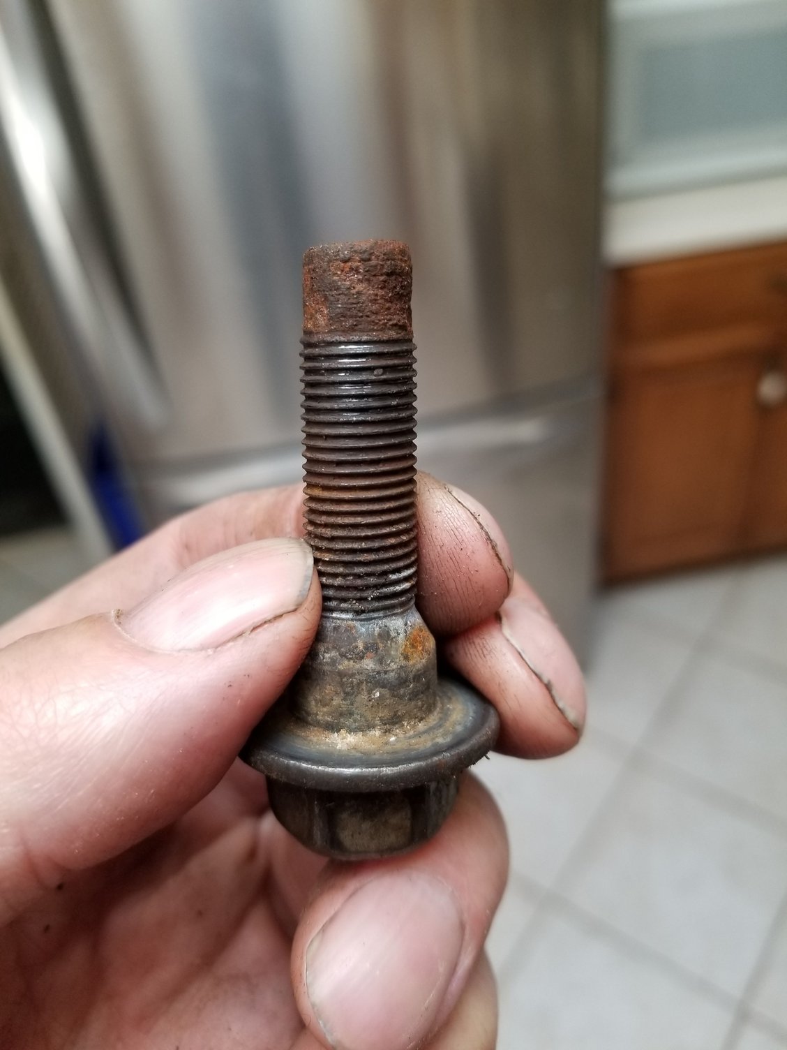

The bolt is broken where my finger nail is. The portion above is inside the suspension member with the half inch unthreaded portion sticking above for vice grips.

Ok cool. Doesn't look that bad. You need to drill a series of holes through the bolt shaft. I would start small and drill in three steps/increasingly larger bits. This will relieve tension on the bolt. Get a nice big extractor and go from there. Get a good, sharp (sharp is key) punch to start your pilot hole. Sucks working upside down but I don't know of any other way to attack this.

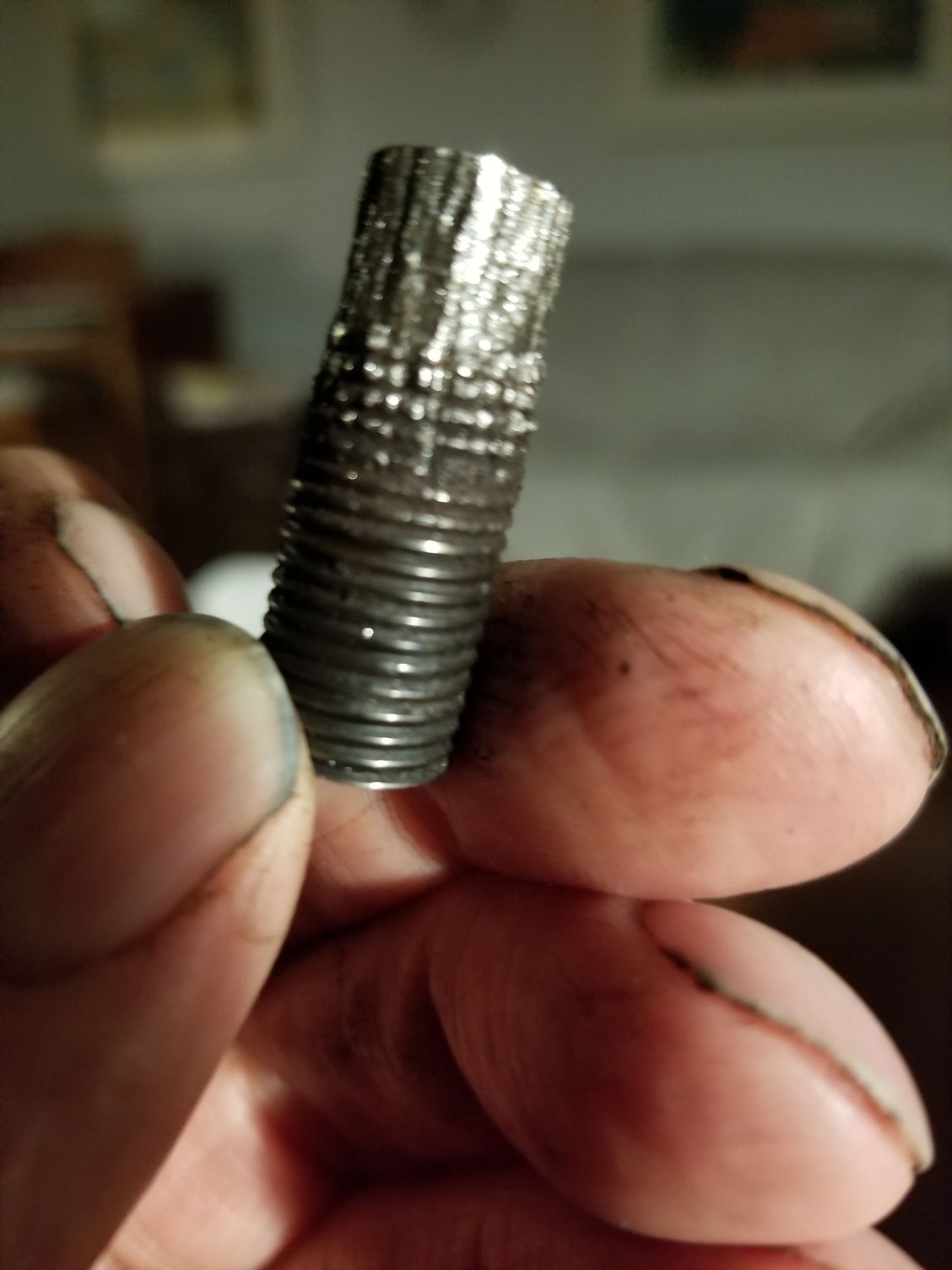

Bolt extracted from top of suspension member. Using vice grips. Bottom grinded down first to remove any damaged threads. Mission accomplished.
