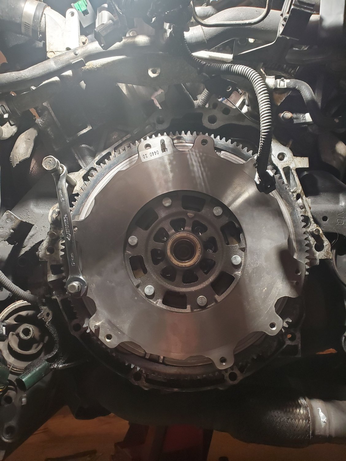

Quick update! I checked the ignition condenser and it tested good. So I tightened everything every plug again and decide to disconnect the crank position sensor and cranked it, after a couple of times it started but not smooth and it threw a p0335 for the cps. The funny thing is that I plugged it back in while it was on and as soon as I cleared the code the engine shut off and it won't start again until I remove the plug for the cps again. Could it be a timing issue?

Yeah. you ****\ed up your flywheel.

Here, try this:
https://www.youtube.com/watch?v=Cgrxgp2Jp94
Yeah Fu@#$d up pretty bad. I already started to take it apart again! Got to drop the Fu@#!%g subframe again!!! I believed that I put it in right but who knows I guess I'll find out tomorrow. Thanks for the vid🤣😂
It's that arrow right? That points where the dowel pin is at?

Old Jun 22, 2020 | 03:57 PM
User1's Avatar
Joined: Jun 2018
Posts: 2,493
But that arrow makes perfect sense. Is that where it was lined up before?
Old Jun 22, 2020 | 04:12 PM
gamaliel2612's Avatar
Joined: Mar 2020
Posts: 39
By before you mean the original? If that, I'm not really sure, it took me so long to put the tanny back together that I forgotwhere everything was supposed to be. But Im here right now and about to pull it out, we'll see shortly! But the FSM only mentions the dowel pin not the arrow though!

There will probably be a detent on the backside of the flywheel were the dowel pin inserts.

Mannnn just pulled it out and the dowel pin was in the correct place, but the timing ring on the flyweel is bent and I don't know if its from shipping or me prying it out now. But anyway it don't matter now right? If I straighten this one and put it in it might not work or be unbalanced right?
Old Jun 22, 2020 | 05:04 PM
User1's Avatar
Joined: Jun 2018
Posts: 2,493
How bad is it? It needs to be straight. It does matter.
Old Jun 22, 2020 | 05:08 PM
Joined: Mar 2020
Posts: 39
I got it straight but not perfect. Its still slightly but not as it was.
Old Jun 22, 2020 | 05:11 PM
User1's Avatar
Joined: Jun 2018
Posts: 2,493
Hmmm I don't know man. I would do the best I could to get it as straight as possible. Can you try running the engine without the tranny attached?
