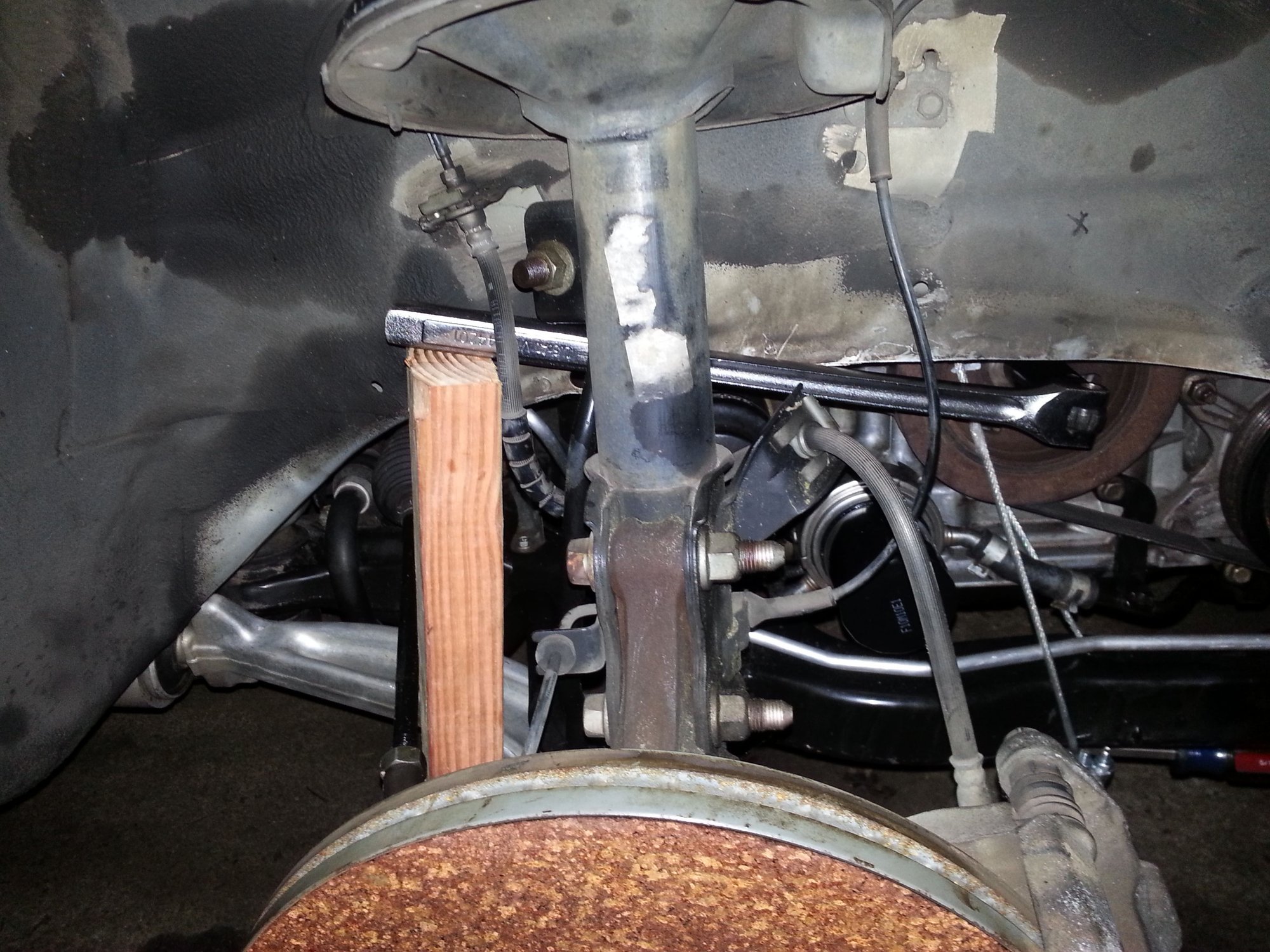

$7.00 Home depot. Comes with the clamps
Spare scissor jack under the 2x4. Jack with caution. When the hands on the clock stop moving easily you should stop. 70 to 80 degrees in my case.
