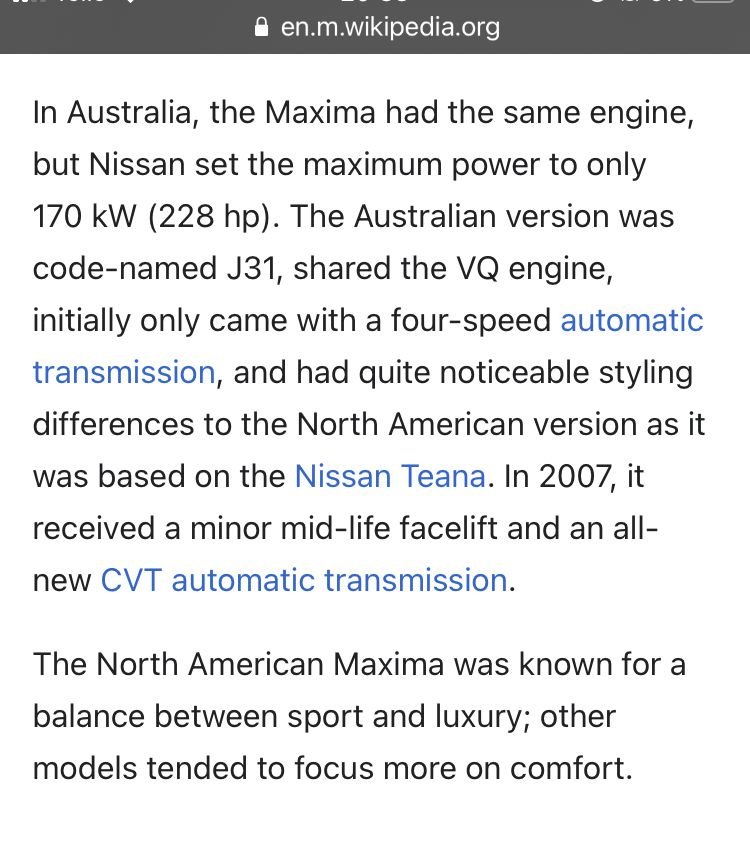

Based on this info from Wikipedia, you could probably get away with using a Teana or US Maxima ECU.
Youll want to verify connectors and the wiring pinout is the same, and the NATS system will need to be reprogrammed.
Or you could look into having your stock ECU tuned with uprev if its compatible.
