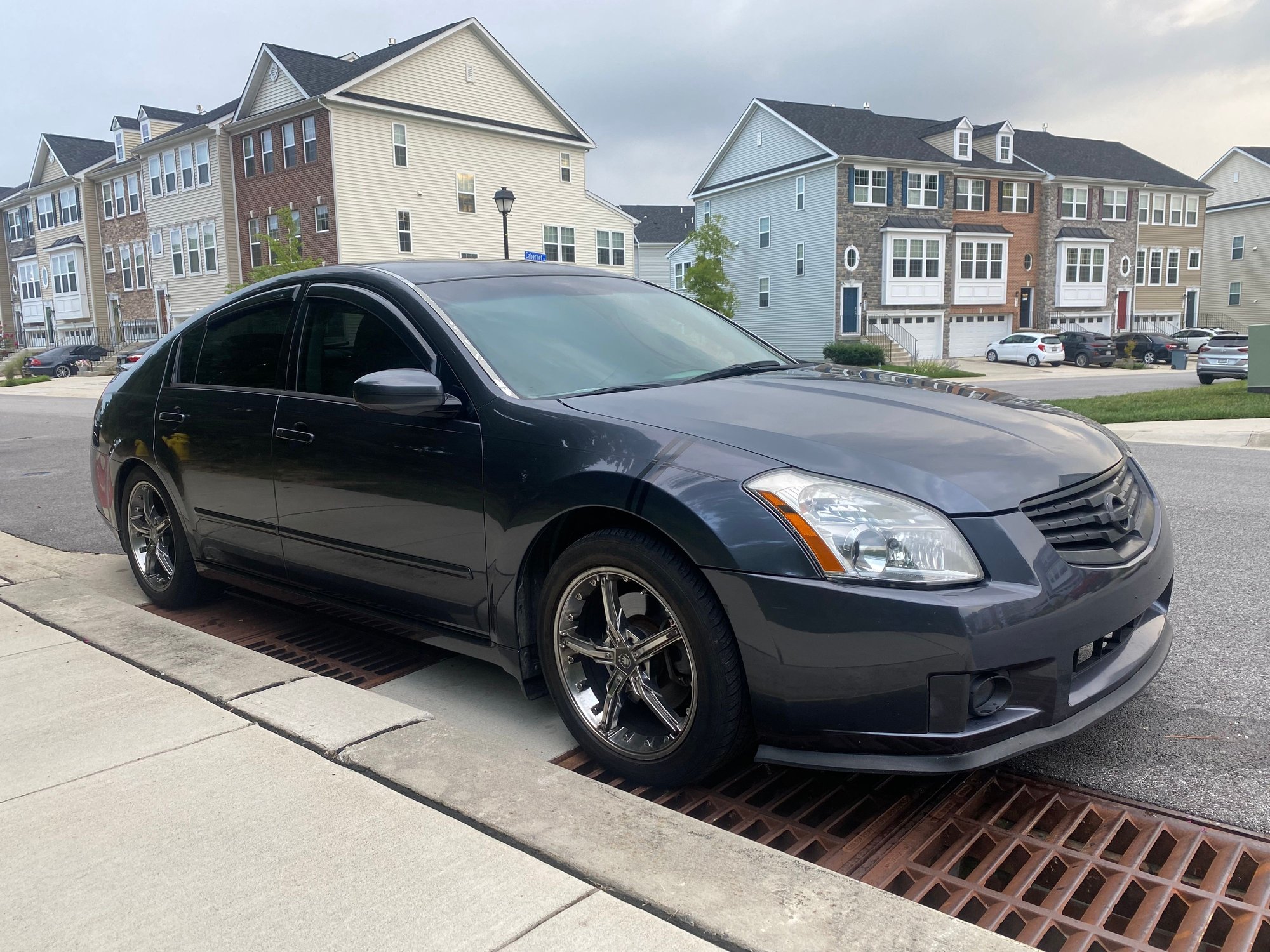

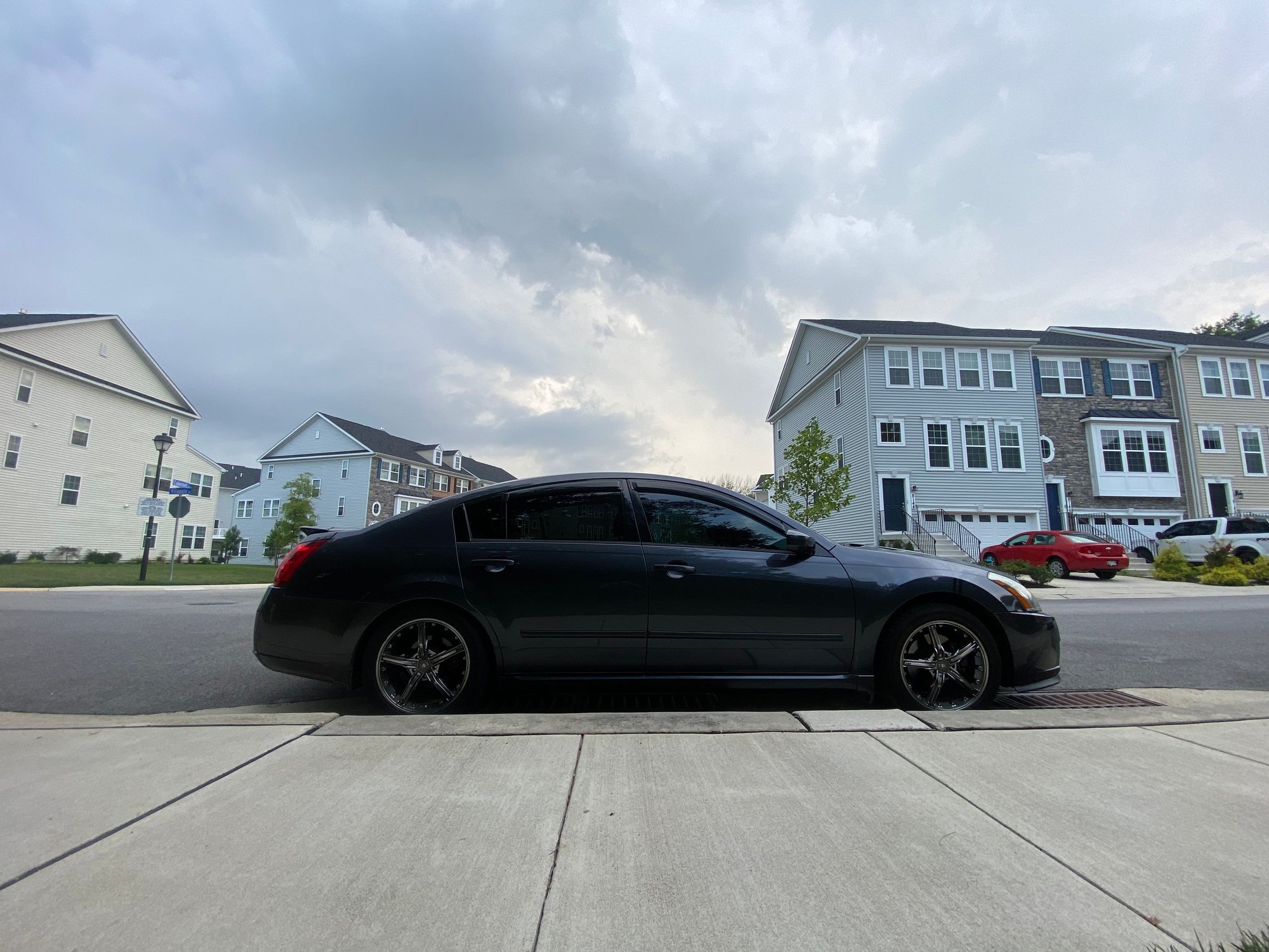

Car looks great for an 08. My 07 is becoming a rust bucket...

Here she is!

Lookin' good!
