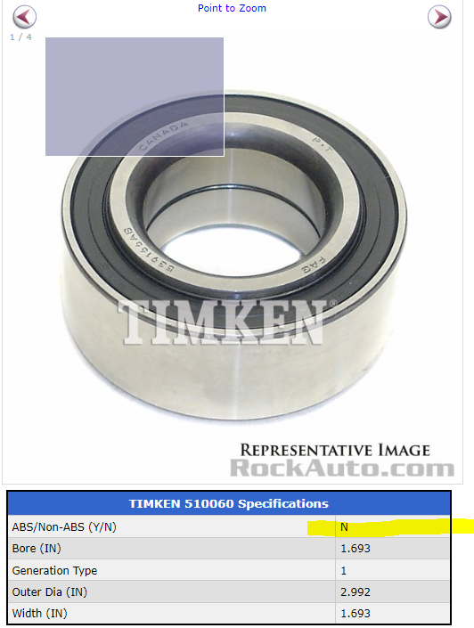

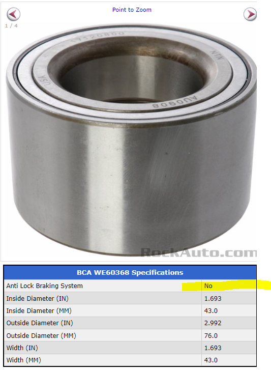

My car is maxima 08 and rolled 160k so far. Changed front wheel bearing with hub last year and drove around 10k or so since. However recently i suspect they are going bad ( purchased from amazon Durgo brand, no wonder they are grinding now ) as the noise it makes at high way speed and wear down my tire unevenly forced me to get new tires, severe shaking at speed over 60 mph. Changing tire helped with the pulsation but noise and howling is getting worse at high way speed. Now i dont want to make same mistake hence buying quality parts and found my best bet is either Timken , national , bca ( i believe they are NTN and nissan original replacement is same bearing ), Also SKF or NSK won't fail prematurely . As i going through the info in rock auto, it always shows these following bearings don't have abs signaling.
TIMKEN, BCA, SKF, NSK . Only national which has same model name as Timken state in the info that they might have abs when applicable. So now im really puzzled as i wanted to buy timken or bca i cant be sure if i will end up with abs malfunction or complete absence of ABS assist in braking which is of course a dire safety issue. But then again why they would say it is compatible with my vehicle 2008 maxima if they never have abs signaling in bearing ?
Please can someone help me to choose the right bearing and confirm no issue with abs would arise. Thank you in advance.
says no abs
same says no abs

I have Timken Part# 510060 front wheel bearings in my 2007 Maxima. They are excellent. The front wheel bearings on 2000-2008 Maximas (Press in) do not have ABS sensors built into the bearing assembly . Nissan used a separate sensor rotor that is mounted to the axle directly behind the knuckle assembly. The good news with no internal sensor you cant install them backwards.
