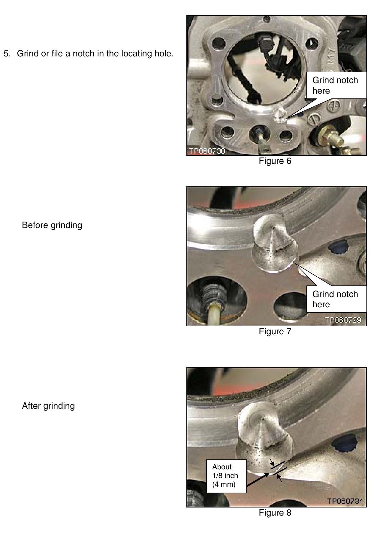

Okay...suspect you issue has to do with the ABS and the winter weather. I have gone through that issue. On some 07s, due to which manufacture Nissan sourced your car's rear knuckles from at that point in the year, moisture gets behind the rear hubs and does not drain properly. This takes time. I owned my car 5 years before it started acting up.
So, when the moisture freezes in the rear knuckles, it affects the ABS. When that happens, the car will not go out of CVT's 1st gear because the ABS is engaging, though there are no lights on the dash.
The "sniff" test is the leave the car in a heated garage for the night and then take it out for a drive. If it works fine, then it is mostly likely the rear ABS system being influenced by frozen moisture in the rear knuckles.
I went through this. My car (07) sat at the Dealership for four weeks, they replaced the CVT, and no change. This is not common, as I have alluded to, because the rear knuckles that were sourced by Nissan at the time of production for my car have this design flaw. Maybe that is your issue as well. Considering you have an 07, I would rule it out before messing with the CVT.
I have attached the TSB.

This is the fix...crazy.
I went through this. My car (07) sat at the Dealership for four weeks, they replaced the CVT, and no change. This is not common, as I have alluded to, because the rear knuckles that were sourced by Nissan at the time production for my car have this design flaw. Maybe that is your issue as well. Considering you have an 07, I would rule it out before messing with the CVT.
Ok that makes sense, I have an failing wheel bearing on the rear drivers side aswell, its making noise. I’ll definitely look into that!

The rear wheel bearings finally arrived in the mail and I’m getting the put on tomorrow. So to fix this abs issue, I basically just clean the sensor and knuckles? Need to know what to tell the mechanic thats doing the work, thanks.
I'll get the TSB. Email, or give, that to the tech.

Thanks, I’ll be sure to tell him to grind the knotch in the hole while doing this job.
