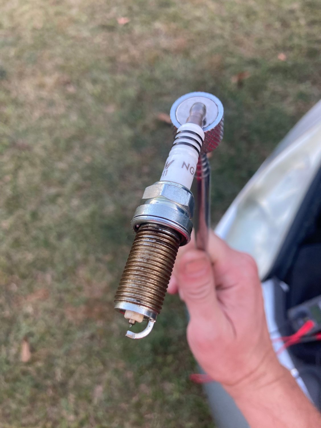

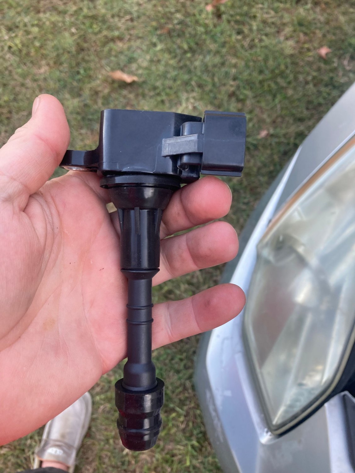

From: Jasper, AL
plug still looks brand new and I don’t see any markings or burns on the coil. That also looks brand new.
