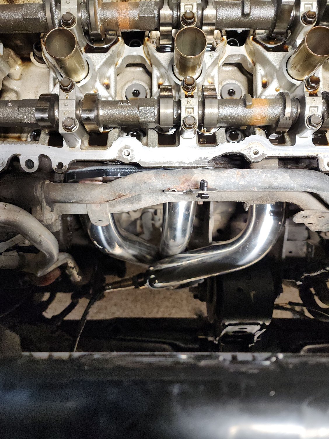

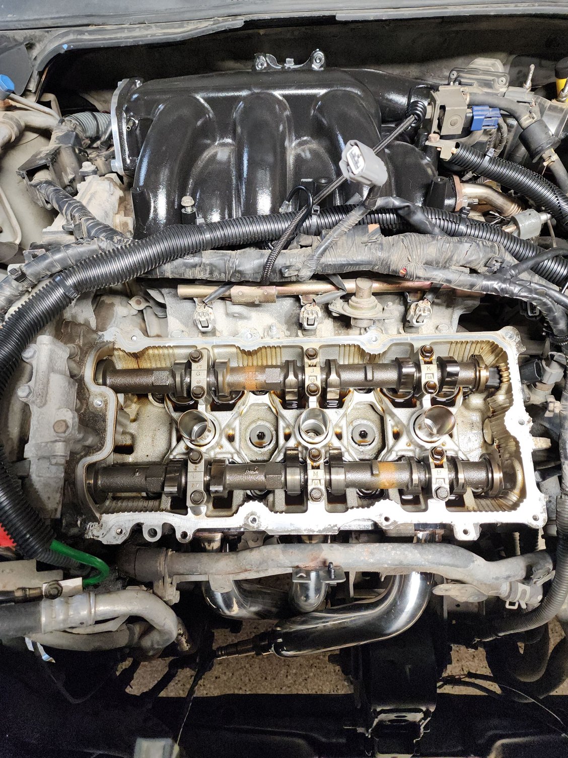

Front header installed, o2 installed bank 2, preping valve cover for RVT and reinstall.

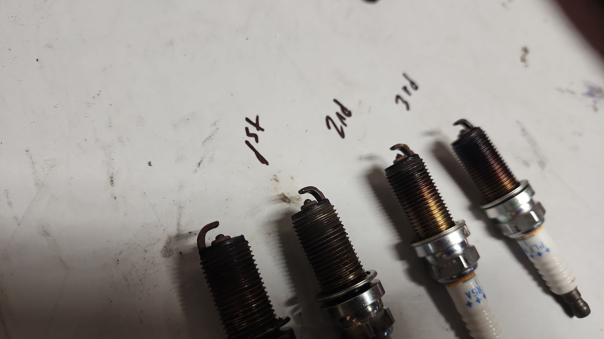

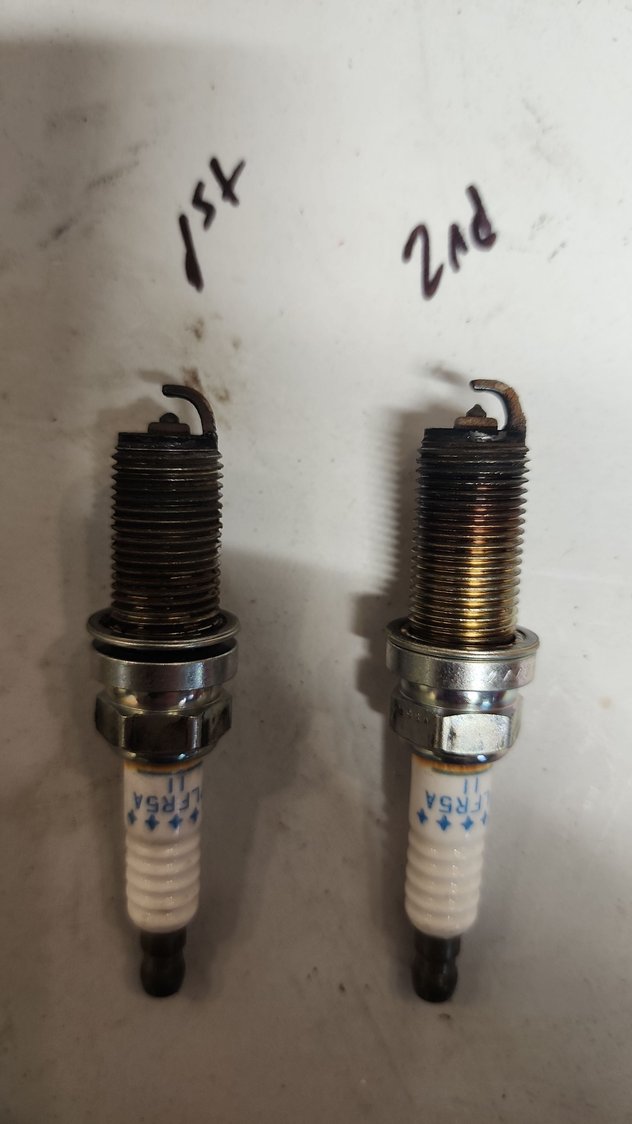

Found bad plugs in front
Bad plugs in back

Finished valve cover install with rvt seal
