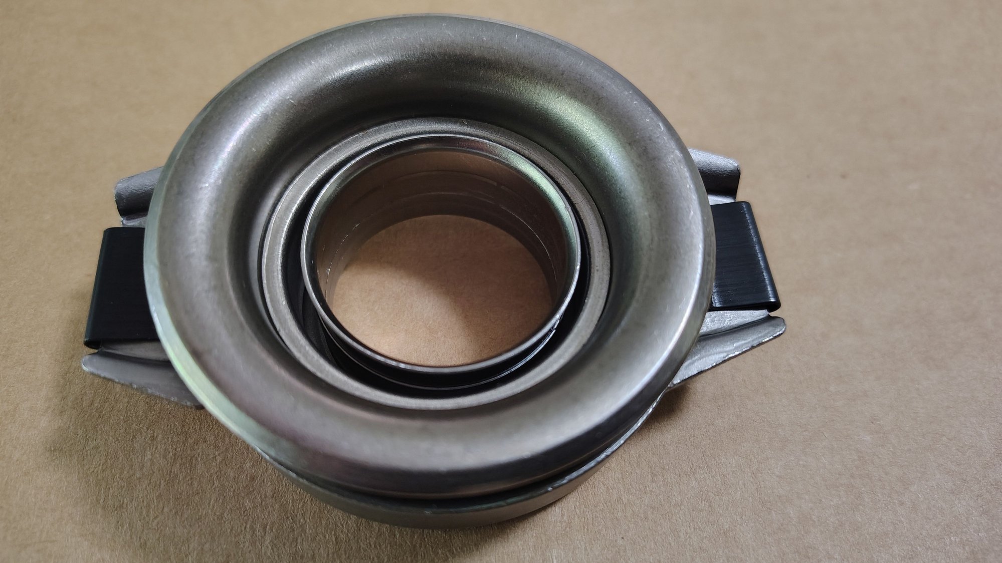

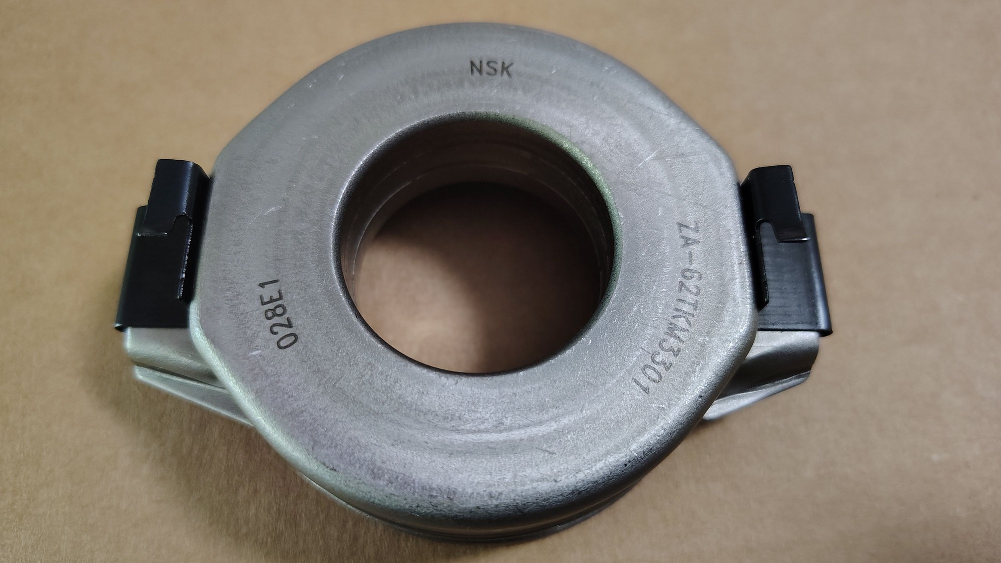

yup I know that all to well. mine went out a month after i got my Max back in December of 2012 and 2 more times over the years. usually when they go bad it's from the plastic sleeve getting damaged and the throw out bearing goes out of alignment. I just recently found full metal T.O.B. that fits 85-06 maximas (NSK 62TKM3301). I found it on Rockauto. also make sure to lube the correct points on the T.O.B. plus clean the and lube the collar around the input shaft of the transmission.
NSK 62TKM3301
